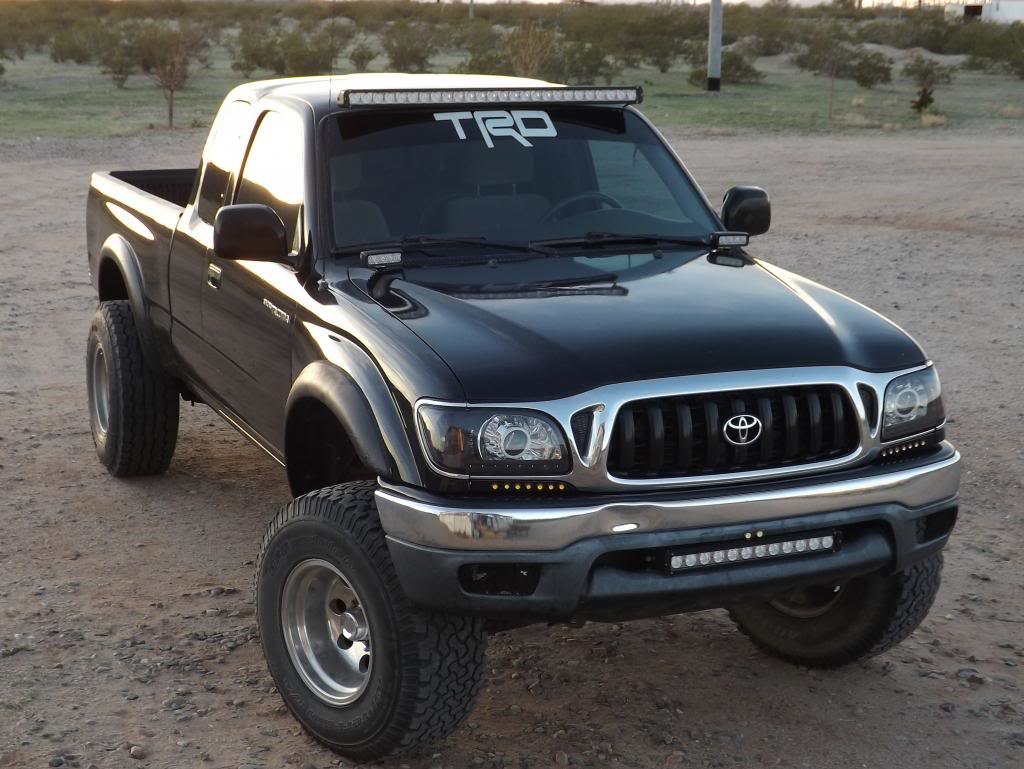

    I have these. Have had 3 sets actually. They are not very good at all. My first set was not sealed properly. Second set didn't hold up to a retro very well. Still waiting to do my new set. Purchased the third set a while ago now and just haven't got around to doing it. I'm determined to get it perfect next time. Also plan to be more careful on the splitting process as to not bake them as hot/long. As I think the internal plastics are lesser quality and may have been affected when I baked it. The reflector bowls on both sides are now popped loose a lil and rattle around a bit. But the projector alignment is still acceptable. Part of this was also due to offroading, as well as driving down a really rough dirt road everyday to/from home. All the vibration must notve been good for em.
    But besides the retrofit issues, there's others such as a crappy clear coat. They hazed in one summer here in az. As well as the trim cracking.
    I plan to be extra careful with my new set. And clear coat the whole thing better. And add uv protection. If they don't last I'll definitely be done and go back to the two piece units.

    I mean, they are sick looking... Especially with a retrofit.. That's why I bought my third set. To hopefully get it done right this time with no issues. I'm gonna try and be extra careful when baking it. And try clear coating the lens as well as the trim. And see how long they hold up. I've had my new set sitting in storage ALSO with new projectors, for at least a year now. Not that I haven't had time but also because I'm anxious to do it. If you're feeling lucky, then go for it. But if you would rather risk it then stay away. Stick with decent two piece units.

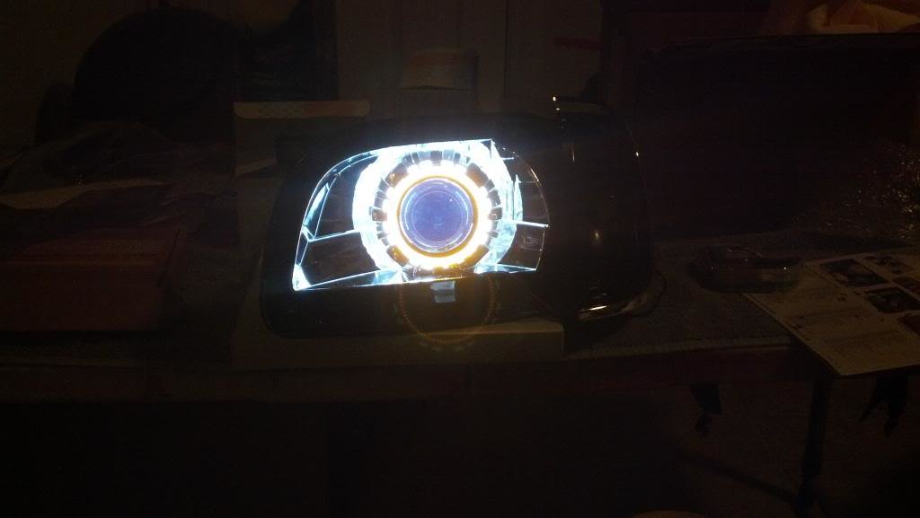

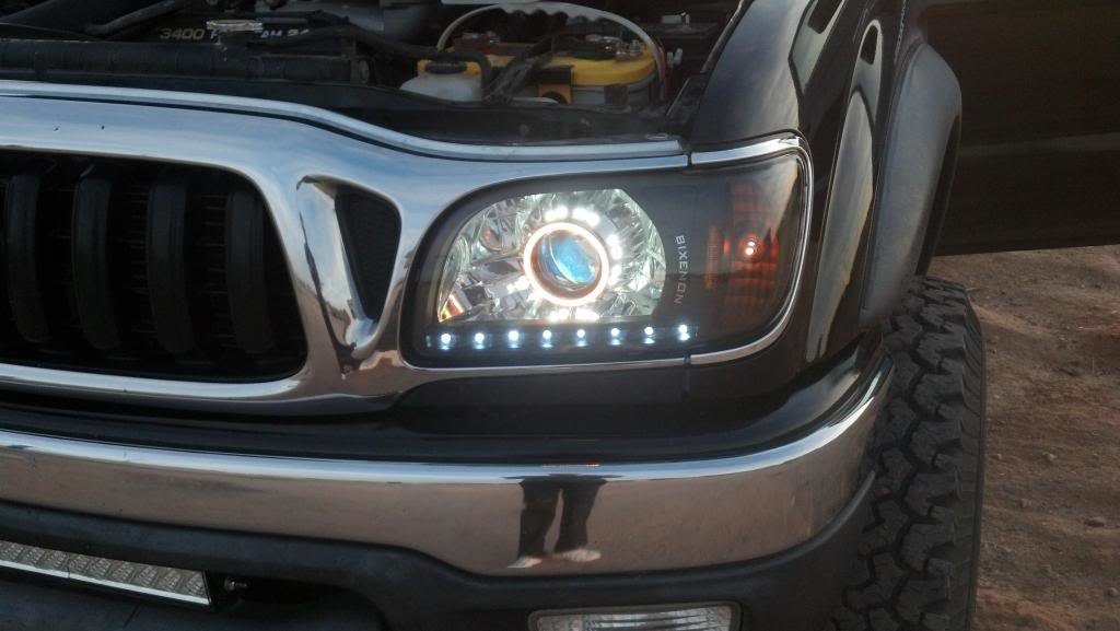

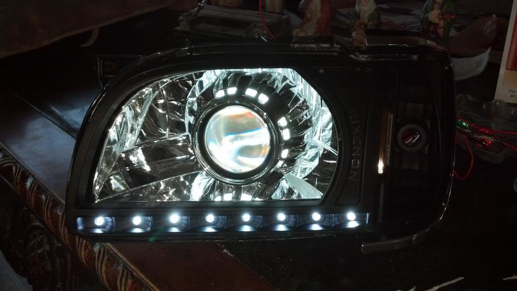

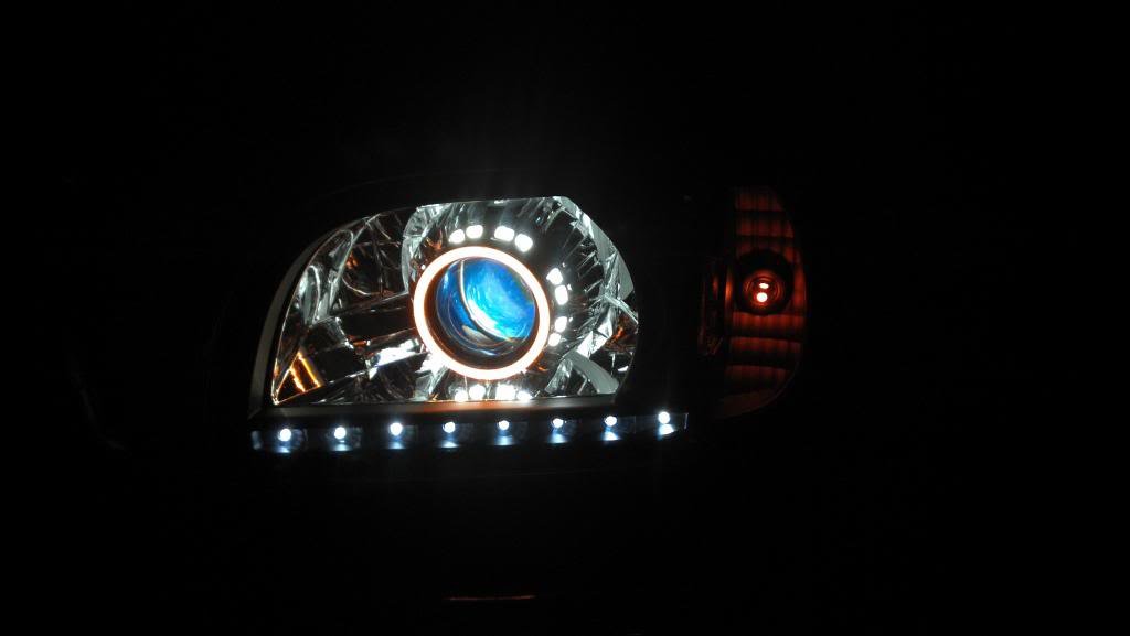

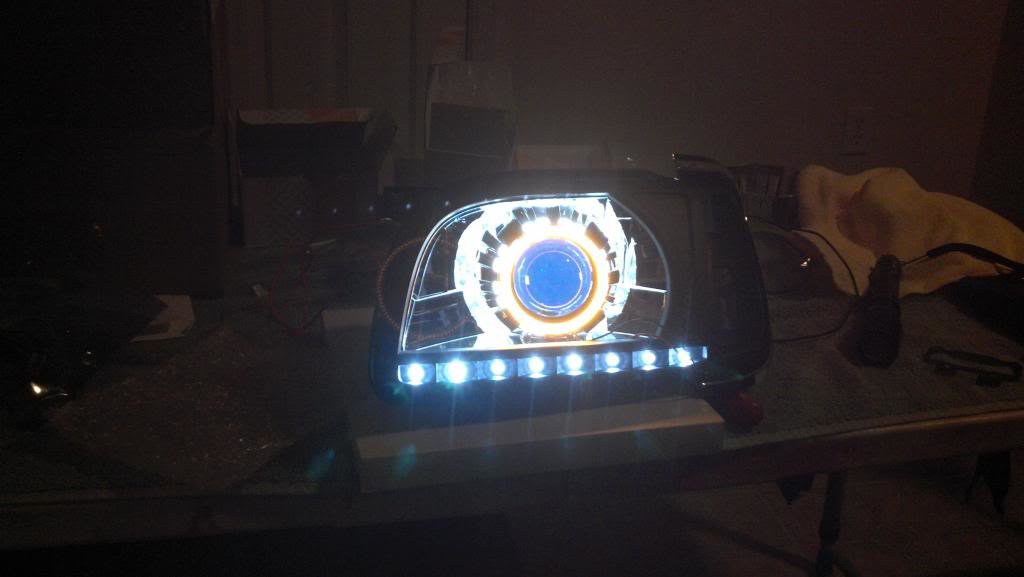

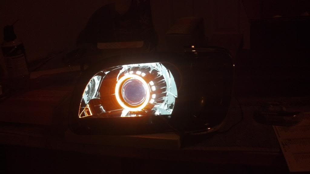

    Here's some shots when I was doing mine.
    Ccfls inside with the led dtrls:
    Ccfls and led halos with dtrls disabled:
    Ccfls,led halos, dtrls, and metallic blue passive demon eye (ccfls helped light up the demon eye)
    Dusk shot:
    Passive daytime shot
