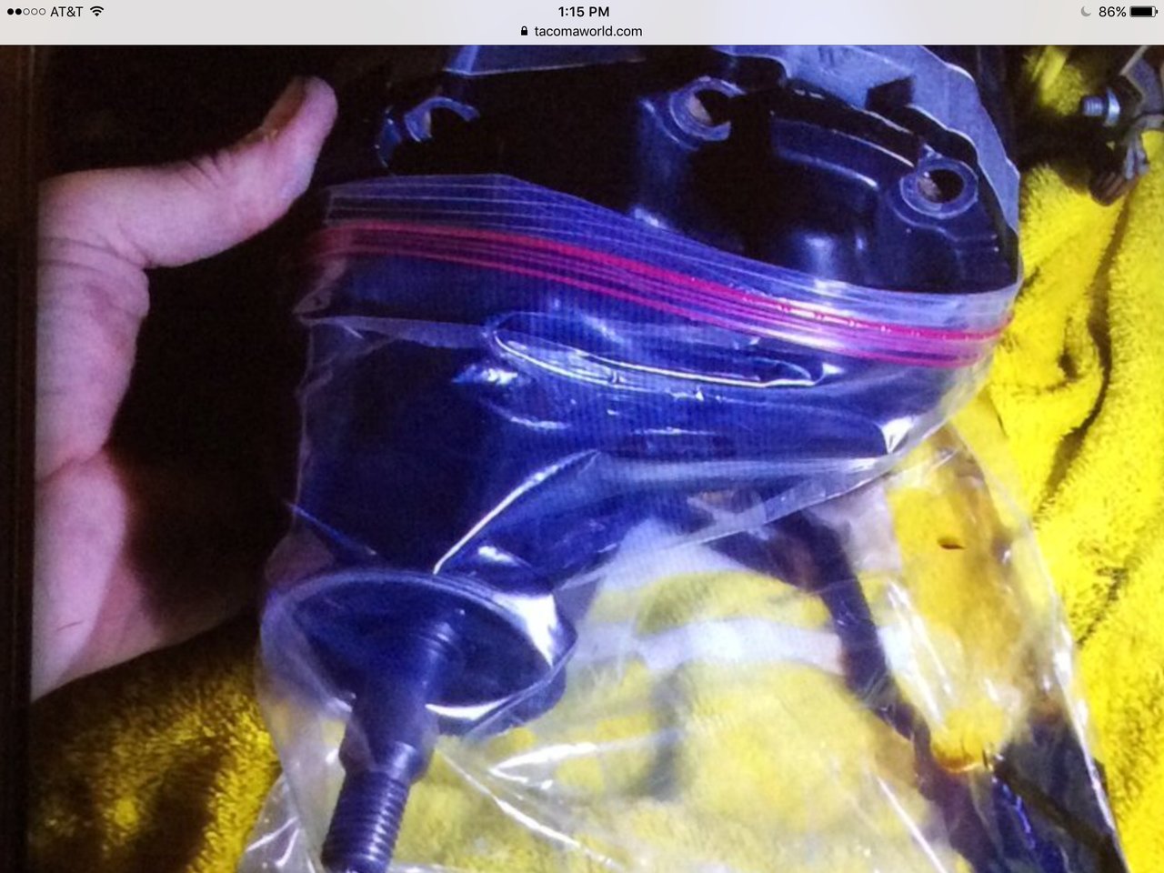

    If you want the bearing to last, change the oil every 25,000 miles. Yes the bearing will go longer but just like your engine oil you can change it at 10,000 miles or at 3000 miles and it will still run. If your running a smaller pulley, more boost than you need to change it sooner because of added heat and higher supercharger rpms.
    You have 3 choices
    1) remove supercharger from engine takes 2.5 hours removing and replacing.
    2) you can just remove the supercharger snout while the supercharger is still on the engine
    Just get a large zip lock bag to catch the old oil when you remove the snout bolts, takes an hour and a half remove and replace as you need to clean gasket areas with a razor.
    3) the 3rd way would be the choice to go, but you need to remove the snout

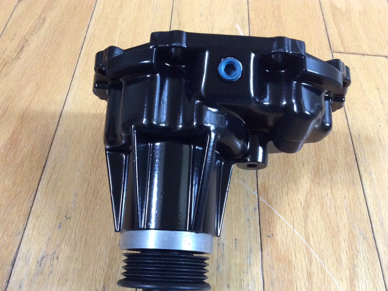

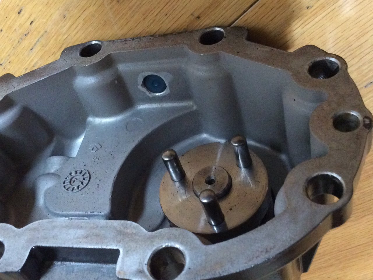

    Photos for the butt screw as shown and you can see from the back
    it's a directly lined up with the center bottom for removing the oil,
    5 minute oil change and your done!!!!!
