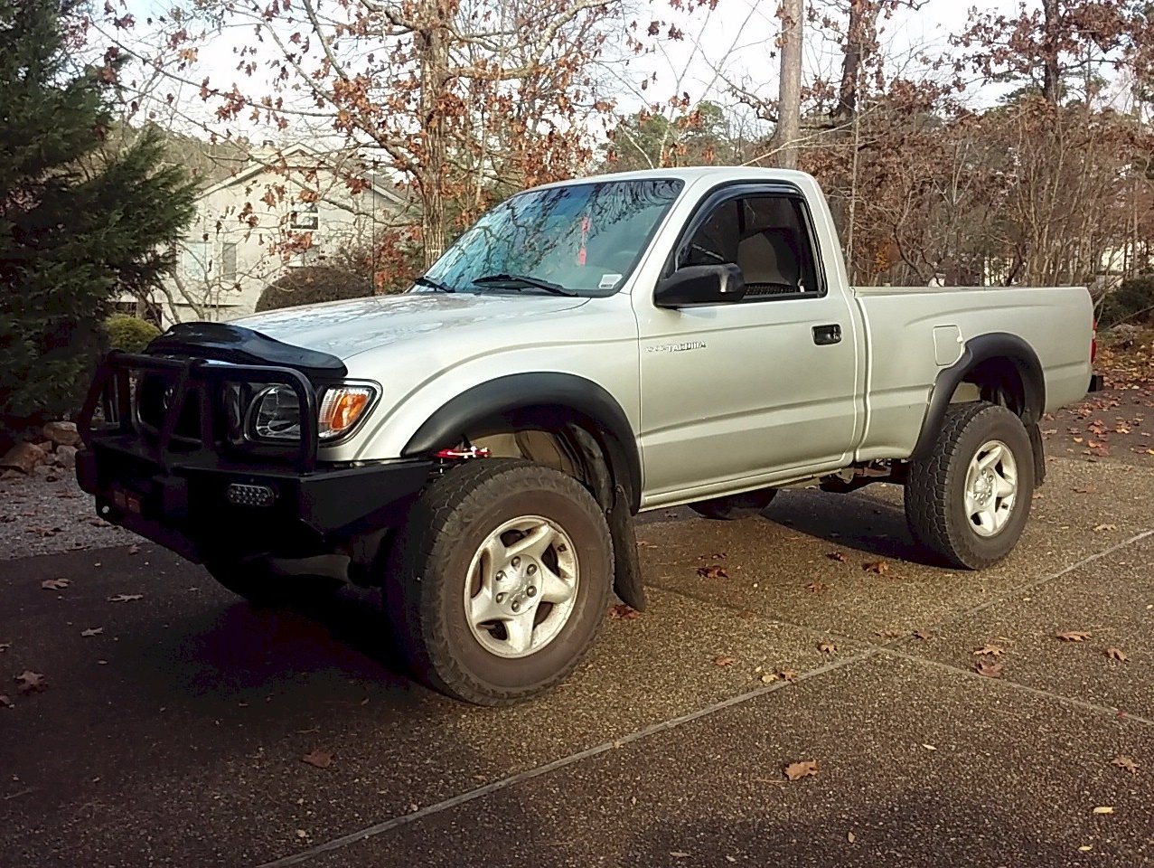

    2003 Std Cab 2.7L 4x4 & 2024 Off Road
    Bilstein 5100s, Deaver Leaf Springs, JBA UCAs on 2003 King 2.5 shocks front and rear on Off Road
    Bilstein 5100 front and rear with OME front 881 springs and an AAL in back. With JBA UCAs
