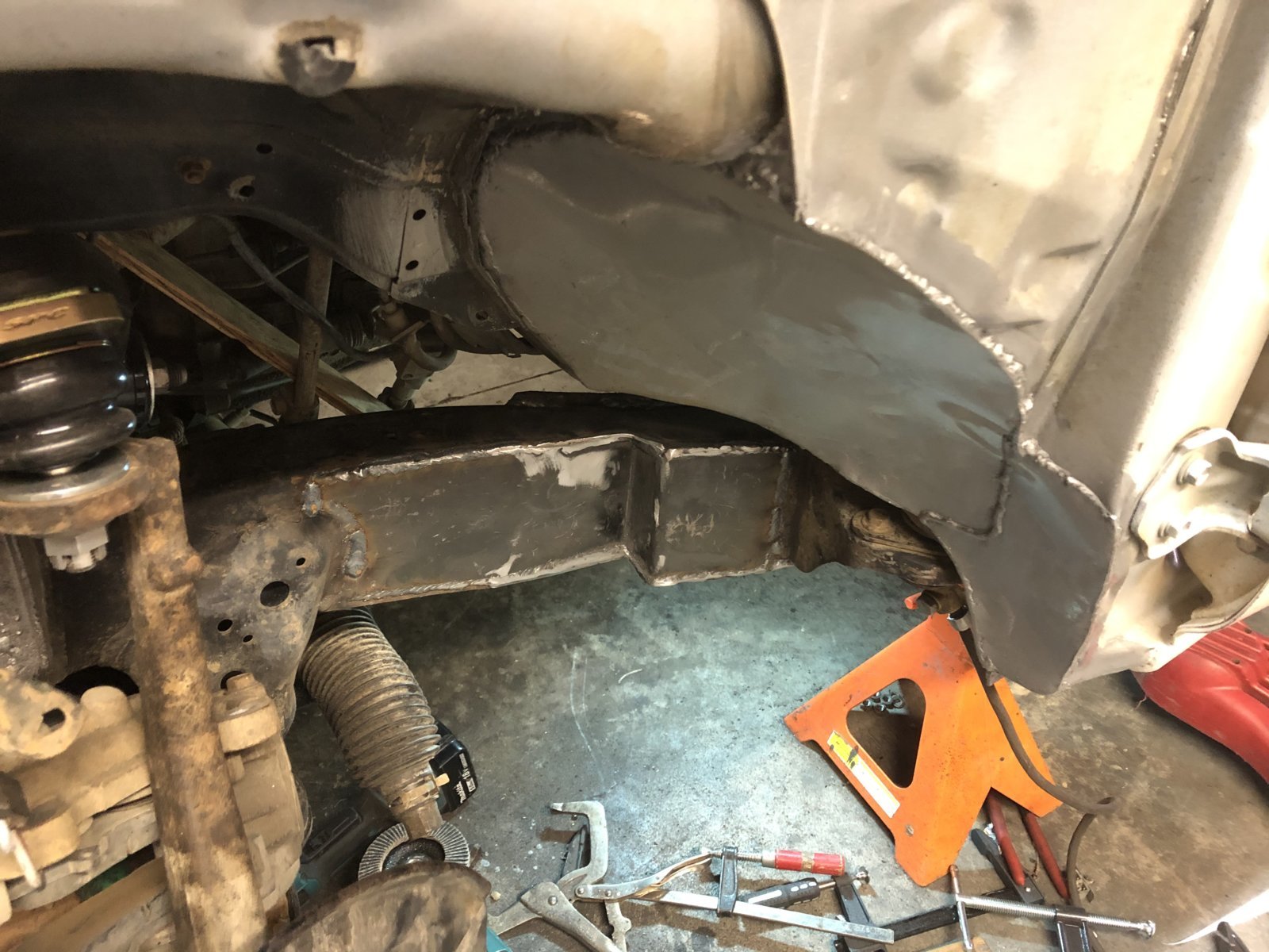

    To do it right, i.e. get full suspension travel with correct alignment and no rubbing, yes you will need to tub the firewall, weld in a new firewall plate, and cut fenders and flares.
    With low enough backspacing, usually 3” or less, with offset wheels and/or wheel spacers, you can avoid rubbing the frame at full steering lock. The lower the backspacing, the more you have to cut out of the firewall however.
    Lots of info here:
    https://www.tacomaworld.com/threads/fitting-35s-on-3-suspension-lift.307596/
