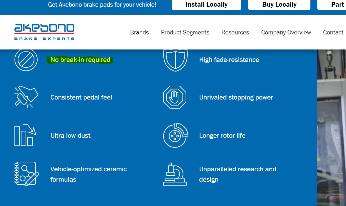

    Thats crazy.....nobody replaces the rotors every time with the pads....thats just crazy.....
    unless you did the grinding metal for a while....
    NAPA Premium Front Brake Rotor NB 4886566 | Buy Online - NAPA Auto Parts (napaonline.com)
    With the napas being $64 with the 20 off.....would not make since to turn old ones that were thin to do so in the first place......
    On modern imports....nobody turns rotors anymore.....there's not enough material.....
    The 6lug napa rotors are $60 with the discount.......
    Proformer Brake Rotor PFR 24886575 | Buy Online - NAPA Auto Parts (napaonline.com)
    I would be careful of the power stops.....every other week there's a bad story on them here....

    I think turning rotors is a scam......if your a big enough idiot to grove your rotors....
    maybe you shouldnt even be driving.......maybe a bicycle with a rim brake would be your speed.....
    If you inherit a truck a truck with slight glooves.....I wouldnt sweat it.......groves just increase surface contact...
    unless your a lead foot......cause then your gonna have numerous over heating and tranny problems anyway.....
    I would only replaced them if they were warped....
    Use of the akebono pads should bring the wear to almost zero.....
    thats the reason those pads are bad ass.......
