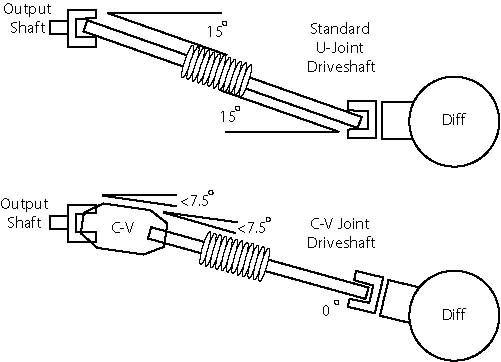

    When I say acceptable shaft angles I mean the angle relative to horizontal:
    267802d1426603093-how-crucial-pinion-ang_d8e5b93b6d2793ac41ba35e7a2b338504a0c06e1.jpg
    I know with single cardan both the Tcase and pinion flange need to be within 1-3* (even though this changes as the suspension cycles), but I was worried about the angle of the shaft itself (above) being too extreme for the u joints. I'm hoping to stick with the first scenario rather than build a CV because as you said, god damn are they ever dxpenexpe .

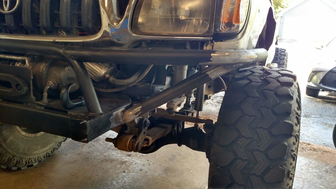

    Yup no one has done it:
    Works great, no brake drive or weird handling, flexes awesome offroad. I have to drive it 8hrs to anywhere good to wheel and I dont have a trailer, so highway handling was a priority for me as well. The stock IFS shaft bolted right up with no mods. I never run 4wd on the highway so I didnt care about the angles so much, but the flanges are parallel. I would run it forward shackle, you can build it nice and low and you dont have to worry about the axle trying to walk out from under the truck when hill climbing.

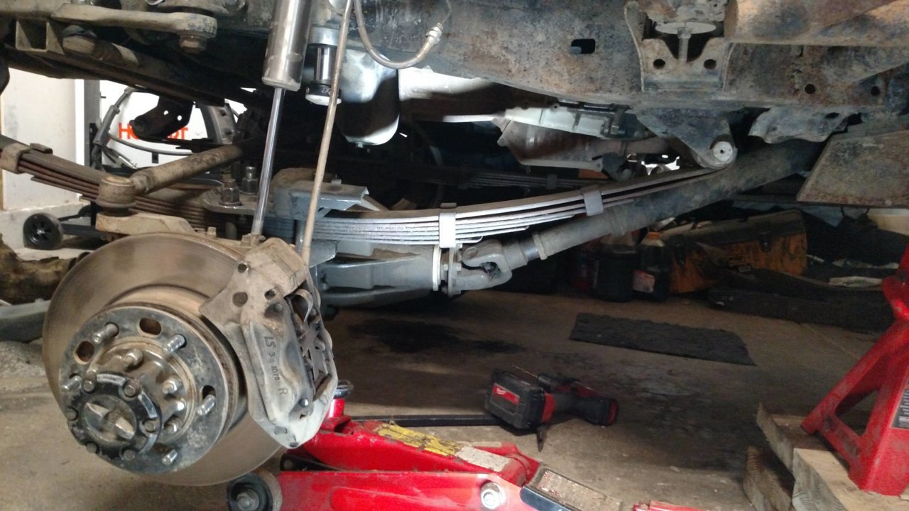

    Pic of the angles I'm running, not the best for rocks but I haven really hit it on anything yet. This is drooped out obviously.

    You can use a toyota to 1310 conversion u joint...also looks like you need a shorter shaft it's kind of close to the yoke end
  8. Aug 27, 2020 at 11:25 AM
    slander
    slander Honorary Crawl Boi
    May 10, 2013
    #103909
    8,964
    Hickory, NC
    02 Tacoma, fixed with curse words.
    Were you referencing me? If so with the way my suspension is designed, my driveshaft only slips about an inch. I have right under 2" of uptravel, so it's all droop and works great.
