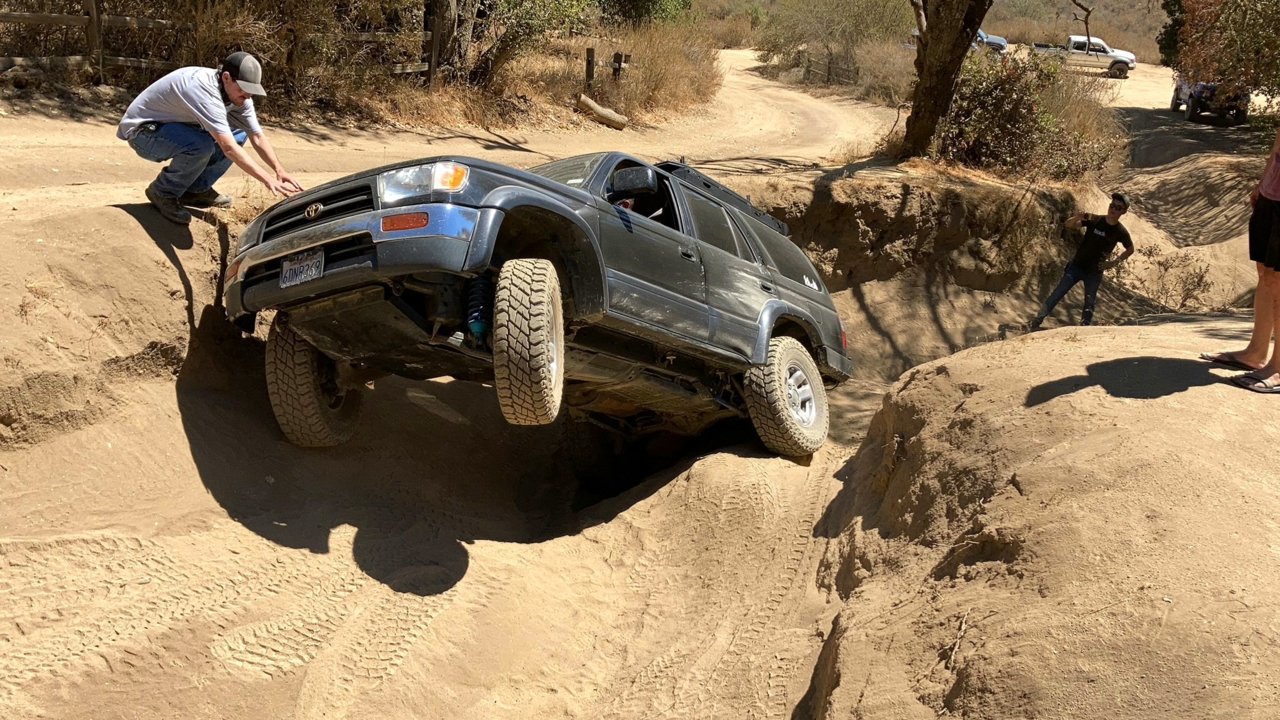

    I know there is custom work to be done to do it. I have ome el122ra +2” leafs with omegs12 shackles on the back with bilstein 5100 long travel shocks. I have looked at a 3rd gen 4Runner running ome 891 coils and 5160 long travel shocks with the Panhard correction kit welded on. Quick Disconnect sway bar links.And it gets more articulation travel than my set up with the leaf springs. Yes some will say the little bit more travel is not worth the work to get it. But I will have to say the four link with coil overs on the third GEN four runner is a better ride on a rough roads than the leaf springs.

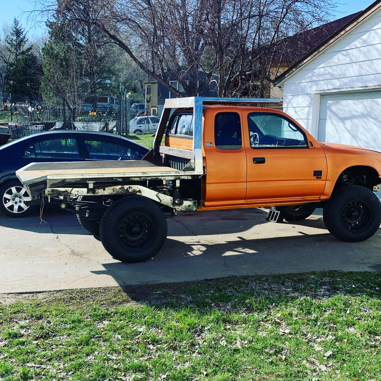

    This is the rig I’m working on
