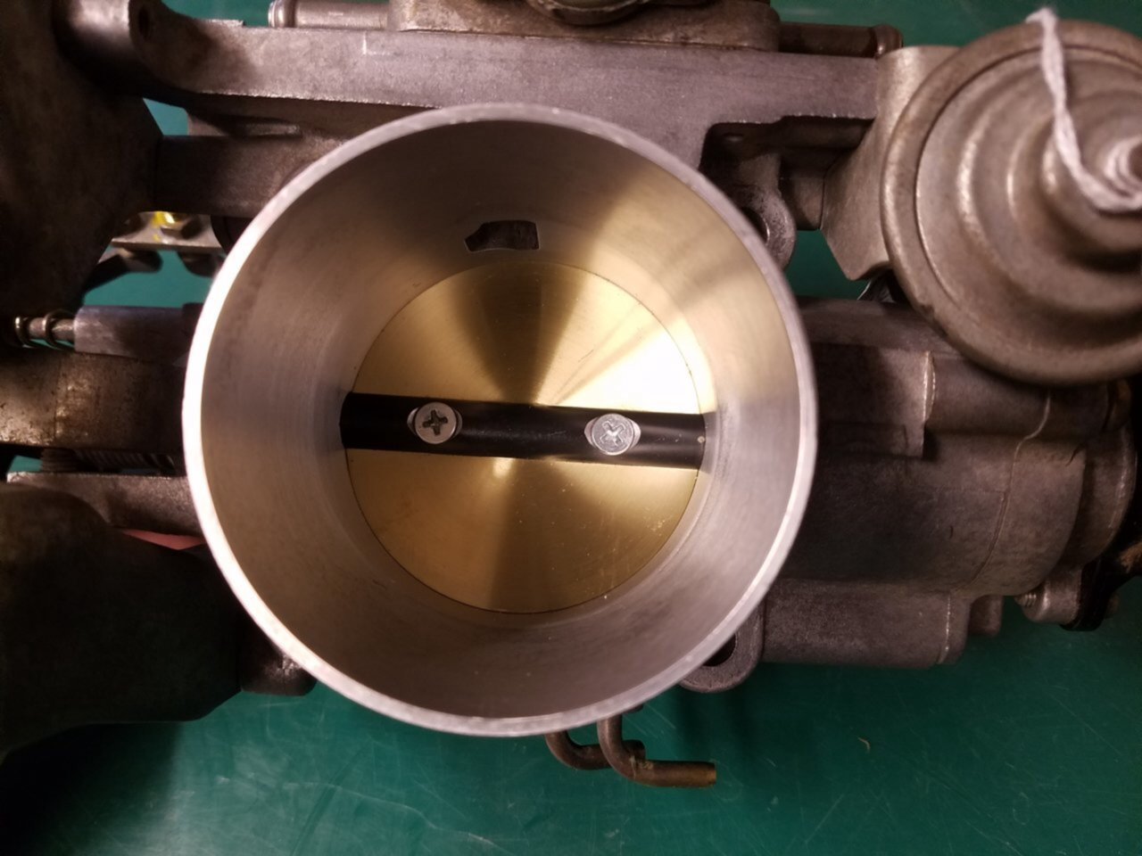

    Just curious any chance this is caused from the butterfly having a gap inside the throttle body wall?
    Below would be considered no gap after I have my throttle body bored with a new butterfly.
