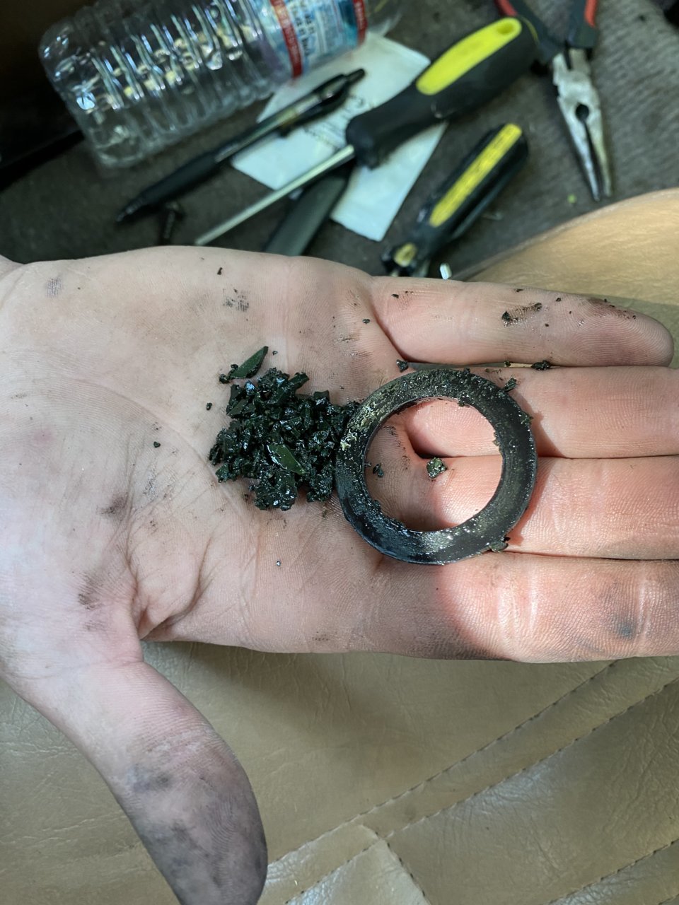

    Hey guys. I was right. It was a bad shifter seat bushing. Put the new one in and good as new. Shifts feel 100xs better and no more grinding or popping out of gear

    Yes. I have yet to see a guy on here with a W59 or R150 trans have an issue that wasn’t the bushing or the bushing or the cup. Of course I could find some but they just don’t happen nearly as often.

    No kidding. It’s a super common problem I wasn’t aware about. 20 minute fix tho
