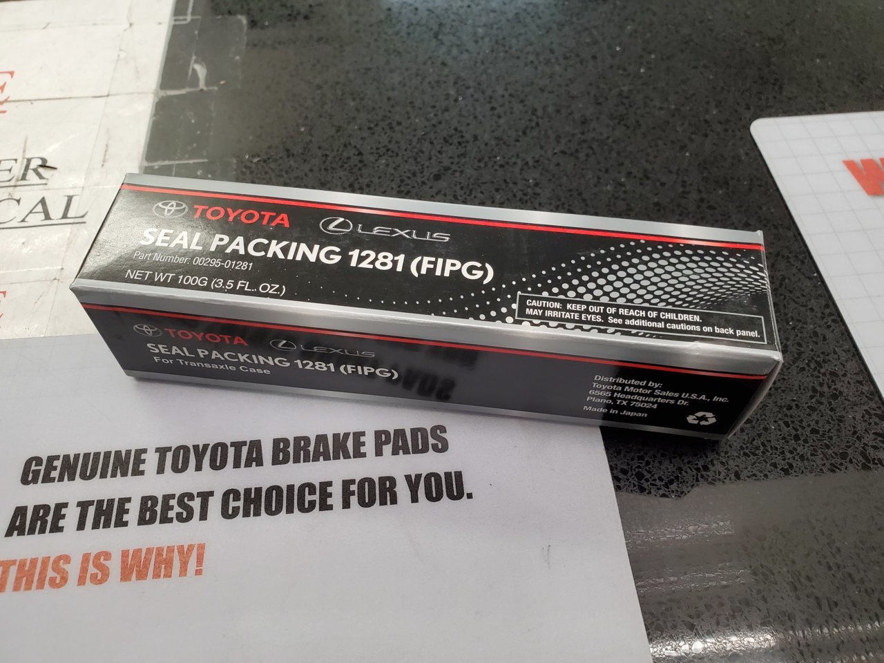

    Copy that. Thanks for the tip about letting the FIPG cure for a day before adding fluid. I ordered the 1281 FIPG and also ordered this kit to see if the filter is the correct fit....we will see.
