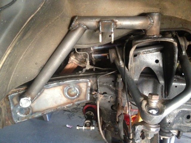

    Fox 2.5x8" Double Bypass on a secondary hoop I made, frame plated at bend.
    Camburg Heimed Steering clevis'
    Heim steering, double shear lbj.
    TC Spindle gussets + custom gusseting
    Solid mounted lower arm mounts, plated with 1/8", and 1/4" solid mounted "cam tabs" with 3/4" grade 8 bolts

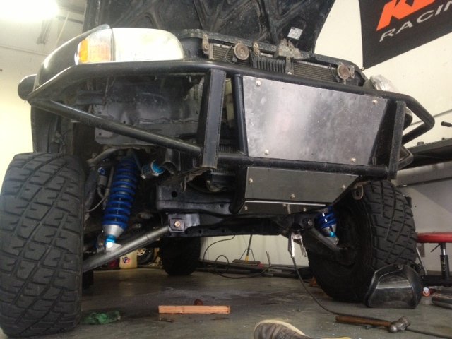

    Bumpers:
    Front:
    2" .120 DOM main tubes with 1.75 .120 DOM tie ins. Wraps all the way to the frame, completely protecting radiator. 1/4" aluminum skids.

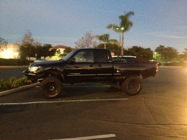

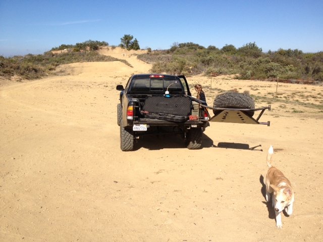

    Got the truck in December for dirt cheap. Looking like this, no bypasses, shitty front bumper, tire carrier and no rear bumper. Rear end sat waaay too high on 700lb coils.
    Worked alright, but I had lots of things to change

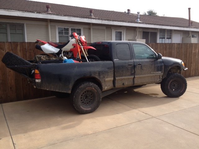

    Fully loaded, heading to San Diego. Notice how even with 600lbs of shit in the bed, it wasn't sagging too bad. Springs were waaaay too stiff.

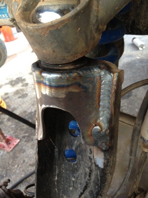

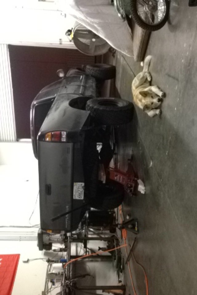

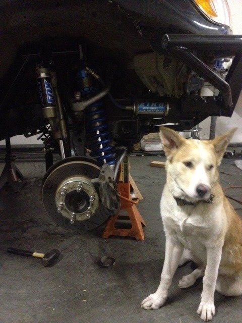

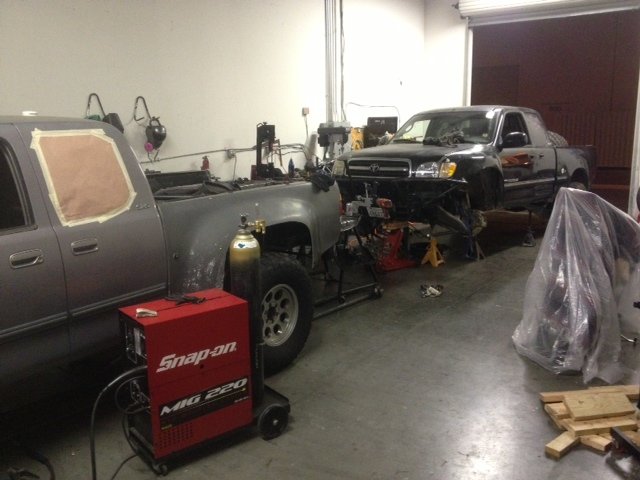

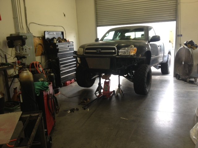

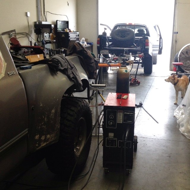

    Got it to Landon's shop and started tearing her apart
    Solid mounted the lowers, plated the shit out of everything in sight. Then got to work doing what I wanted to do.
    Built secondary hoops for some bypasses I picked up dirt cheap
    Turned out good
    Then I built a front bumper

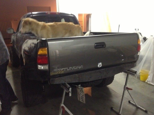

    Then a rear bumper after I ditched the tire carrier for a stock tailgate and some cash.

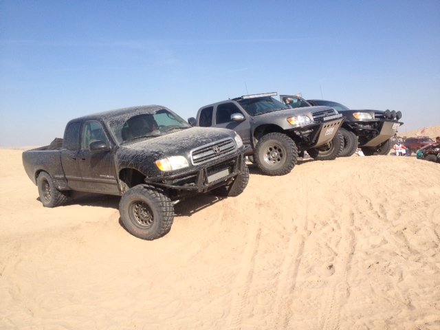

    Went on an epic Ocotillo trip, working my ass off the night before to get the truck prepped.
    Tuned the bypasses, replaced some bushings, etc. Made it out to the superstition trip. Truck did amazing, pushed it really hard and didn't have a problem.

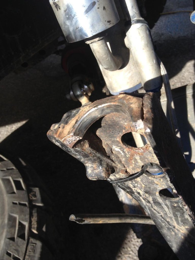

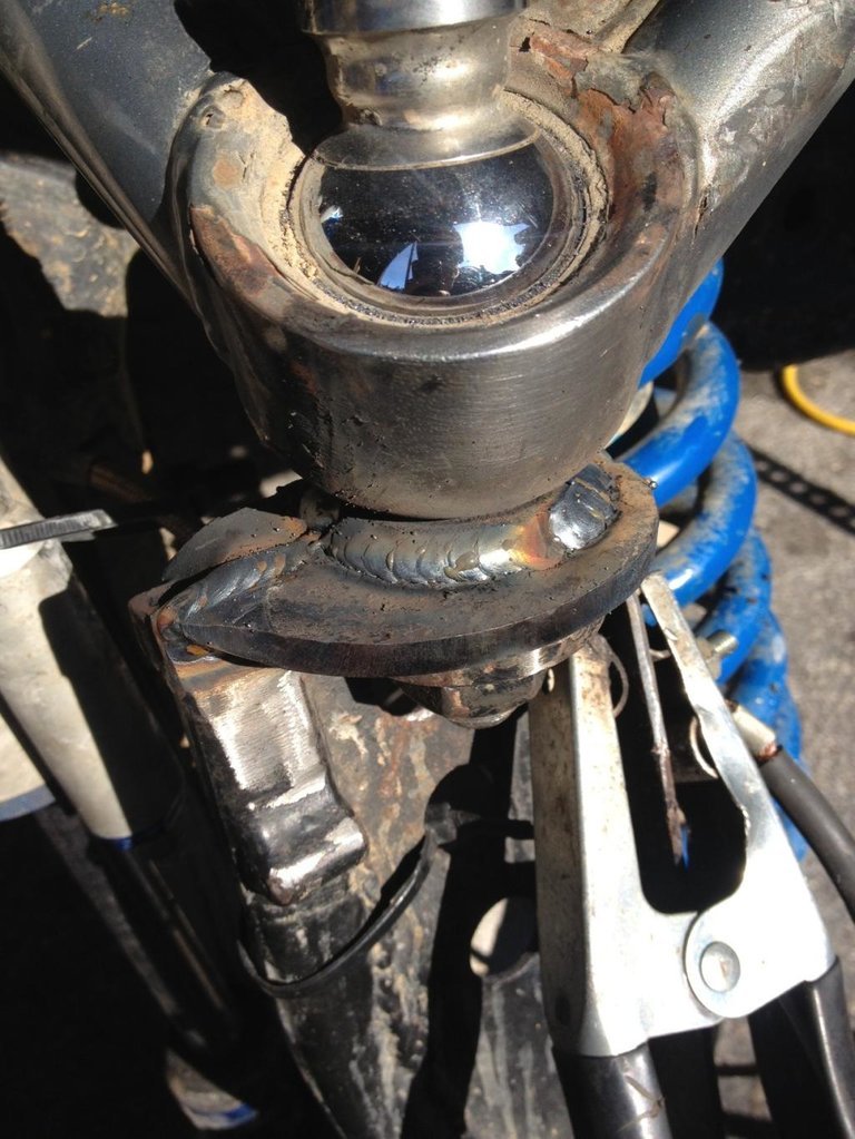

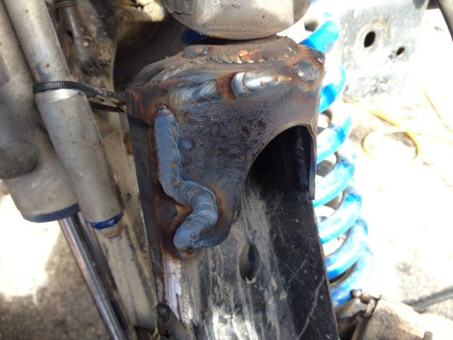

    Broke the spindle in half the other day cresting into a rut. Was cracked before the desert trips, luckily didn't give way in the whoops.
    Fixed it in my buddies driveway back in Isla Vista, pushing 110 as hot as i could haha
    Wrapped it with a piece of 1/4"
    Then plated it in
    Gusseted the other side to keep it from happening again until I can build lift spindles

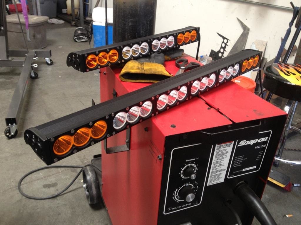

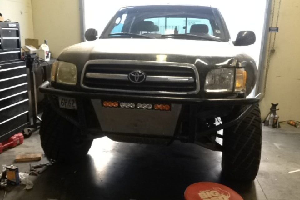

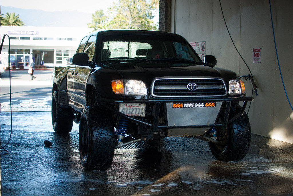

    Went back home to get my light bars. Very impressed with the quality! 10W Cree LED single rows, with amber corners wired separately.
    Will be selling these soon if anyone is interested.
    Mounted one under my bumper behind the skidplate. Was hoping to use two 30's but this was the cleanest way and im going for a slightly sleeper look.

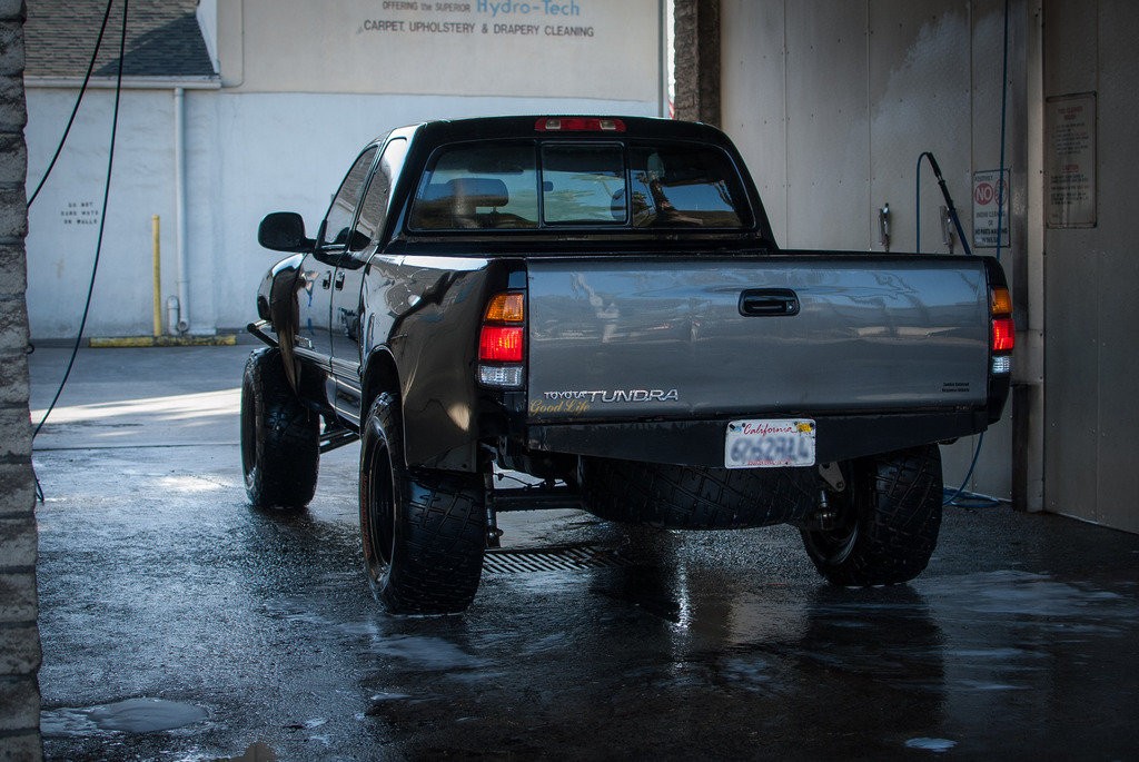

    Finally washed it haha truck-1_zpsuxyjzcxu_f78e858acec029187057e0be5396230193452573.jpg
