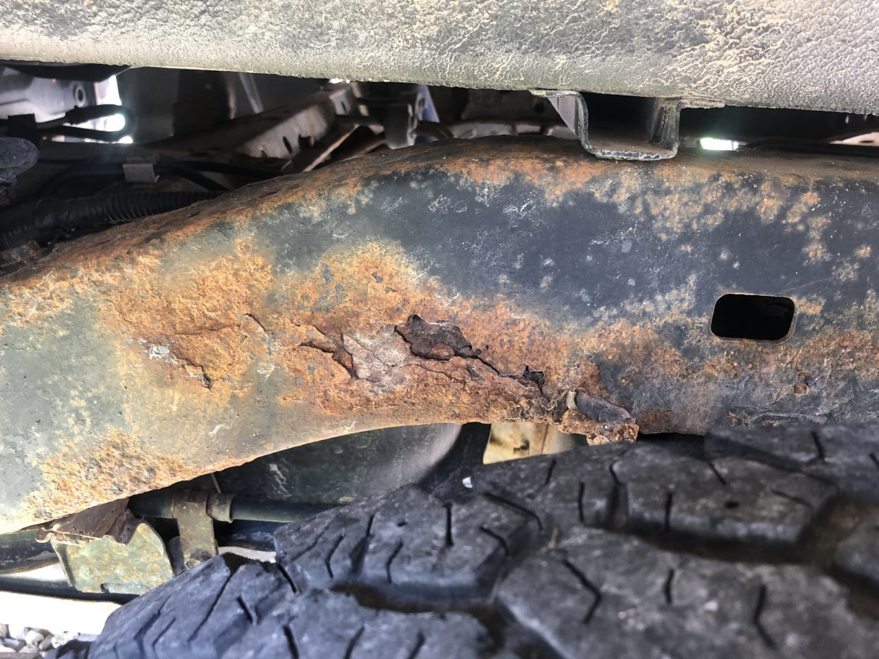

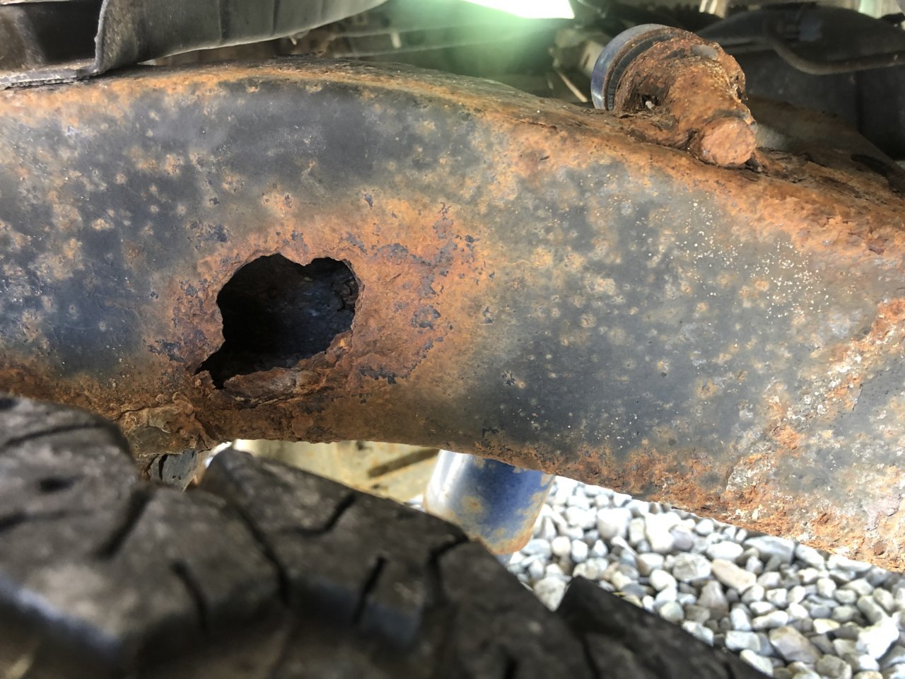

    I have a 2001 Toyota Tacoma i’m starting to see a lot of rust under my frames and I have a couple holes in the frames to now

    What's your question OP? Are you asking if it's bad? If so, yes, that's bad.

    Should't drive that thing anymore, those shock mounts look like they're about to break off with one good pothole hit. Not to mention the frame breaking more.

    I'm not to sure what answer you are looking for. It is bad in an important area and may be bad in other spots too. Are you considering repairing it, having it repaired, or replacing the frame? What is the mileage and are there any other major issues such as transmission problems, overheating, oil burning, major suspension problems or body rust, can you do the work yourself ? Those answers will suggest the best course to take.

    @wilytoy01 like troyken said there are options, it just depends on what your situation is. I used Safe-T-Caps to breath a bit of new life in the old girl, but i was willing to do the work involved by tearing my whole rear end apart. Some folks are still getting lucky and getting approved for new frames from Toyota. You need to check the rest of the frame with a hammer to see how extensive your rot is. In the end it's up to you if it's worth the time effort and money to fix, replace or let go.

    If there is any possibility of Toyota covering that frame that would be great. I had a '78 Jeep CJ7 that had the rear cross member and spring mounts rotted out by about 1988 or so. 20 years out of a frame in a salt state isn't that bad. I fixed the jeep with plates and angle iron and it was ok after. I live right on the coast though. My truck is rarely ever more than a 1/4 mile from salt water, and they salt the roads in winter so fluid film and rustoleum are my friends and so far so good. Too late for the O/P but others should be very vigilant about inspecting and touching up the frame before it gets this bad. Hopefully it works out for him.
