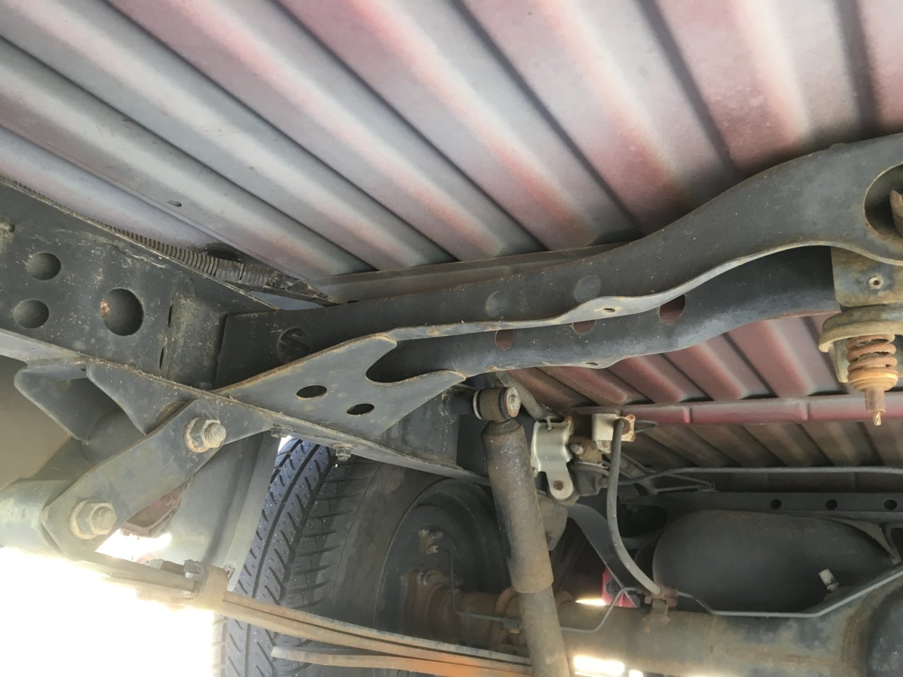

    Here is my 95 underside:

    i bet my trucks had more fun plowing through a foot of city snow and sloppy slushy ice :cool: sux hosing it down in sub freezing temps brrrrrrrrr
    why is your bed not underlined? is that not a common practice in SC to prevent rock chips? i mean you must have gravel roads?

    Interior “retroficaton” (in progress) Airbag removal (1st gen/high explosive type) Hard Tonneau (on it when I got it) New grill, with custom badge Light Steelies S-Runner suspenion
    Mine isn’t. I only bought it in Feb, but it’s been in the area for 20 years.
    The 3 others I’ve looked under to see what I was missing weren’t undercoated either & all three looked to have good frames too.
    Edit- I was looking at the spares. My truck had no spare or tools, so I looked to see that was supposed to be there.
    I think I am also missing a brace on the passenger side of the bed.

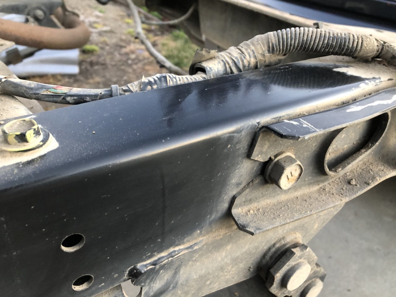

    This is the frame of my 1998 5-Lug SR5 with 450,000 miles. It has never left California. I wiped the dust off and it was so shiny, I could see my reflection in it.

    another frame that has probably never had the joys and thrills of plowing through deep city snow and sloppy slushy ice ... it doesn't know what its been missing out on :cool:
