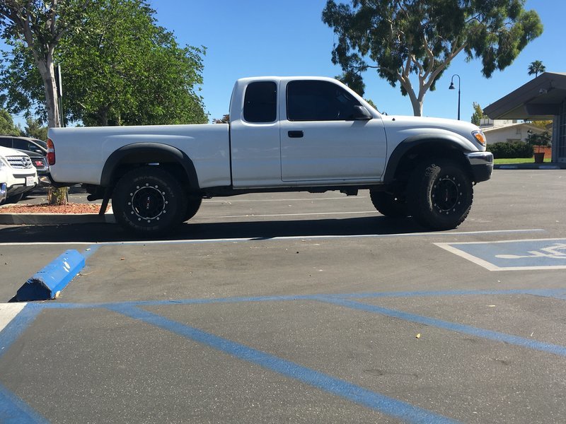

    image.jpg I like the auto cause I can eat and drink coffe on the way to work, I would rather get a 6cyl why would you want to rebuild a trans for more cruising power wit more gears instead of just getting more power with the bigger engine MPG isn't far off at all
