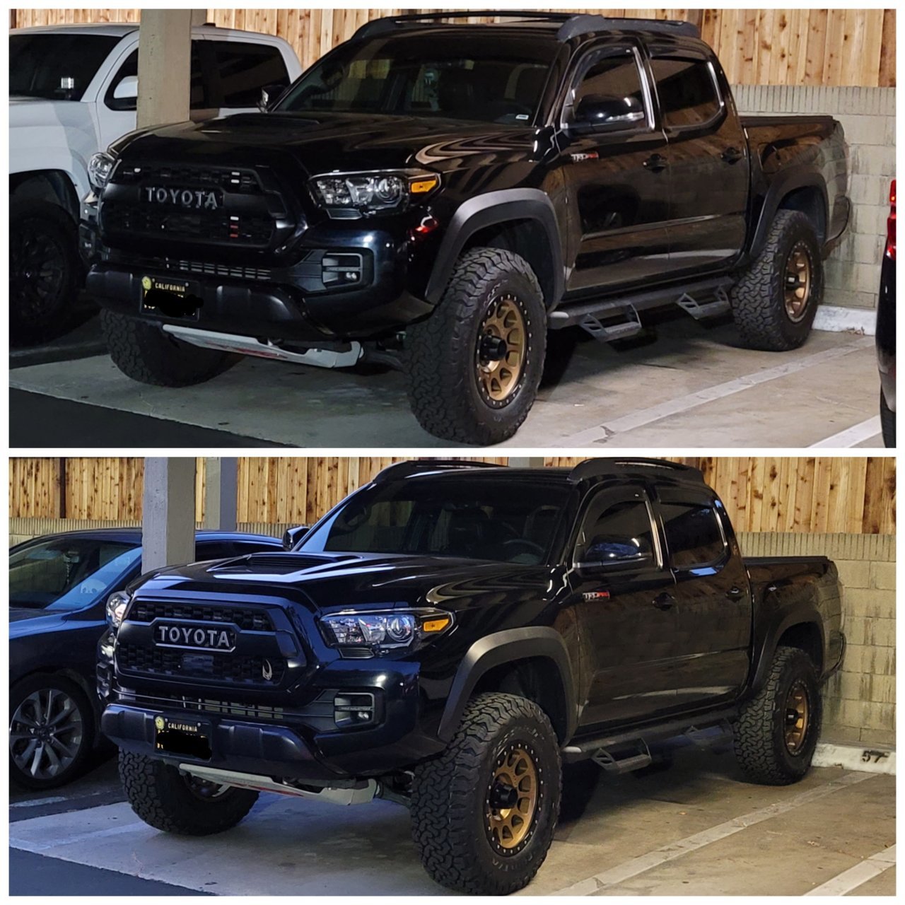

    265/70/17 Stock lift top pic
    285/70/17 Westcott kit 1.5 front 1 rear bottom pic

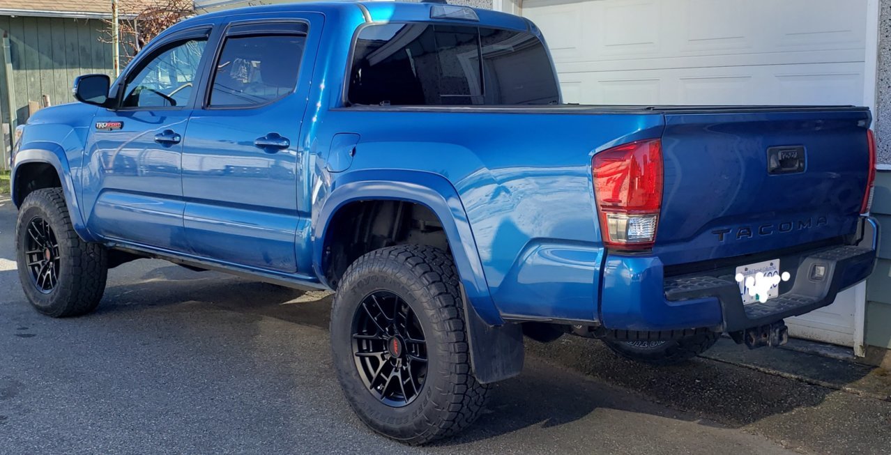

    Also running Toyo Open Country AT III 265/70R17's... 20220309_113958.jpg
