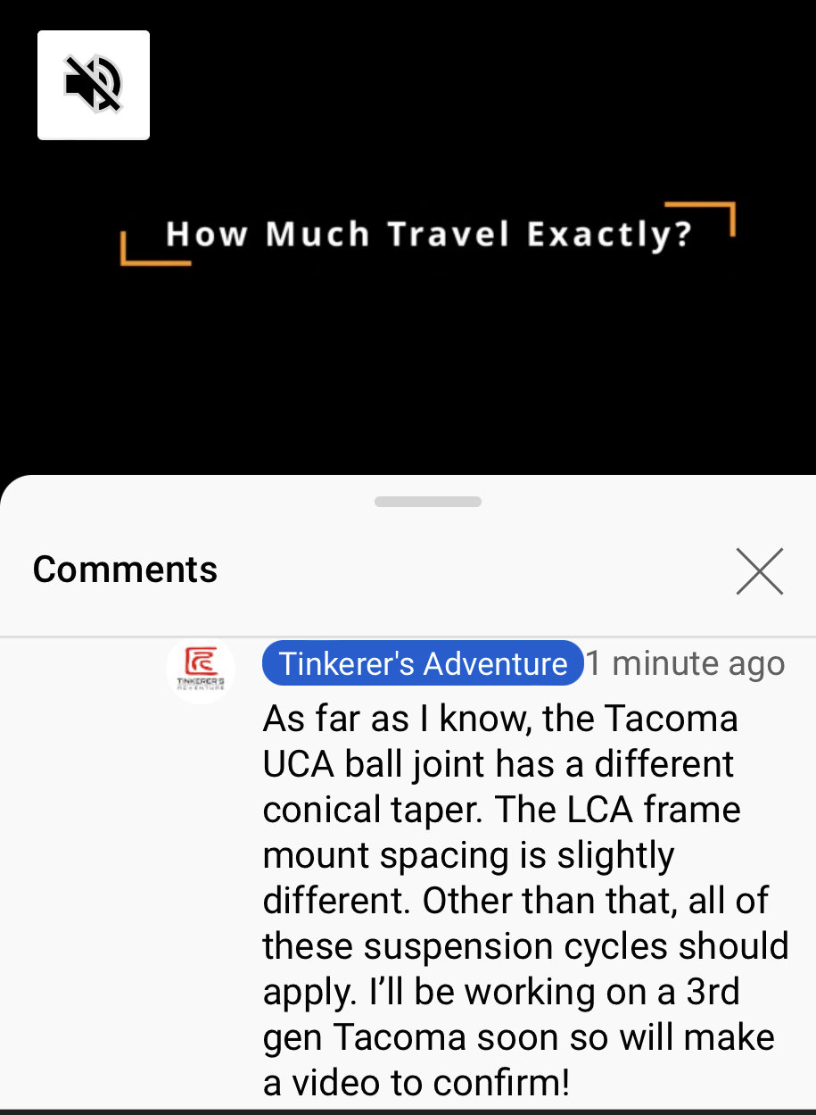

    Watch the video. The Tinkerer will be doing a Tacoma video soon. I asked him if would and here is his comments:
    Good Luck and have fun.

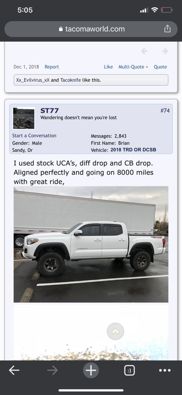

    You have a Pro so different animal.
    Compared to him your at 2.5 front 1 back and why your ass low in that pic.

    UR RIGHT! my ass low? hard to take pic with same exact spot lol u want more pics... i got em

    i keep seeing people mentions diff drop and cb drop
    like this
    so neither are needed? New to this so not sure what a diff drop and cd drop does

    diff drop was more popular with the 2nd gens it seems. I had one on my 3rd Gen with the lift I had at the time and all it does is slightly rotate the dive so the CV angles seem to be a little less. However it rotated lubricant away from an area and created a weird faint vibe. So I took it out and it’s been great since.
    most lifts under 2.5” don’t have too bad of cv angles anyways. A boot stretch mod fixes this easily…
    the CB drop is a debatable subject. I recommend axle shims before CB drop, but others argue it as a quick fix for vibes. It wasn’t so for me after 2 different lifts
    I suggest keeping the diff where it is

    CB drop is dropping the carrier bearing to change the angle of the front driveshaft…to avoid vibes. I still recommend axle shims for this
