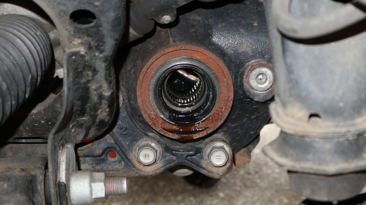

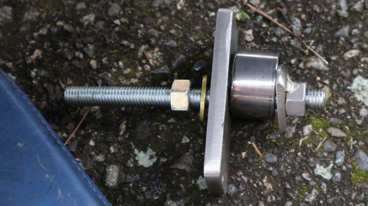

    the ECGS bushing replaces the driver side needle bearing. Needed, own issue

    You can probably hold off on the axle shims until you see how your truck shakes out after the lift. I haven't needed them and a lot of others report the same.
    It's good to do the needle bearing replacement preventatively since it's pretty common to have an issue and you'll already have basically everything out of the way when you're replacing the front suspension

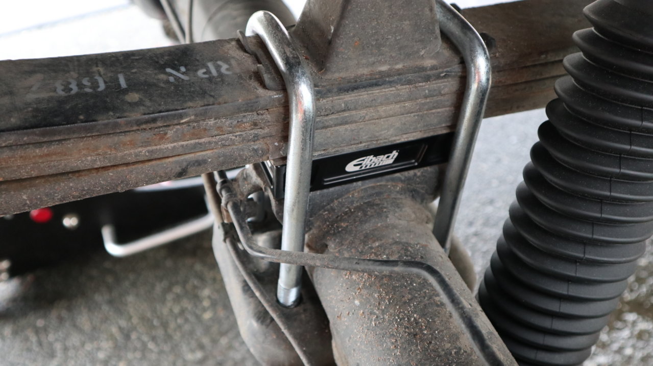

    I installed a 1 inch blocks in the rear
    You can see right above the block, there is a factory shim. I left that in place. I have zero driveline vibrations.
    I also did the ECGS bushing install, more for my peice of mind, I would hate to have to go back in to replace it later...
    Again, zero issues...

    you may not need shims, but rule of thumb is 2-3 degree shims for a 2-3 inch lift.
