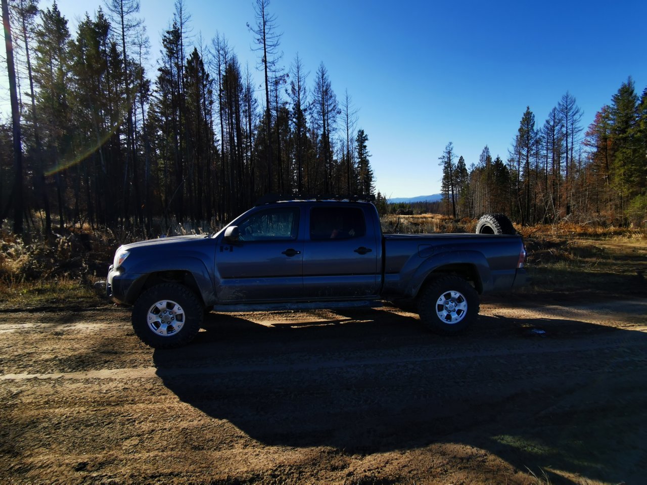

    I have all ome front and back with 885x coils. And the medium leafs. Here's how it sits .

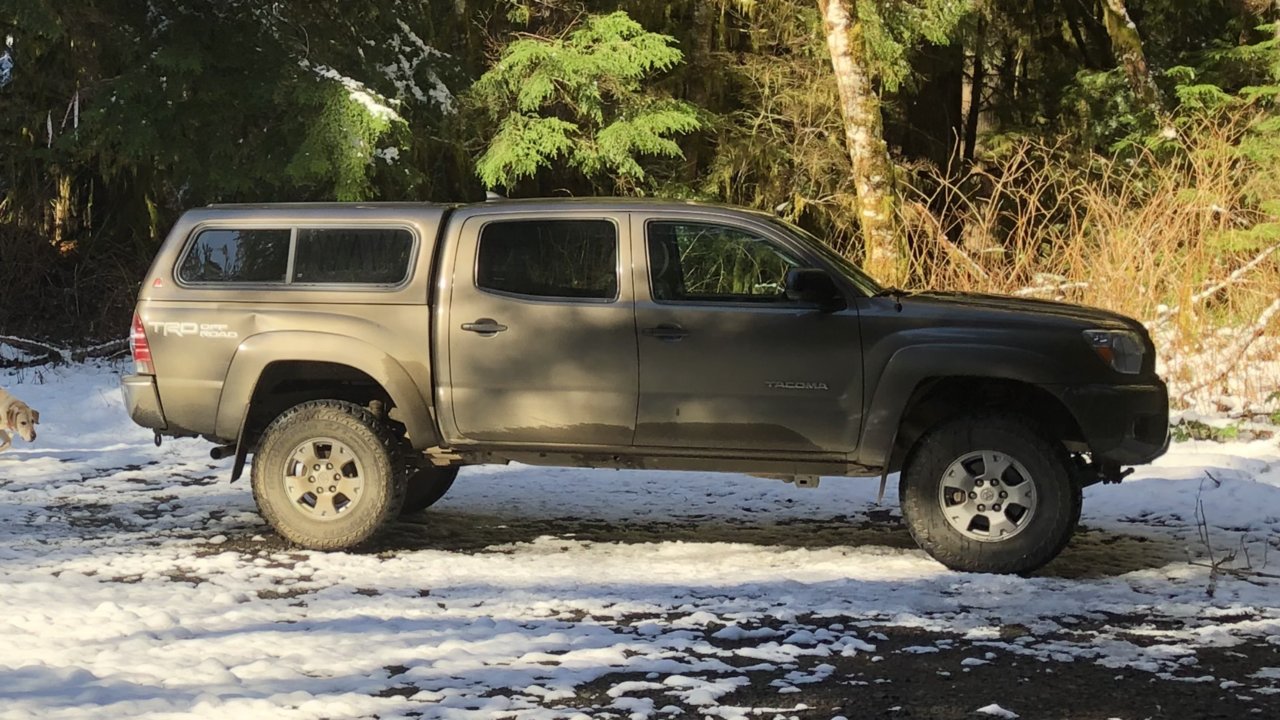

    I had OME 888's, Dakar medium leafs and nitrochargers all around. Truck rode great but the 888's sagged terribly in very short time. I ran that setup for a year (12k) but I ended upgrading to Kings. I'm happy, although I did cry when I saw the month's CC bill.
