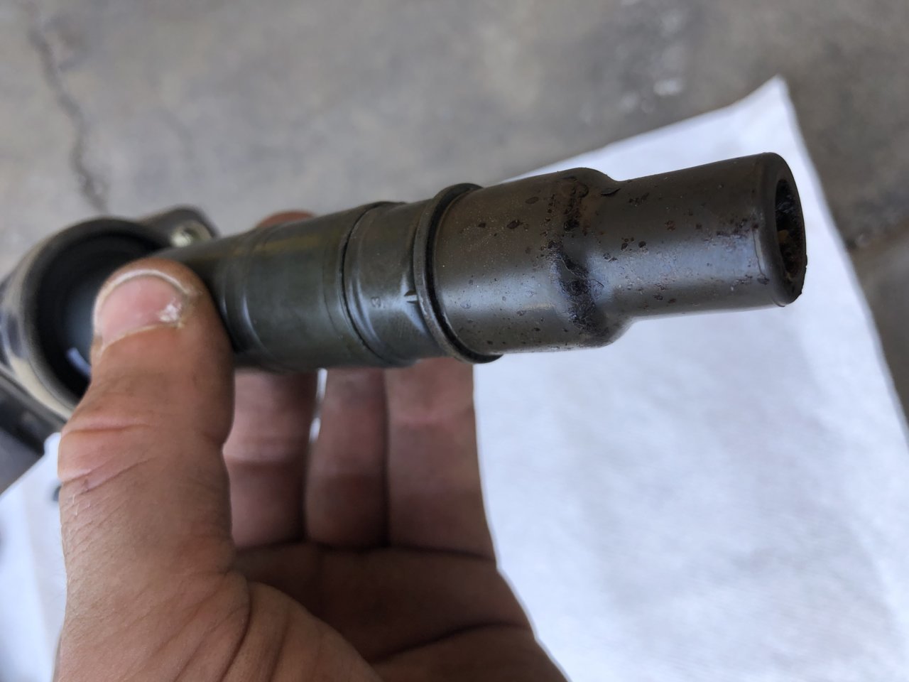

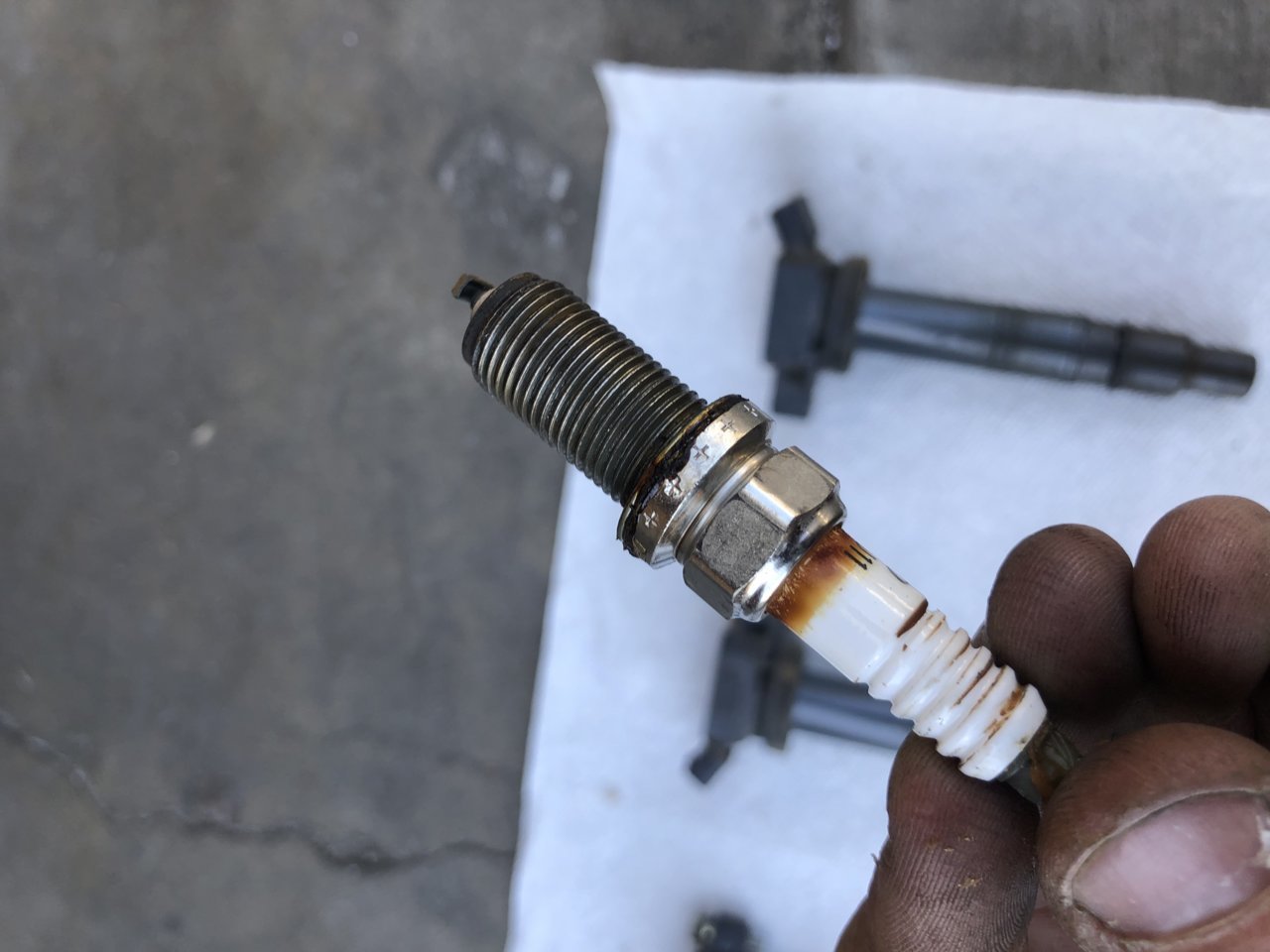

    changing spark plugs today:
    Everything looks and feel fine except the plug nearest firewall on driver side.
    Sparky tip looks fine but there was some discoloration on the sparky charger and some oily burnt junk on the sparky maker. can’t remember words right now but just look at the pictures alright?
    I think its probably just some liberal use of thread lube by a toyota tech but i figured i would see what yall think! :help:

    Does this mean you have original plugs? How many miles? Assuming its a lot, big ups to Toyota engineers.
    Short answer is it looks fine, but these trucks tend to run better on fresh plugs so clean or replacement is probably due. A more knowledgeable interweb mechanic can correct me, but there's no grease on the plug or coil. Since it doesn't look more than a little dirty past the threads, odds are some oil got in your coil somehow and cooked. They're not perfectly sealed, but you should check the plug seal for visible cracks and replace if you see any. I have a cleanable air filter and when I first put it on I over oiled, some of the oil dripped down into my coils and baked on a similar brown coloring on my passenger side plugs :tinfoilhat:.

    Dealership replaced them at some point in the past... But on further inspection it looked like it had been sitting there baking for a while. I replaced the plugs last week and it’s all running smoothly. I did have a reusable filter and that may have been the issue.
