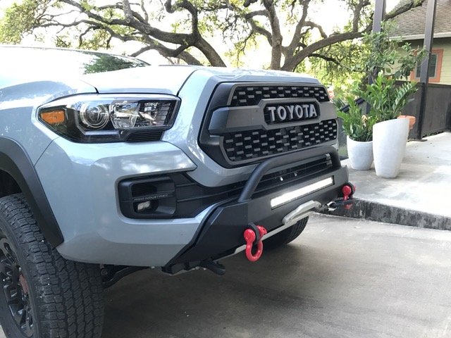

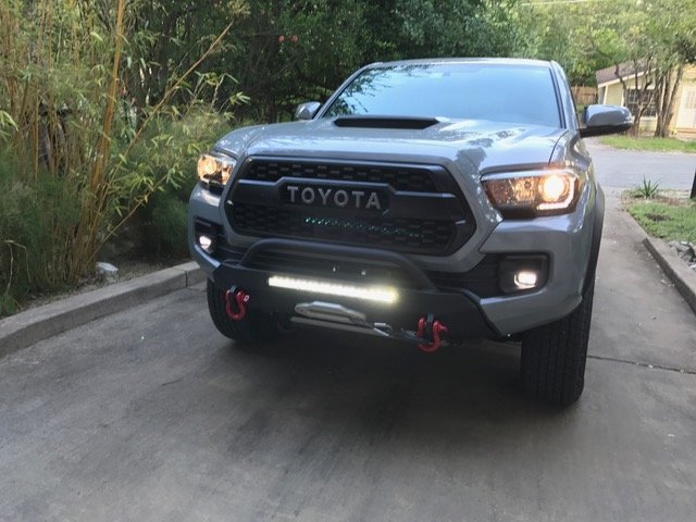

    With the help of Chris (Texoma), completed a major mod that I had been wanting. SSO hybrid bumper with winch and RI light bar. Love the understated front profile.

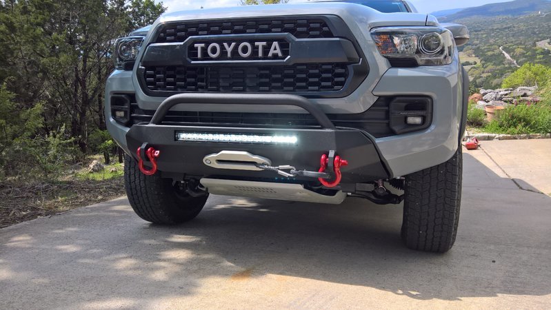

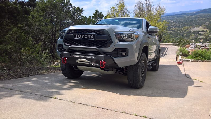

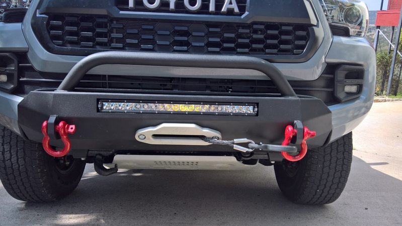

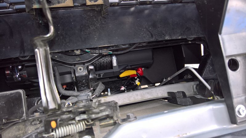

    Smittybilt 10k#. Here's pics I have.
    WP_20170318_14_52_23_Pro.jpg WP_20170318_14_51_14_Pro.jpg WP_20170318_14_51_26_Pro.jpg WP_20170318_14_51_43_Pro.jpg
    Don't have any pics of install as we were too busy doing the work on it. First thing we did was cut the bumper. Super easy with it still attached to the truck. Then we pulled the grill, two screws and two push pins and it is free. Next was the crash bar, it is easier to remove if all twelve of the nuts on it are loose. Then you just disconnect it from the body panels and pow. Another two things we did so that we didn't have to remove the bumper was cut half the radiator wings off and bend the low end of the center radiator support upwards. After all that, when the winch and light were in the new bumper, it just slid right in. Only problem after the new bumper was installed was putting the grill back in. In hindsight, we should have left the wrapping on the top bat of the bumper so that the grill may have slid past better. But it went in without much issue.
