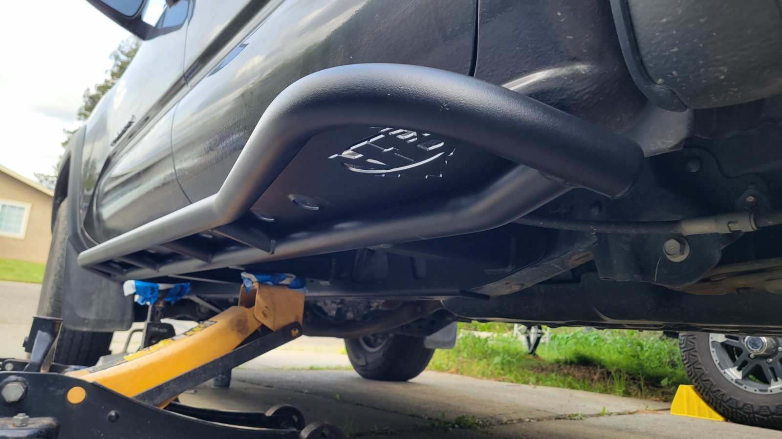

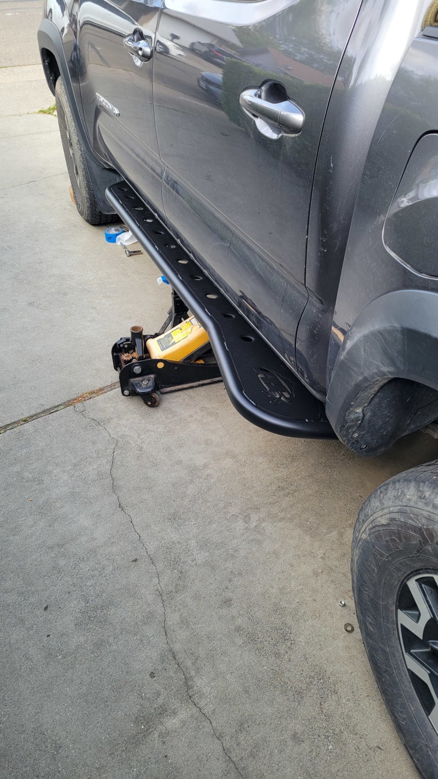

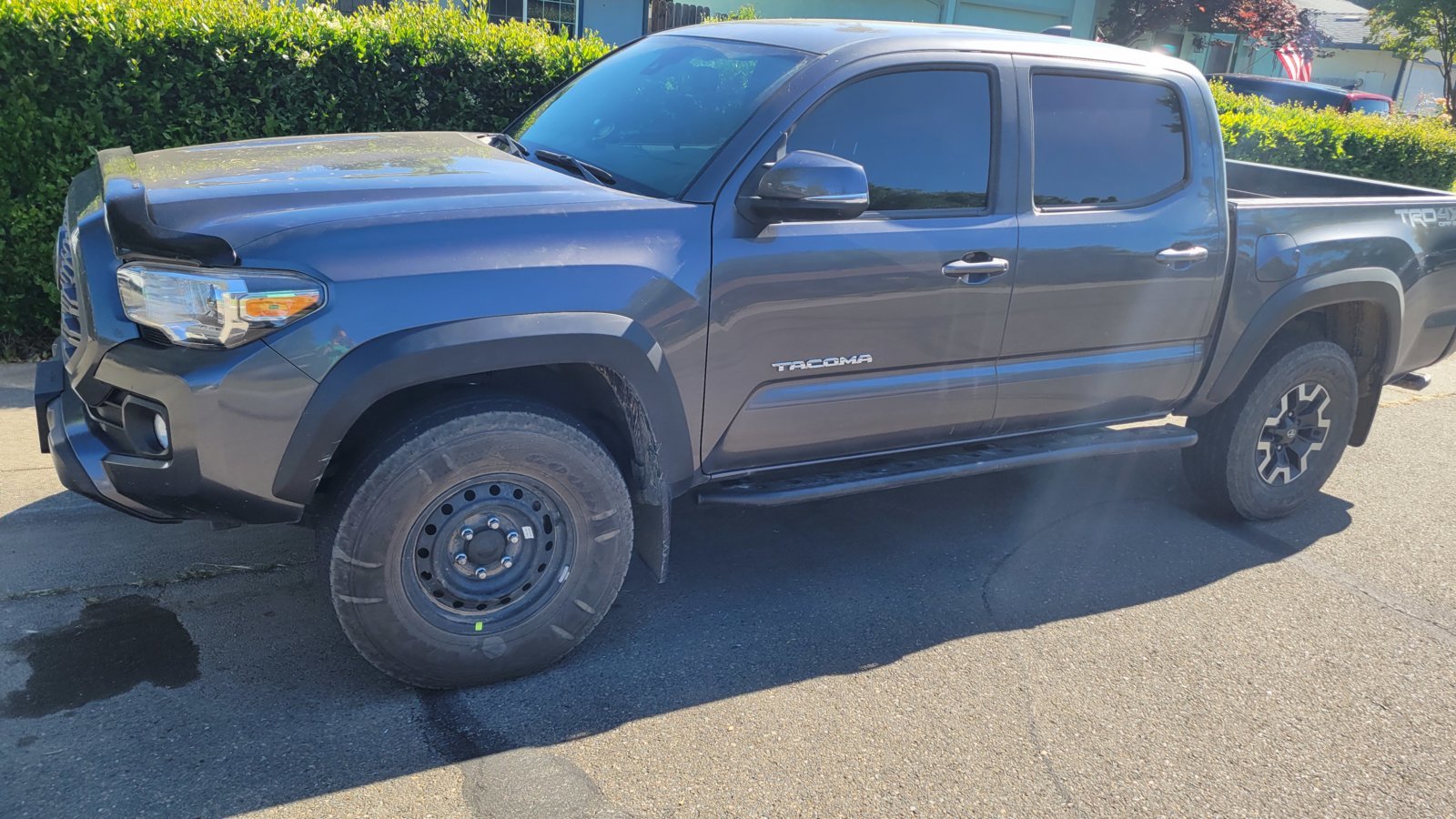

    Update: I have attached them without drilling holes yet. Took some time for driver side, getting around the brake lines. Funny enough, got a flat first trip with em attached. My stock jack didn’t reach high enough, someone helped with a floor jack and started to jack truck up with it. I was like this is my first test of those… he moved to frame to be safe.
    Anyway they are attached mostly, for now.

    Here’s one more view during installation from below, jack supporting while attaching.
