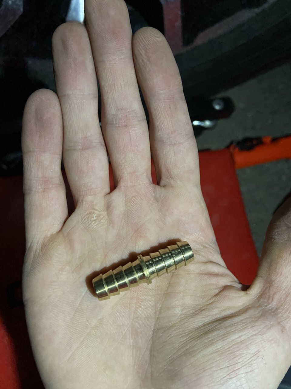

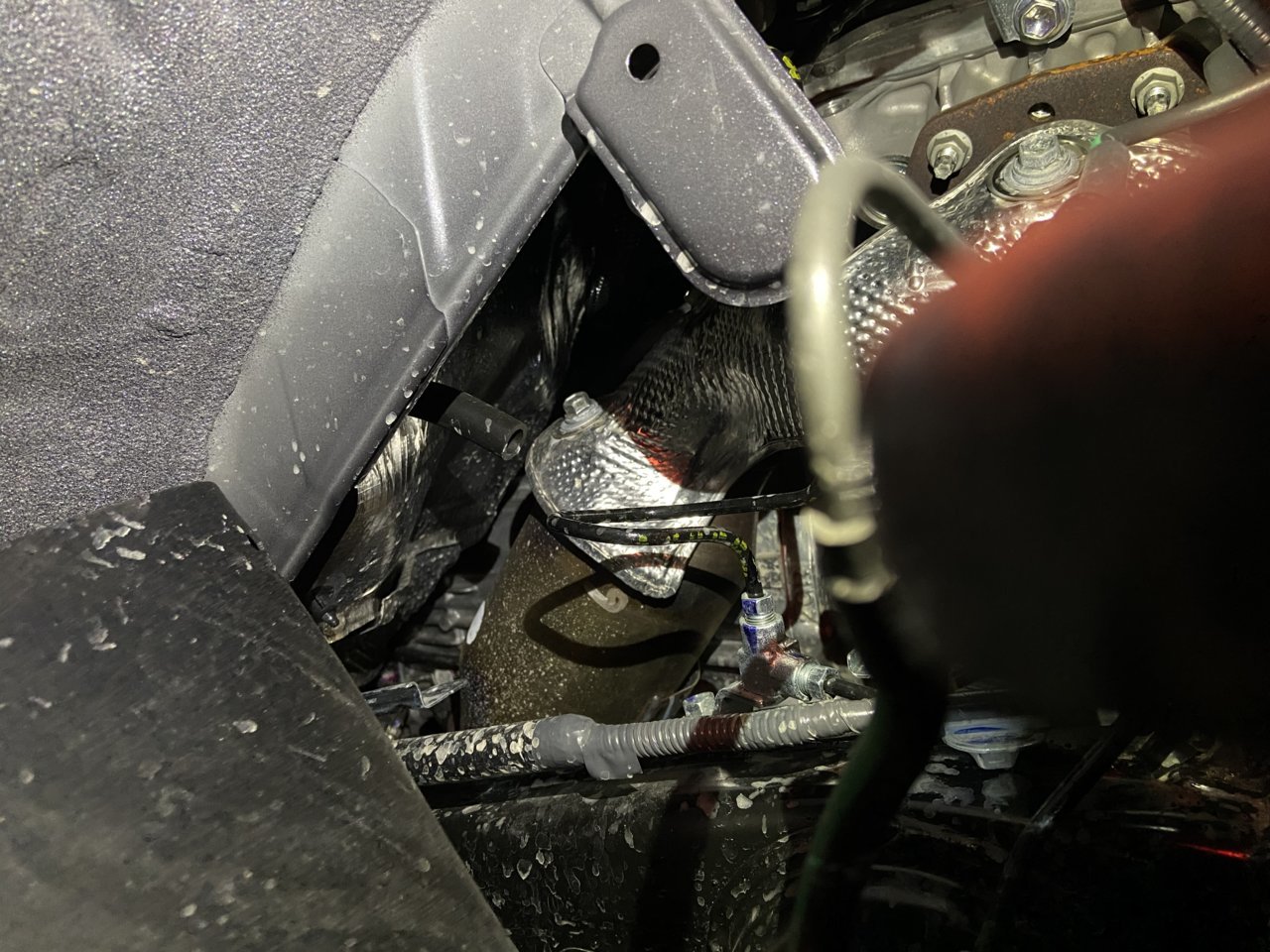

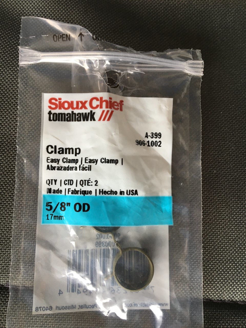

    Was easy. Once you have the materials and pair long nose and a cutter for the hose

    Good job using the double barbed fitting.
    It slightly irked me watching other “how to’s” that instruct people to cut off the oem clamp and use one piece of hose with a crappy worm gear clamp.

    Thank you, it took a little less than five mins. And yes I watched the vids and read the treads.

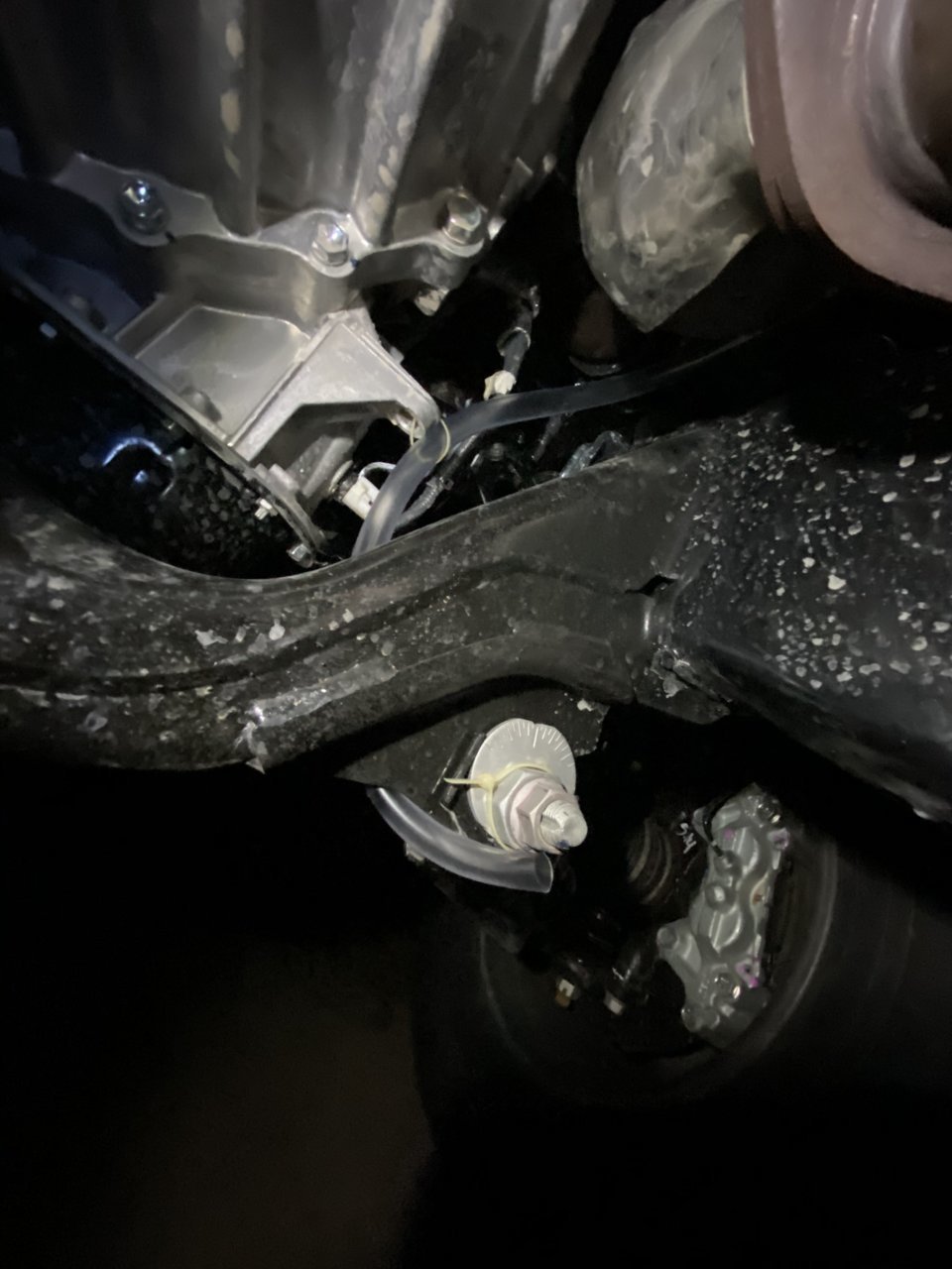

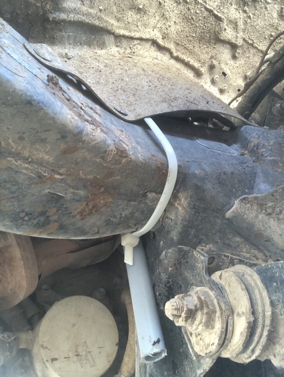

    I just did the same mod and routed the hose down to the bottom of the frame. Hoping there’s no issues down the road as I’ve had a corolla drain hose clog up and destroy the floor. Toyota said it was leafs that clogged drain holes throughout the car and refused to cover it under warranty.

    What size hose did you use for the a/c drain mod. Looking to do mine this week as a/c season is coming upon us here in the southeast
