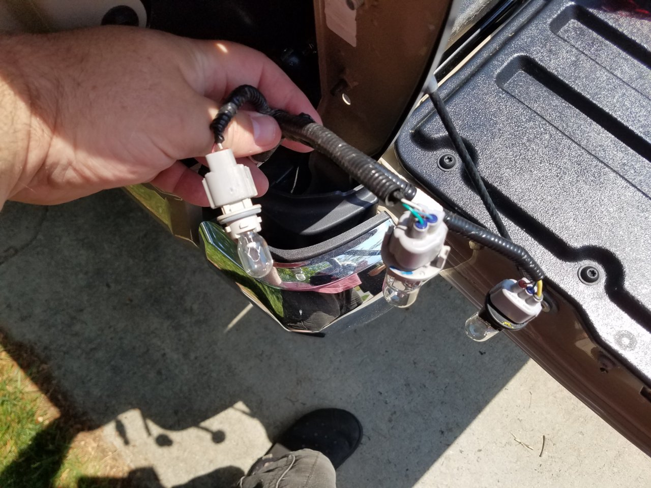

    So, I can't seem to fix the problem with the passenger side light. I decided to drive it in to the dealer to look at and now the rear left turn signal does not work.
    It should be the simplest thing: you take out two screws to remove the tail light housings and then simple little twist to remove each bulb. And yet I have clearly somehow managed to screw it up.
    I just can't understand how.

    Here is a pic of the driver side:
    So, I tried messing around and something interesting happened. The turn signal had crapped out on the rear driver side. This is the top bulb (the rightmost one in the picture). When I switched this bulb with its counterpart on the passenger side the signal started working on the driver side and stopped working on the passenger side.
    Its possible I guess that the bulbs bad connections?

    I’ve been drinking a little today, but I’m pretty sure that’s a bad bulb.

    Yep. You are correct, sir.
    I have a buddy who is a master mechanic (i.e. long experienced mechanic by trade) but out of town. He saw my text though, contacted me and said: "first thing, before you spend tons of coin at a dealer: change out the bulbs. OEM bulbs are generally shit with shit connections that get rapidly shittier as you drive the new car off the lot. It is one of the places most manufacturers have gotten loser cheap. Cannot tell you how many times I've messed one up while doing something else with the lighting assembly."
    So I went to old Autozone, changed out 3 of the bulbs and...boom: it works.
    Lesson learned.
