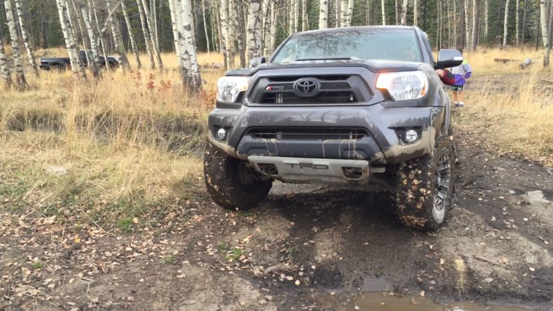

    I'm a KO2 fan, that is what I run. You mentioned you had traction issues, the KO2s look pretty jammed up in your pic and traction would suffer significantly. KM2s would not suffer the same way and would still provide traction, possibly negating the need for a locker, which is why I mention it.

    That doesn't really look like a body lift to me. Could swear I see strut spacers in one of the pics....am I wrong here?

    Yeah, me thinks OP got a spacer lift from the dealer not a body lift. I don't think a dealer would sign up for the liability of putting a BL on a truck leaving their lot.

    Yes you're right that is a strut spacer you're looking at. That's how much of a noob I am! Just called the dealer, they don't do body lifts.. It's a pro comp suspension lift, 3" front 1" back.

    Yeah, I was gonna say... I don't see a body lift but I see a spacer! If it was a body lift those side steps would have a huge gap between them and the cab. Nice truck, looks like you had a blast.

    Not necessarily true about the side steps... I think most side steps attach to the cab of the truck on the 2nd gens. So raise the body with a body lift, then the side steps would be raised as well.
    But I agree, it doesn't look like 3" body lift is on that truck. If it was, the dealer would to have had brackets made to raise the bumpers and trailer hitch... And the TRD skid would've been below the bumper.
    Definitely a spacer lift.
    Awesome pics... Glad you got out and enjoyed your new truck! Looks good!!

    Yes..thanks everyone, just to clarify again, I followed up with the dealer and they do not do any body lifts. It is indeed a suspension spacer lift
