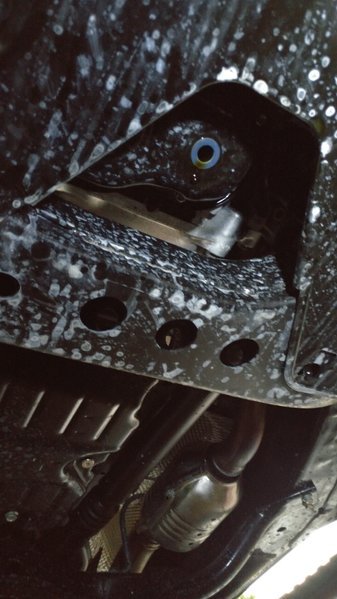

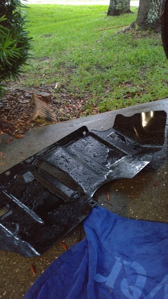

    Finally getting around to posting some pictures I took from my first oil change on my '17 DCSB OR 4x4 and wanted to share some thoughts on it. First of all, I've always changed my own oil on every vehicle I've owned between my wife and I and am used to a 15-25 minute process from start to finish taking my time. This is my first Tacoma and my first cartridge based oil filter to have to replace and I'm definitely not a fan. Not a fan of long narratives either so I'll give you the bullet point version.
    Total work time: approximately 1 hour
    • Had to drop skid plate
    • Oil drain plug and filter are located too far away to drain into a single pan, so you either have to do one at a time or use two oil pans (I used two oil pans).
    • I made a huge mess changing the oil filter. Not sure if there is an easier way but I found it to be quite an ordeal to unscrew the retaining cap.

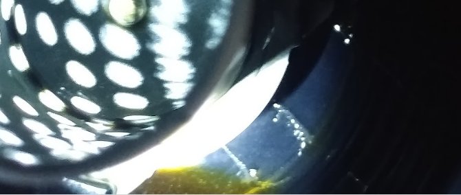

    • ************* There was a significant amount of fine metal shavings in the bottom of the filter cartridge cap *************
    • The shavings were not captured well in my pictures but I tried to zoom in to show you. There was a lot more than I was able to get a picture of. I would definitely recommend changing your oil at around 1k miles and to change your filter and rinse out the filter cap.
    • The TRD OR 4x4 takes 6.2 quarts with a filter so you must buy either two 5 gallon jugs or a 5 gallon plus 2 single quart bottles. Spend money yay!
    • The mobile 1 oil filter is $18!!!!!!!!!!!!!!!!!!!!!!!!!!!!!!!!!! (I didn't buy it)
    • The K&N (cheapest I could find) is $8 at autozone
    • Total cost was something like $42 for mobile 1 advanced economy at Walmart and K&N filter at autozone.

    Thanks for the info, LJA. I'm planning to do my first oil change on my 2016 Taco TRD OR this weekend at 2500 miles. Your metal shavings make me hope I didn't wait too long.
    One question- in getting ready, I dropped my front skid plate to scope out the wonderful new oil cartridge housing. There's a strange metal tab that hangs down and appears to be soldered at the top. It looks like it will clear the housing as it rotates, but does anybody have any idea what the devil it's for??
    Thanks in advance.

    No idea what it's for. But the cap and socket clear it fine

    I've heard a lot of people say that they couldn't get the drain plug out of the filter housing. When I did mine at 500 miles or so, I started by inserting the socket wrench into the filter plug and applying even pressure. Like others, the whole housing started to turn. I found that if I insert the socket wrench and then hit the wrench with the palm of my hand instead of giving nice even pressure, the slight shock given by whacking the wrench broke the drain bolt loose instantly in a way that wouldn't have happened with even pressure. It didn't take much of a whack. Give it a shot.
    Also, mine had the shavings at both the 500 mile oil change and the 5000 mile change. Since I'm used to canister-type filters where you can't actually see what's been caught, it was a little alarming.

    All engines are going to have metal shavings in the oil on the first dump. Because you dumped it so soon, you will also have shavings in your second dump.
    People don't see metal shavings in their oil on the first dump across all vehicles because most people don't change their own oil

    Filter is doing it's job, but you're not impressed?
    Thanks for the write up, but telling everyone that there's too much metal observed in your filter is similar to, "there's dirt/ grime on my tires after I drove it".
    The observed metal in the filter element is a given, since metal to metal parts are seating in. In the future, should you desire, there are labs that can examine your oil as well if you send in test samples. You will still find lots of contaminants that only their analysis can breakdown and give you a report.
