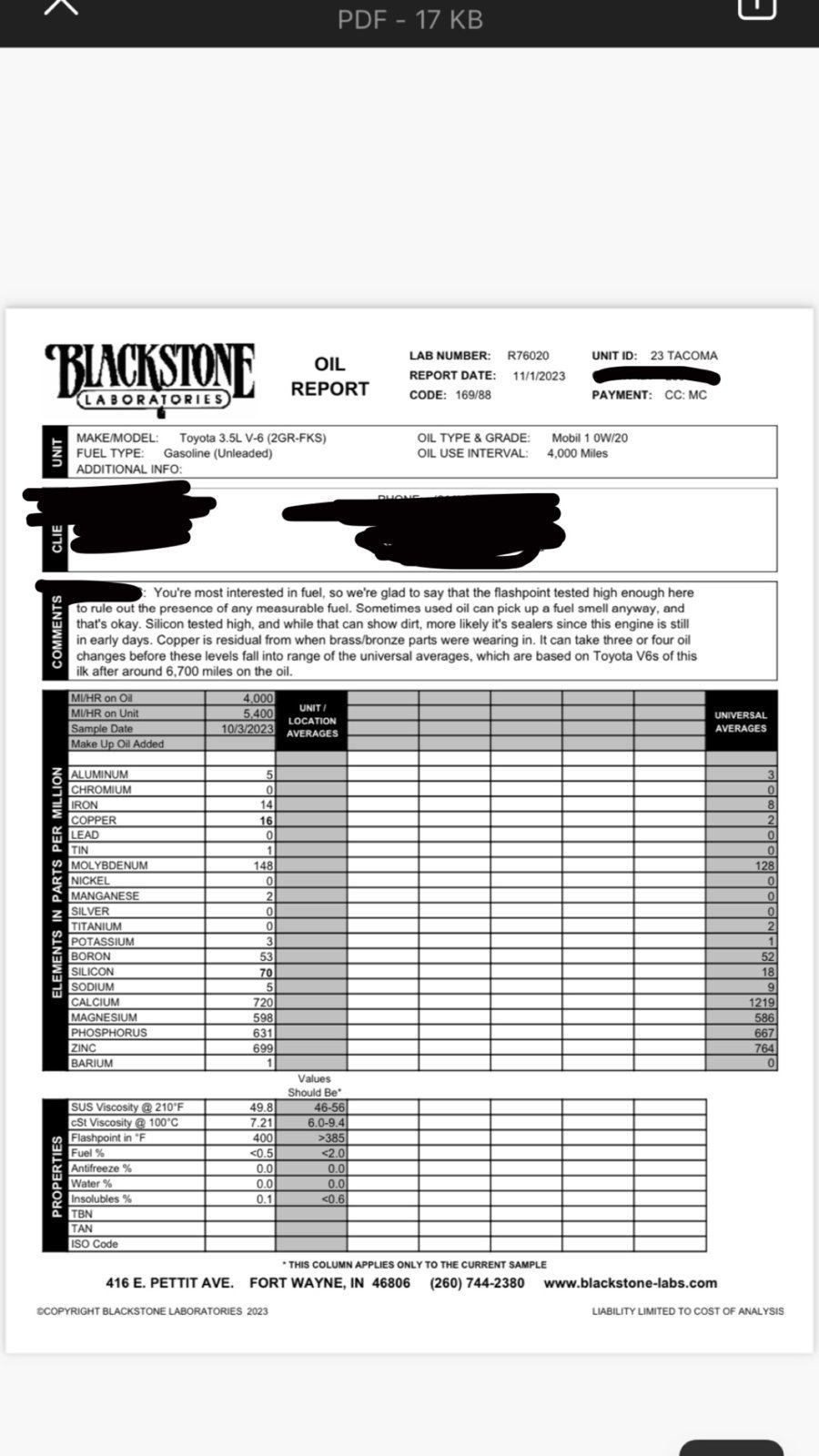

    My oil looked like yours too at my first oil change. It also smelled like gas. I’ve sent in two oil samples to Blackstone and both have come back normal. I specifically asked about fuel dilution when sending my samples in and they have told me twice that nothing is wrong. I saw someone mention loose spark plugs from the factory. I haven’t checked mine yet but I’m hoping to get around to it soon. Maybe check yours? Here is a pic of my latest oil analysis 3B714BF5-24D9-4E7D-BFCD-016B0F87023A.jpg

    Awesome to see an oil analysis. I used to do oil analyses when I was part of other car forums and got into debates on "when to change oil". Far too many people still cry wolf at 5K oil changes during normal driving conditions.
    Edit: I was looking at your numbers. If your silicon levels do not change, you might wanna change to another air filter brand as your current air filter may not be stopping dirt ingestion. Silica is naturally present in dirt and is harder than steel. This will definitely destroy your engine over time and reduce compression.

    It could also be that the higher silica content was from casting and not all completely removed when the block and such were prepped and machined.
