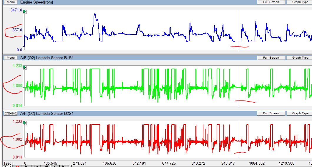

    in my experience fuel dilution happens on direct injected motors
    But when there’s HPFP failure leaking it down…(it’s a symptom of it)
    or excessive idling. Idle mixture is rich and long enough contaminates oil with gas.
    ie why more frequent OCI is recommended with high idle time like cop cars

    Why would idle mixture be rich? We are running in CL mode almost right away from the start. Unless you operate in extreme temperatures

    idle is rich.
