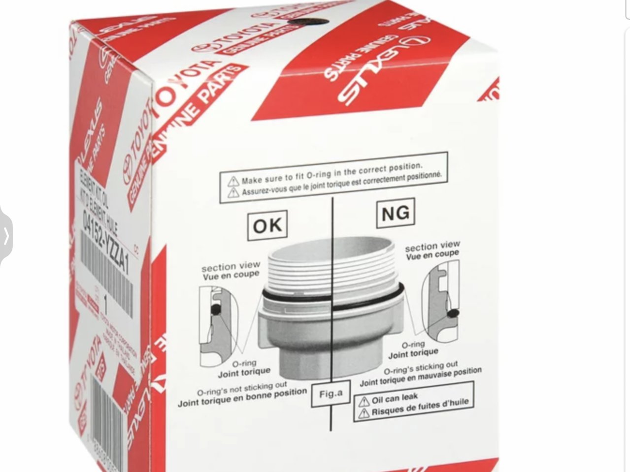

    I use a breaker bar to remove the filter housing and a regular length socket wrench to install. You can use a torque wrench but I just install until the housing comes to an abrupt stop. You need to install the large o-ring correctly. Just look at the diagram on the filter box. After a couple of oil/filter changes the process becomes easy to do.

    Don't beat yourself up too much. At least you remembered to put a filter element in the housing. Sometimes dealer techs forget.
    https://www.tacomaworld.com/threads/no-oil-filter.748693/

    This ^^ . Unless the o-ring was replaced properly, it will leak . You’re not alone if you messed this up.
