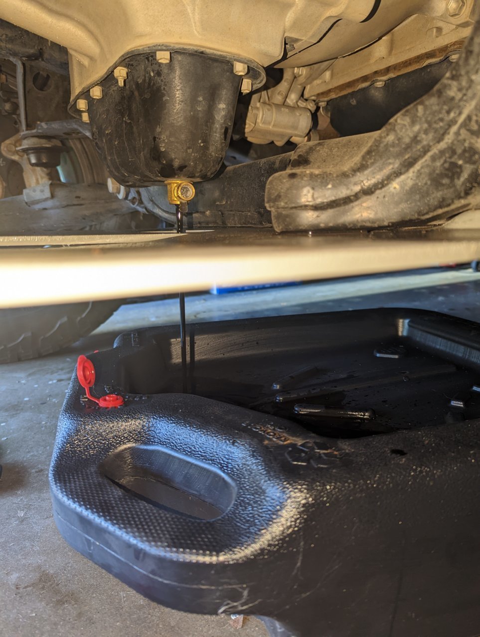

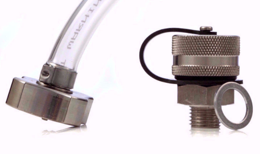

    Valvomax looks good too.

    Is that valve
  3. Mar 21, 2023 at 5:41 PM
    #23
    twtaco$
    twtaco$ Well-Known Member
    Aug 29, 2022
    #404660
    507
    Not sure what my above post said. But how long long have you had the above valve installed

    Valvomax needs the screw-on tube bit to drain ... unless you can use something like a nail-set to push the ball-bearing in. Fumoto you choose the rate by adjusting the valve control and can still use the tube.
    As I understand.

    About a year or so.

    Valvomax all the way. I have them on two other vehicles and have one in the garage waiting for the Tacoma (M12-1.25). They are a bit pricey at $50 or so, but you'll realize it was a good purchase the first time you have to change your oil. Never again dealing with the oil plug..... Outer cap comes off, screw in the tube fitting and watch the oil come down the tube into a container of your choice. YES, it takes longer to drain, but absolutely NO mess. The nicest thing about them is never again having to worry about the OEM plug, torque, etc.... as long as you install it correctly. The quality of the machined parts is exceptional from my perspective. I've actually had the outer cap off with the engine running on my 2004 Tahoe and there are no leaks. It's a fitting that doesn't open until you insert the drain tube fitting and screw it in.

    But what if you need to drain the oil and you do not have the special screw-on tube? Thin nail-set to push the ball-bearing and keep off to the side?
  13. Mar 22, 2023 at 2:26 AM
    #33
    Pungo1
    Pungo1 Well-Known Member
    Feb 18, 2023
    #418180
    188
    Mark
    I guess you could do that, but the trick is to not lose the drain hose with the fitting on it. You can buy those separately if you lose it. After I drain my oil, I put that fitting/hose into a zip lock bag and it stays in the vehicle it goes with.
  14. Mar 22, 2023 at 2:34 AM
    #34
    RichochetRabbit
    RichochetRabbit Bing Bing Bing
    Mar 6, 2023
    #419488
    6,154
    That answers it. Still need the special tool. Steel for ValvoMax, brass for Fumoto. Low profile protected for ValvoMax, high profile exposed for Fumoto. Special tool for ValvoMax, simple lever only required for Fumoto. Both an improvement over removing the oil-drain plug.

    These photos are the best!
    Thanks for sharing.
