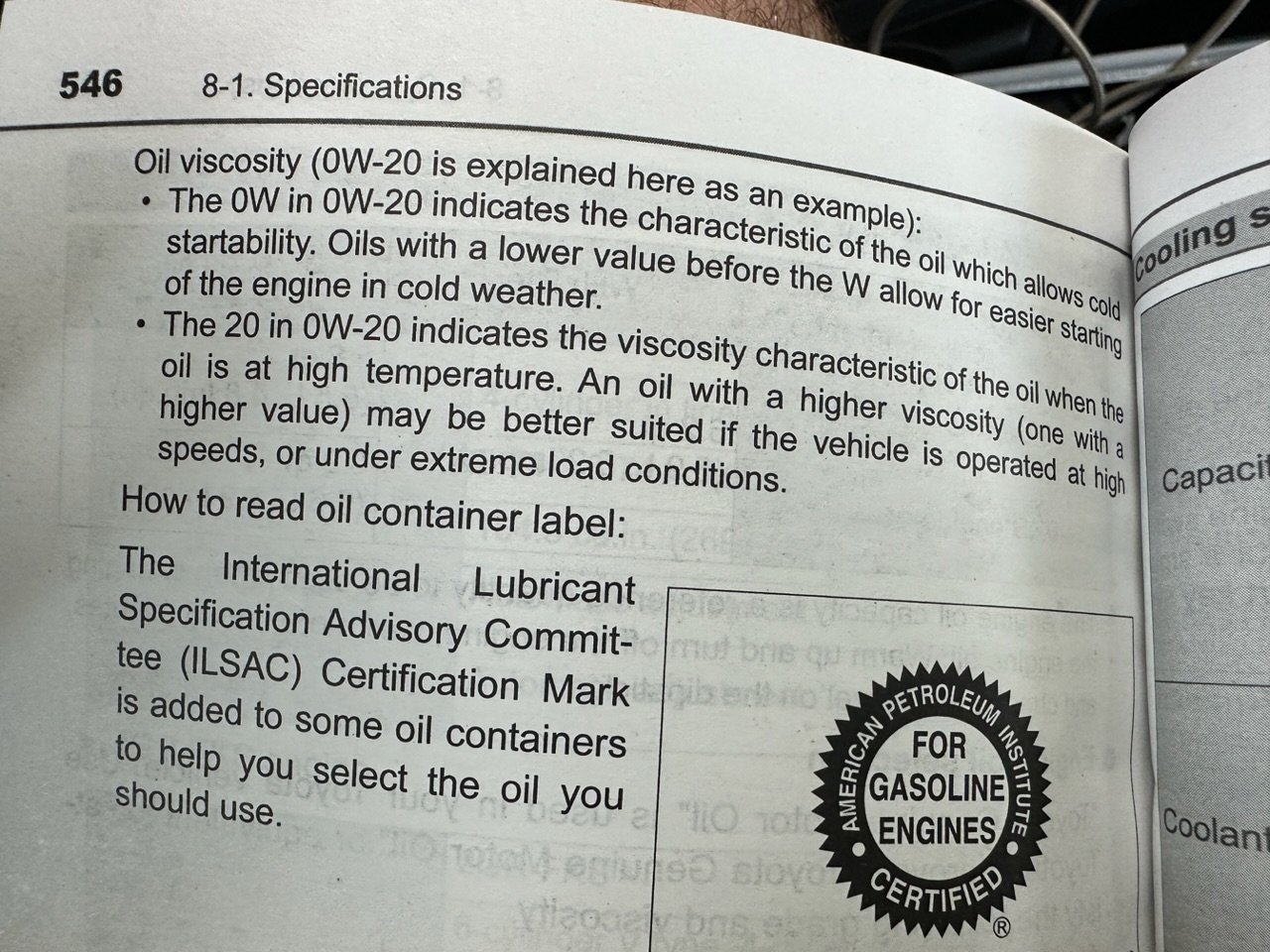

    By the way, look at the owners manual, 545 and 546. Bingo ladies and gentleman…
    Although the chart has been removed, the wording is still there referencing higher viscosity being more appropriate. Again, “engineers” saying 0w-20 is the end all is total BS. Oil becomes more thin as temperatures rise. If you live in a hot climate and especially if you tow, highly recommend going with at least a 30 or 40 weight. Mobile 1’s European Forumula is a great choice as its packed with anti wear additives.

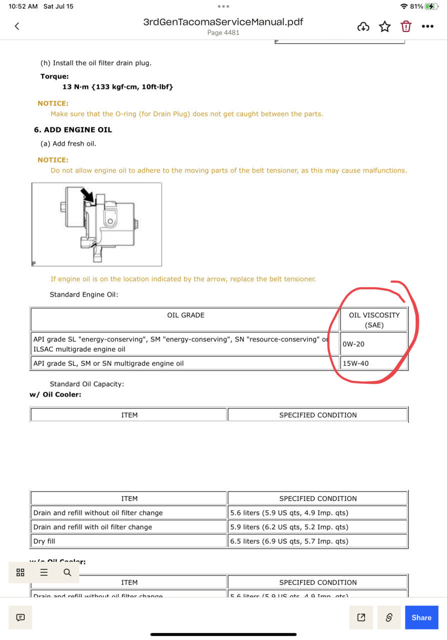

    I don’t want to be argumentative. After all, it’s just more discussion about oil in an oil thread. But I have to ask, why would the Toyota engineers list 15W-40 in their own factory service manual if it doesn’t have a use case scenario? I have a feeling 0W-20 is along the lines of fine for most but may not be the best. And it probably doesn’t matter often, but the fact that 15W-40 is literally in the service manual from Toyota begs the question.
    I’d say the same logic about samples could apply to the more viscous oils. They all have very good samples as well. 0W-20 is a fuel economy choice, which is fine for most. But does that automatically make it the best, just because it’s single-spec’d in the USA owner’s manual? Probably not.
    At the end of the day none of it really matters, but there is no harm done by choosing a thicker oil either and it may give some folks warm fuzzies if they run their engine harder than most. The vast majority of Tacoma owners I see drive like great-grandpa.

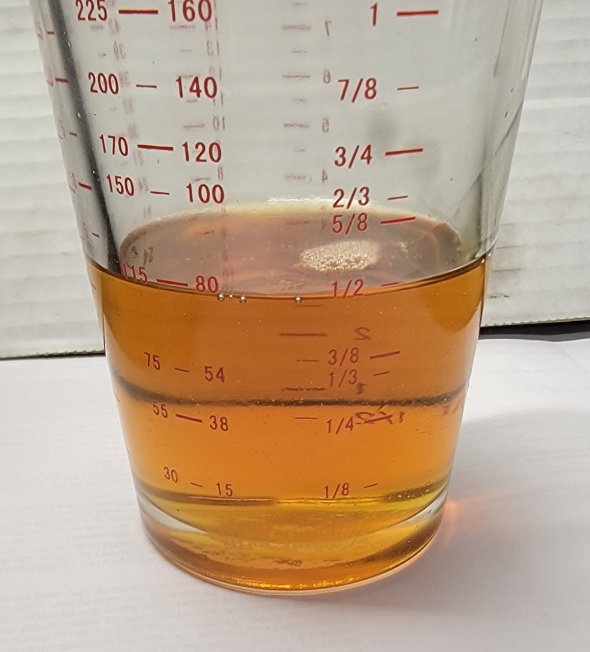

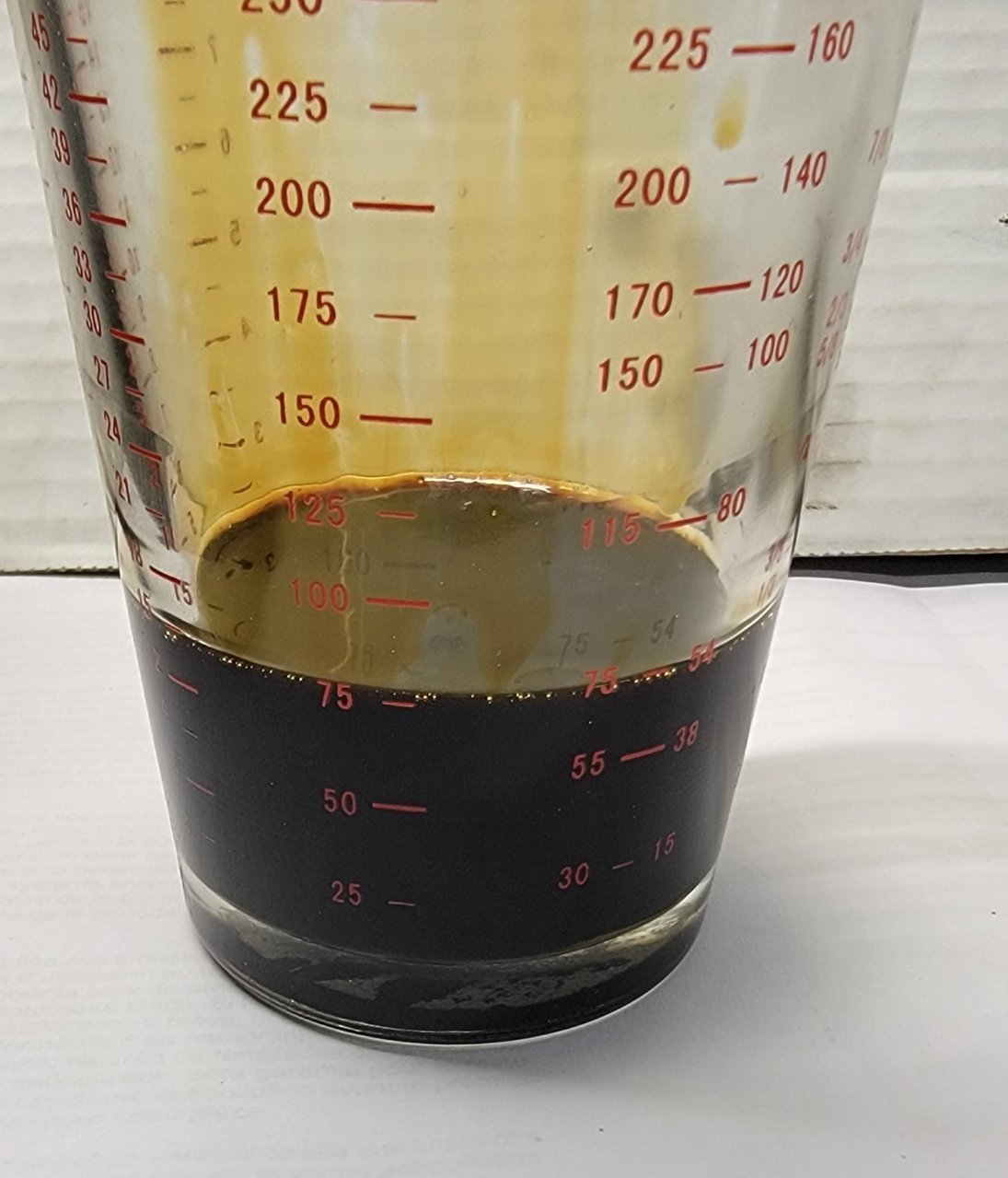

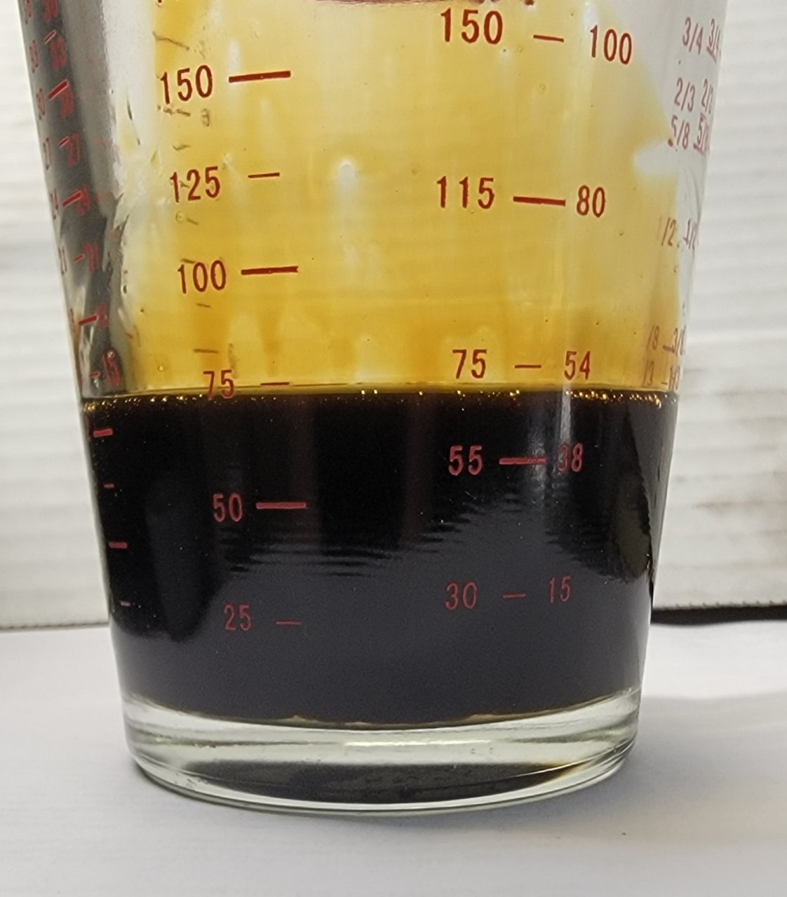

    I said I'd post pics when I changed my oil. My truck has 220,000 miles.
    New, "fresh" Walmart Syntech 5W-30 oil:
    Old Walmart Syntech 5W-30 run for 5,000 miles.

    Oil gets cooked nothing new here
  12. Jul 16, 2023 at 11:30 AM
    #192
    zoo truck
    zoo truck Well-Known Member
    Apr 21, 2020
    #325379
    8,948
    2020 quicksand sr5 tacoma
    None
    Definitely darker than my last 9.5k mile oil change. Looks closer to my brothers 5k oil change on his 00 astro van.

    Do any of you know why oil turns dark? Do you?
    TacoGeeloor likes this.
  18. Aug 14, 2023 at 4:52 PM
    #198
    TacoGeeloor
    TacoGeeloor Well-Known Member
    Dec 28, 2021
    #385704
    1,575
    Chad
    Washington State
    2020 TRD OR
    Heat cycles, contamination by particulate that the oil cleans from the engine and in some cases the additives added to the oils
    hiPSI[QUOTED] and zoo truck like this.
  19. Aug 14, 2023 at 5:07 PM
    #199
    zoo truck
    Apr 21, 2020
    #325379
    8,948
    None
    Another words oil gets dirty.
    TacoGeeloor[QUOTED] likes this.
  20. Aug 14, 2023 at 5:15 PM
    #200
    Vlady
    Vlady Well-Known Member
    Dec 20, 2017
    #238986
    4,619
    Issy, WA
    2017 White SR5 DCSB V6 4x4
    Process of oxidation..
