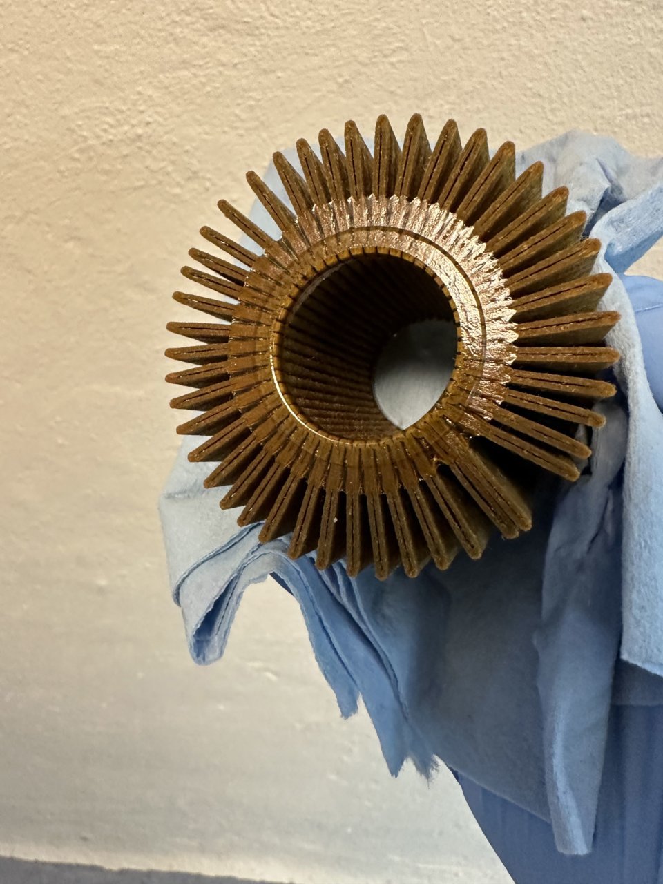

    To answer your questions, I just added a picture of the filter and it had the same smell of gas but was not dirty like the oil. I was expecting it to be filthy but it wasn't. Not a single bit of metal or dirt in the filter. I just changed the oil yesterday and only drove it 5 miles to get the engine up to temp and to make sure I didn't have any leaks. Oil looks new and doesn't have a smell on the dipstick but I'll update as I drive more.
    I am waiting on the Blackstone sample bottle so I just collected in a glass container for now. That's how I noticed the black oil. Maybe it's not needed but I'll say this, had I not done a break-in oil change and collected a sample, I very well might not have spotted this issue. Wait a minute, is that good or bad...
    I'll be sure to post the results.

    Nice. :thumbsup: Filter looks good, although if you can actually see metal trapped in the elements there's a much bigger problem. ;)
    Blackstone is the gold standard for the industry. They handle everything from autos to aviation. You'll receive a questionnaire and they take everything into account including engine age and mileage. You'll get an honest and clear report about what's going on inside. The report I received was six pages long and it included all of the results as well as associated industry tolerances. As the saying goes, it can't hurt. Very inexpensive peace of mind.
    That 1st Gen Tundra I had tested was pushing a quarter-million miles and surprisingly (or maybe not) everything was still within expected tolerances for its age and mileage. Although there can be a bad apple, we've stuck with Toyota and Lexus for decades and have never been disappointed.
    You're doing everything right and odds are there's nothing wrong, but as others have said, documenting it is the way to go.

    Your eye cannot see the debris that will cause damage so change the filter. Also, @Bishop84 is the guy I would ask about the dark gas smelling oil at 1K miles.

    Note that Amsoil says acceptable fuel dilution is up to 2.4% in gasoline engines: https://blog.amsoil.com/what-is-fuel-dilution-and-why-is-it-bad/
    In a 5.5 qt oil fill (176 fluid ounces,) that would be as much as 4.2 ounces of gasoline.
    That's a lot of fuel. Just because there's a slight odor of gasoline in the motor oil doesn't necessarily mean there's a problem. My 70K 4.0L 1GRFE engine oil smells slightly of gasoline all the time. Compression & leak-down tests on all cylinders are normal & good. It doesn't burn a drop of oil between changes, nor does it leak/consume any coolant. Fuel economy is normal, no engine codes. I use 87 octane COSTCO gasoline, Kirkland (Costco) brand 5W-30 synthetic motor oil, and OEM oil filters with a 3-4K OCI. New filter every oil change.

    Fairly normal for oil to smell like fuel.
    This is way too low of mileage. Send it off to blackstone to be sure but there's no reason to be worried or to continue such short intervals.
    Colour is not an indicator of oil quality. This one is dark, but is likely fine.
    If an injector was leaking these trucks would flip a code quick.
