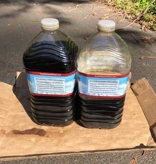

    Just purchased the truck 3 weeks ago. Followed break-in instructions for the first 680 miles and changed the oil at 1k which is when I discovered the black/gas oil.

    For a second reference point, here is what my oil looked like at 1500 miles and 6 months. Might not be molasses black like the OP but definitely on the black scale. Did not notice gas smell nor too time to sniff it.
