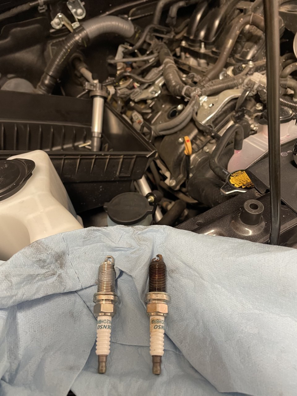

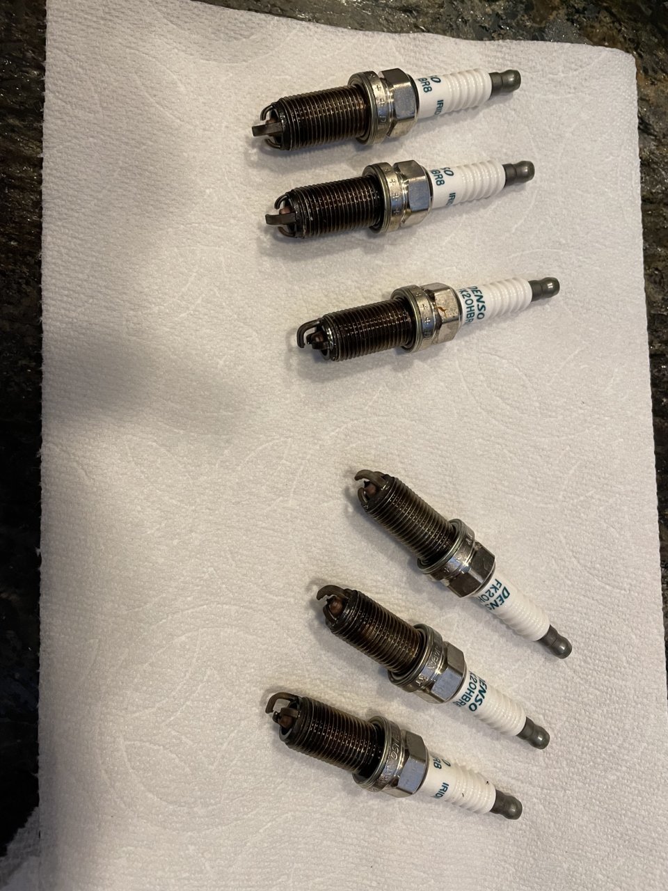

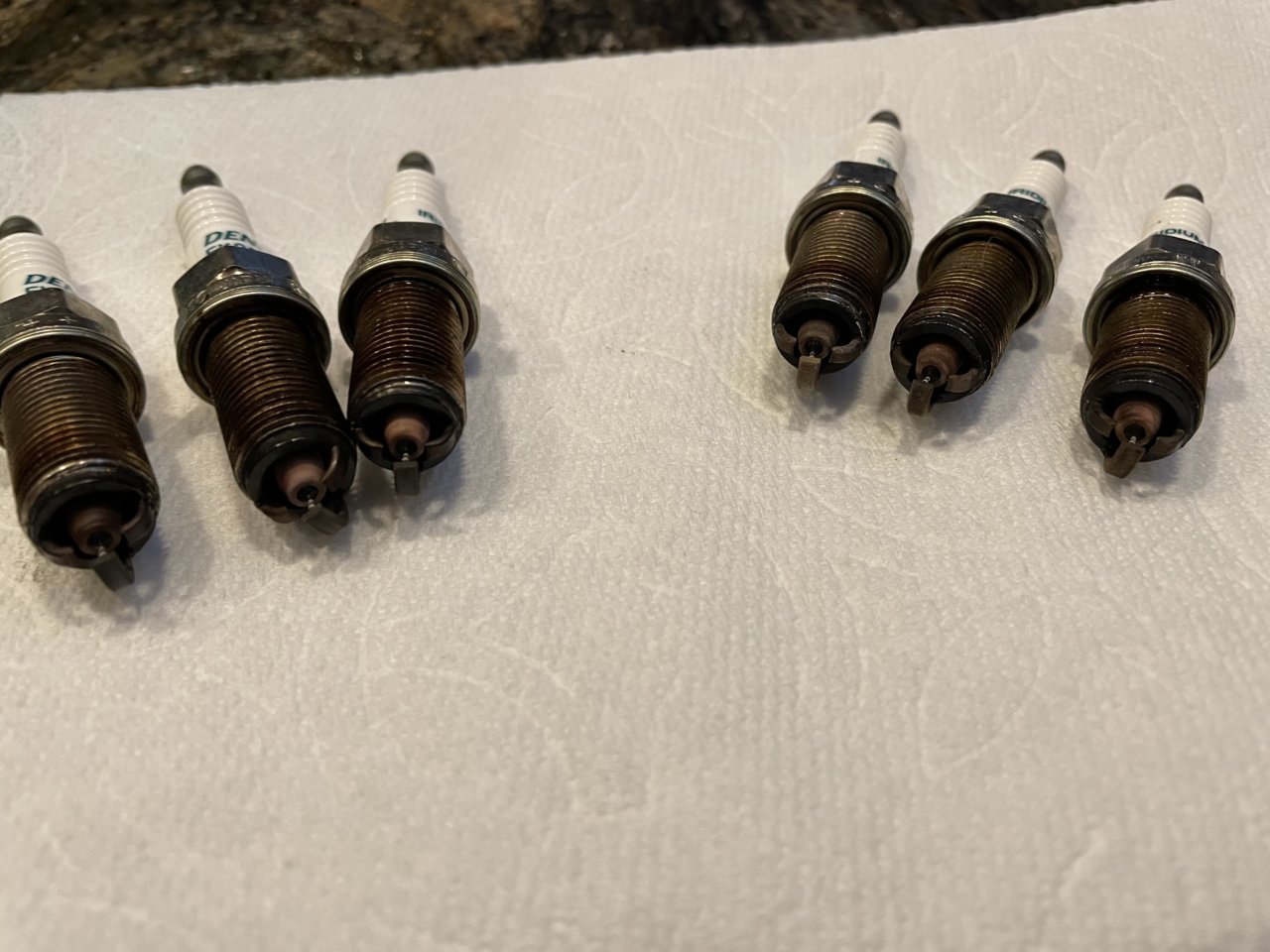

    I decided to service the entire truck at 20k, because by then it was/is 6.5 years old and I live in AZ where summer temps are brutal on vehicles. The entire service with oem parts/fluids wasn't that expensive as I did the work myself. Plugs were only around $100. As I mentioned, I discovered the passenger side plugs were loose from the factory. Here's some pictures of the old plugs at 20k for fun...

    Ah I didn't catch the 6+ years old. That makes a bit more sense. Plugs actually look pretty good still. Looks like different plugs?

    Same oem plugs.
