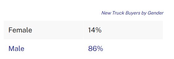

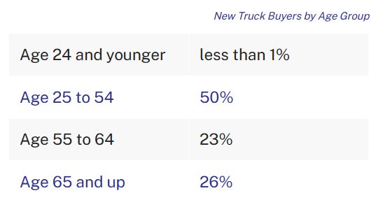

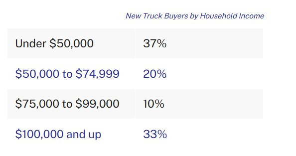

    Good answer, but here is a more granular look at truck buyers:
    When I was young, just starting out, I could barely afford my 10 year old vehicle, I only dreamt of a new one.
