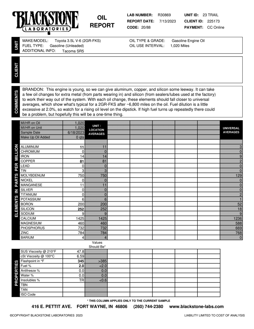

    Just got my results a couple hours ago... "If high fuel turns up repeatedly there could be a problem, but hopefully this will be a one-time thing." o_O
    The problem with results is that they mean nothing if you have nothing to compare. Guess I'll have to keep driving and testing to figure out if something is wrong! Ha. Truck is still a baby, 1750 miles with zero driving issues or warning lights. I've been sniffing the ol' dipstick more often and it still has the fuel smell but oil seems cleaner on the rag. I don't know if it was a good, bad or ugly thing to change the oil at 1k as it prob gave me nothing but extra worry however, it lead me to learn a lot more about the truck. Pros and cons I suppose.
    Curious how my results stack up with any other Tacoma after 1k miles.

    Good to know and their advice seems solid. Plus you're right, without a "before" you can only measure yours by the averages.
    The two key measurements, at least with respect to too much fuel in the oil, are the flashpoint, the point at which the oil will ignite, and of course the fuel percentage. Your oil's flashpoint looks to be pretty good to a little high and the fuel percentage is right at the uppermost limit. Bottom line? You have a good nose. ;)
    My take would be that things are probably normal, like others have said, for a new engine. Per their advice, I'd keep an eye on the oil level and then probably run another test after your next oil change. I'm betting you're good.
    Thanks for reporting back and keep us posted!

    Thanks for the positive feedback and emotional support during this trying time :) I think the truck gonna make it and I don't have to scrap it just yet. That black oil at 1k threw me for a loop but you can't argue with the results. Guess a little girl scout juice never hurt nothing!! Blackstone might as well send me a few more free testing kits cuz I'm gonna need em'

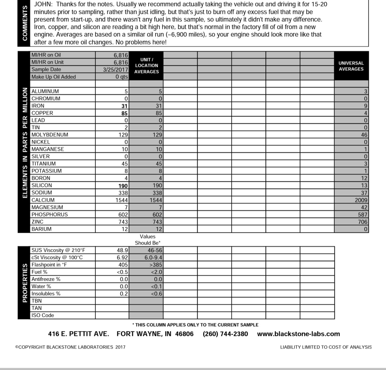

    Here's the report on my truck's original oil after 6900 miles for comparison

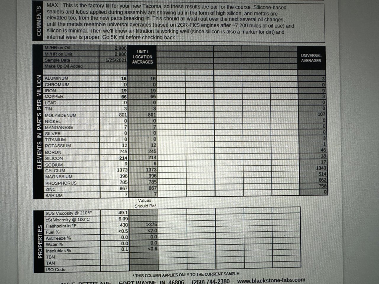

    I put them in another thread I think. Jesus that 2% fuel is no bueno. Haven’t seen one that high

    Yeah, seeing the "Hopefully, this will be a one-time thing" from your engine oil analysis at 1k miles isn't ideal. Then again, it's still within the values right at 2% so not much I can do but keep driving and check back in a few thousand miles.

    Are you guys driving your truck and getting the oil temp up to burn off any extra moisture or fuel in the oil before sampling?
    Even just starting your truck cold and moving to the other side of the driveway to change the oil can throw off your fuel %.
    While sending in oil samples of the first few thousand miles is nice to establish a baseline, it's just going to freak you all out on your new truck when the wear metals and silicon are high from break-in. Blackstone is going to tell you it's all normal for a new engine and to check back after a few oil changes once the engine has had time to break in and you've changed the oil a few times to flush.

    If you change your oil right after a 200mi continuous road trip and send that to Blackstone the fuel % won't be that high. I think your truck is fine, it's just going through it's normal break-in process.
