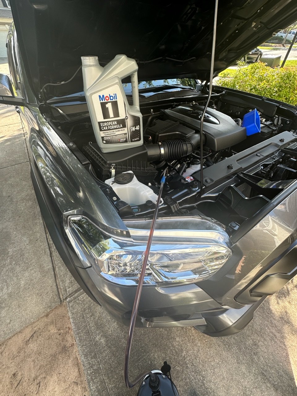

    Why 5w-40 instead of 0w-20? I used to use mobil 1 for decades. Switched to Valvoline. :popcorn::stirthepot:

    One of my favorite oils is mobile 1’s European formula. It’s also what Porsche uses, fantastic stuff with a lot of additives. Our engines are rated up to 15w40. I live in GA and the summer is hot. 0w20 is CAFE / MPG oil and does not protect as well against engine wear and fuel dilution.
    https://www.machinerylubrication.com/Read/518/motor-oils

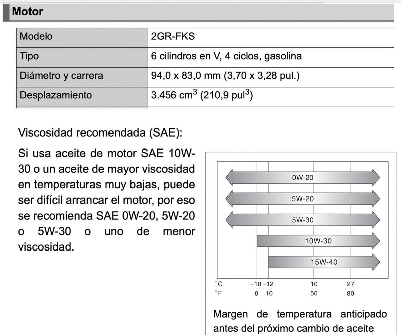

    You have that backwards. Look at the cart I posted. The first number in the oil rating is cold viscosity. The second is hot. But a 5w or 0w -40
    Is ideal for any climate. 5w is rated to -30c

    You do realize that 0W-20 is CAFE / EPA based and not engineering based, right? Why does Toyota recommend this weight only in the US? I suggest you read the article I posted, if not already, and you will get some insight into why this is happening. And no, in hot climates and under load it is not a smart plan to use thin oil.

    Again, you are not addressing the obvious point I’m making. Buy the truck in San Diego and no oil chart, buy the truck in Mexico 15 min away, oil chart. Like beating a dead horse. Must be those Mexican engineers… lol
