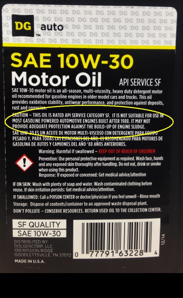

    I was getting a good price on this from Dollar General but... SF rated

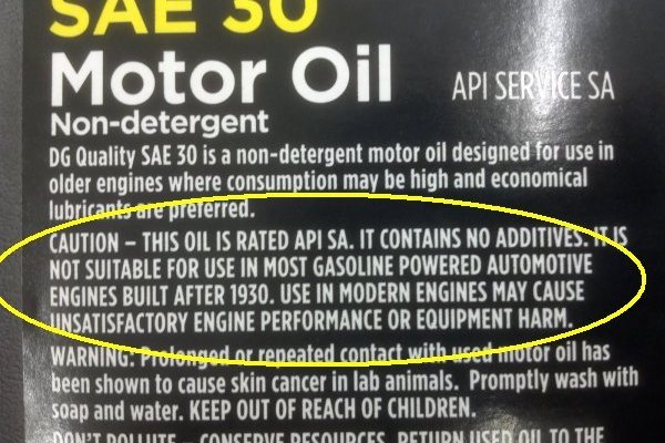

    30 weight SA rated...

    I know you posted in jest but straight 30 has a lot of applications in industry... just not in modern engines lol.
