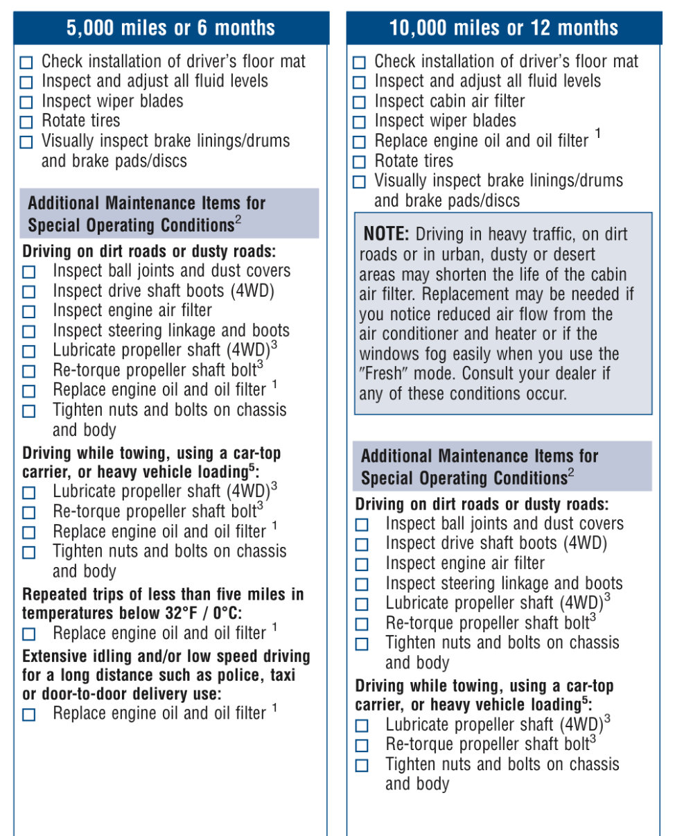

    Oil changes every 10k miles (16k km) per the Owner’s Manual:

    Thanks for the quick reply
    I could understand that distance after the first one but... okay

    My manual suggests 10K or 6 months for "hard use" which driving in slow traffic qualifies as hard use. I plan on having the oil changed every 6 months regardless of mileage.
