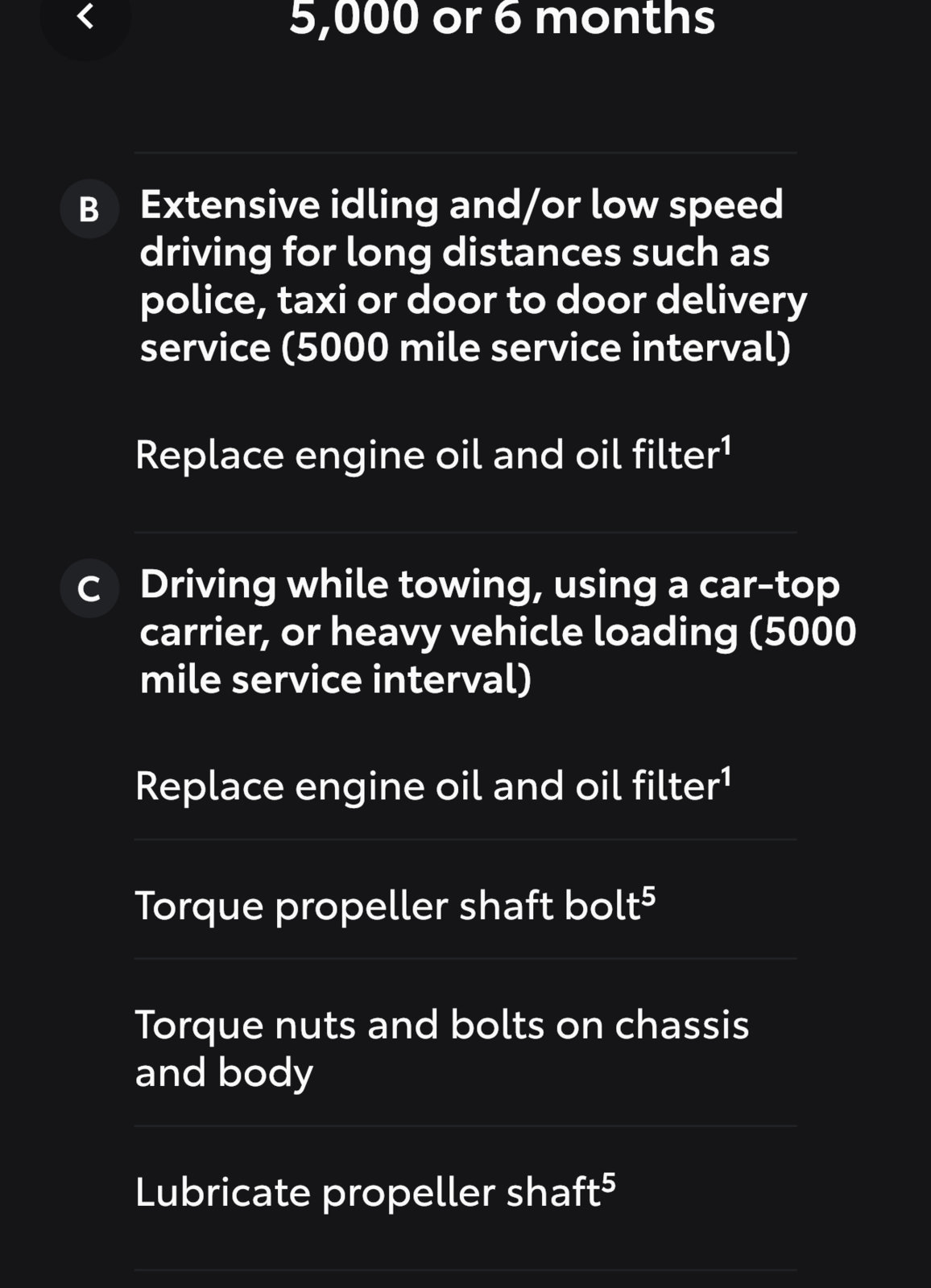

    You guys are right, most dealers are dumb as box of rocks. Attached is from Toyota. 5k OCI’s is absolutely recommended for many conditions. Guess what, if you spend a lot of time in traffic or drive a lot of short trips, you qualify for 5k OCI’s NOT 10k. I don’t blame you guys for being pissed at the level of ignorance.

    Luckily dude I met understood and didn't argue with me. It is exactly your money and your engine, you go there for service and if you decide to pay, they need to do it. Mine took roughly 2 hours for 5K service + oil change.
    lol dude I saw this too, and was surprised how they had no idea of this. I live in NJ, there is always traffic here, takes me 1 hour to cover 15 miles from work to home everyday, there is no way I am going for 10K oil change. Only people fit for that are ones who live somewhere in far country with no snow, no dust or traffic with perfect road.
