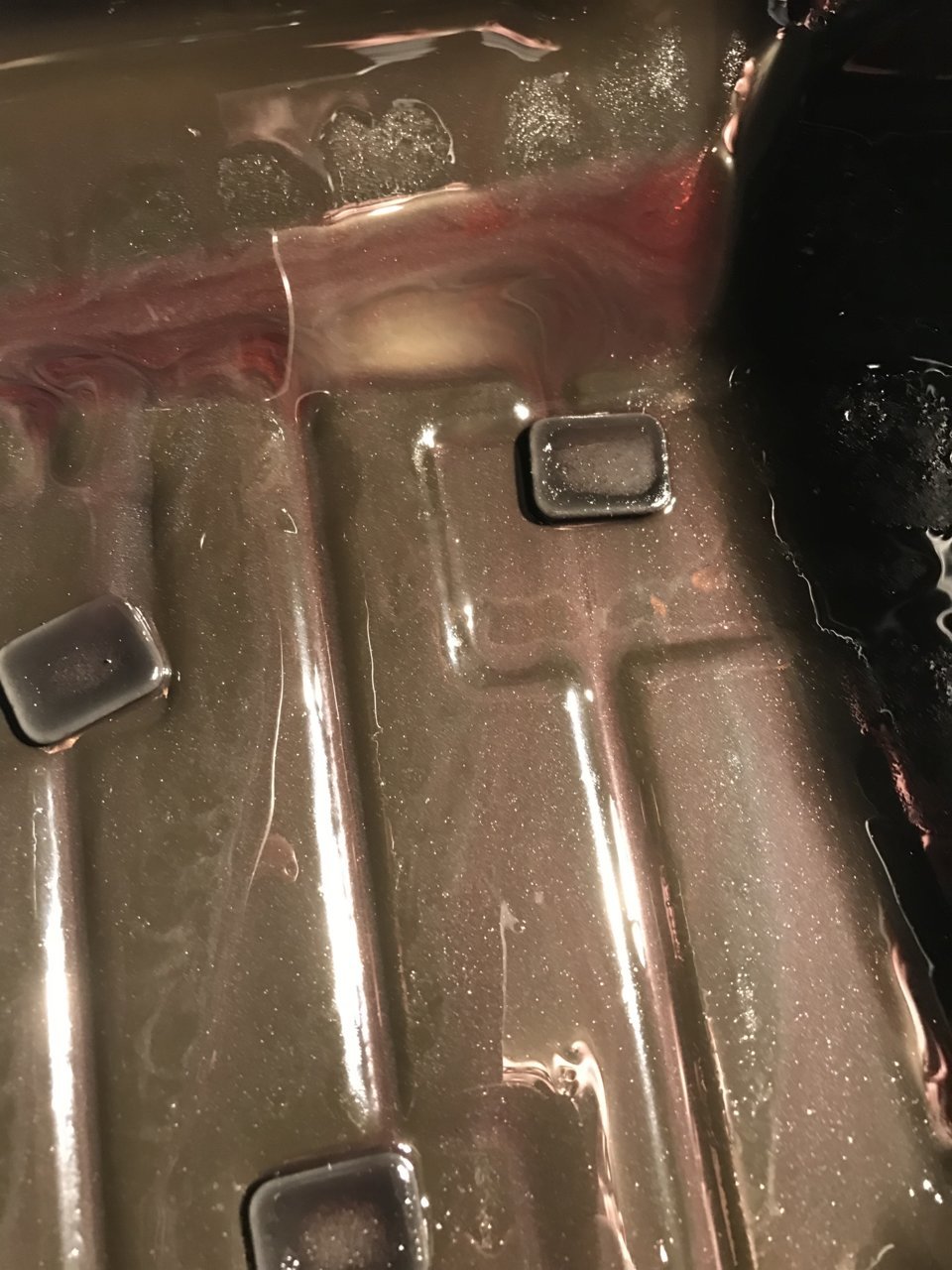

    Dropped the pan and I have some metal dust. What do y’all think by looking at the pics?

    Damn, and that’s after you drained and refilled. Almost like it just happened.

    Those specks of alluminum laying in the pan are enough to jam a spool valve in the valve body .
    Do your resistance tests on your pending codes to see why the computer in your truck keeps setting the codes but at this point , I think you have a stuck valve which would require carefully dropping the valve body .
    Send me a pm . I have some books for you

    Sorry all, I’ve meant to post an update several times.
    My issue was my pressure control solenoid. I swapped it out and she’s been shifting perfectly.
