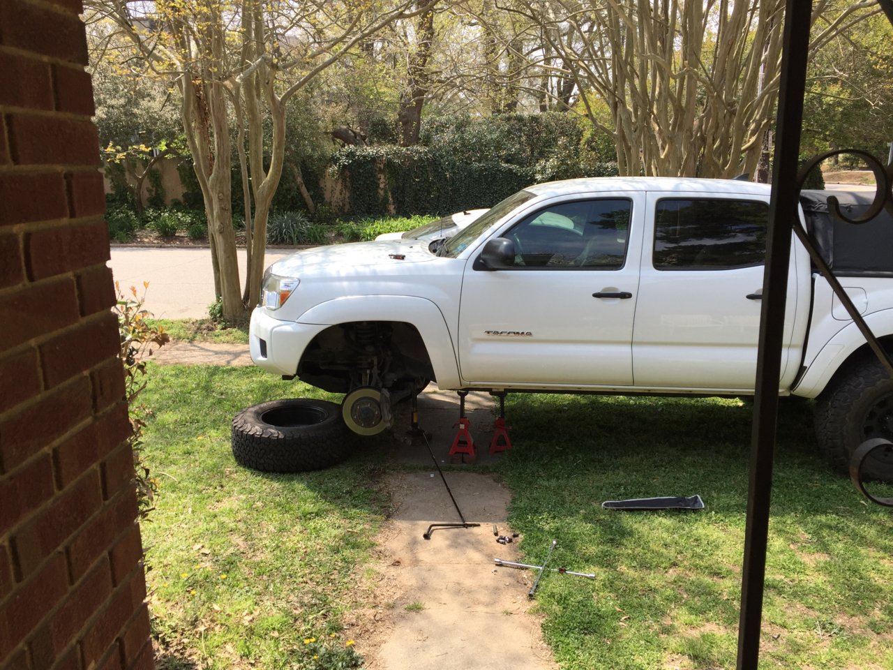

    Finally got around to installing it in my front yard (lol) and I’ll post some pictures for how it went. I definitely recommend getting the puller from ECGS and a new seal just in case (learn from my mistakes). Anyway I did the install with the method of just removing the lower knuckle bolts, and not removing the axle out of the hub or any of that nonsense. So here we go:

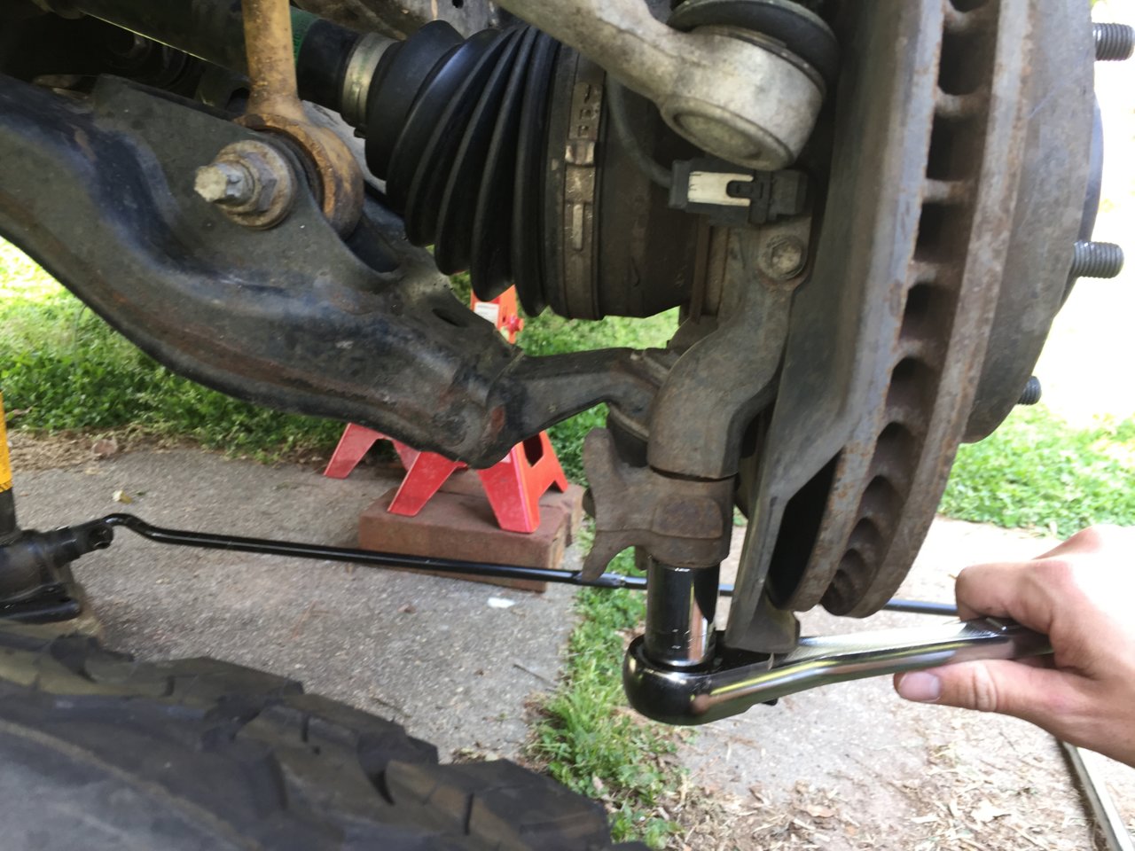

    Taking off the two lower knuckle bolts:

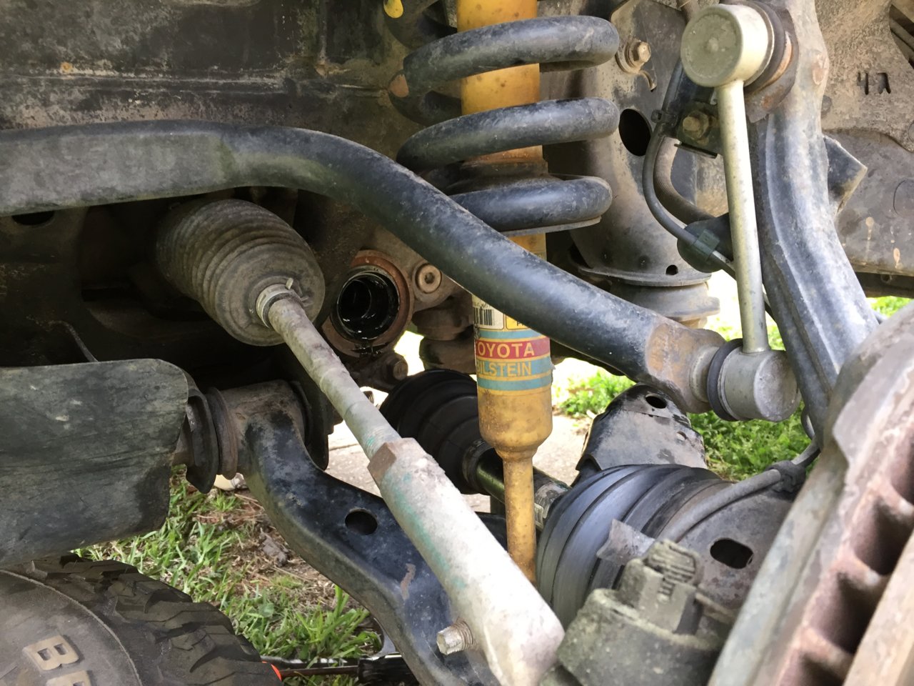

    Used a large flat head screwdriver and mallet to pry/push out the cv axle while my buddy helps by pulling and twisting on the rotor/hub/axle assembly from the outboard side. This was definitely a slight challenge but it really helped having the prying of the axle on one side and the slamming it from the mallet/flathead on the other.

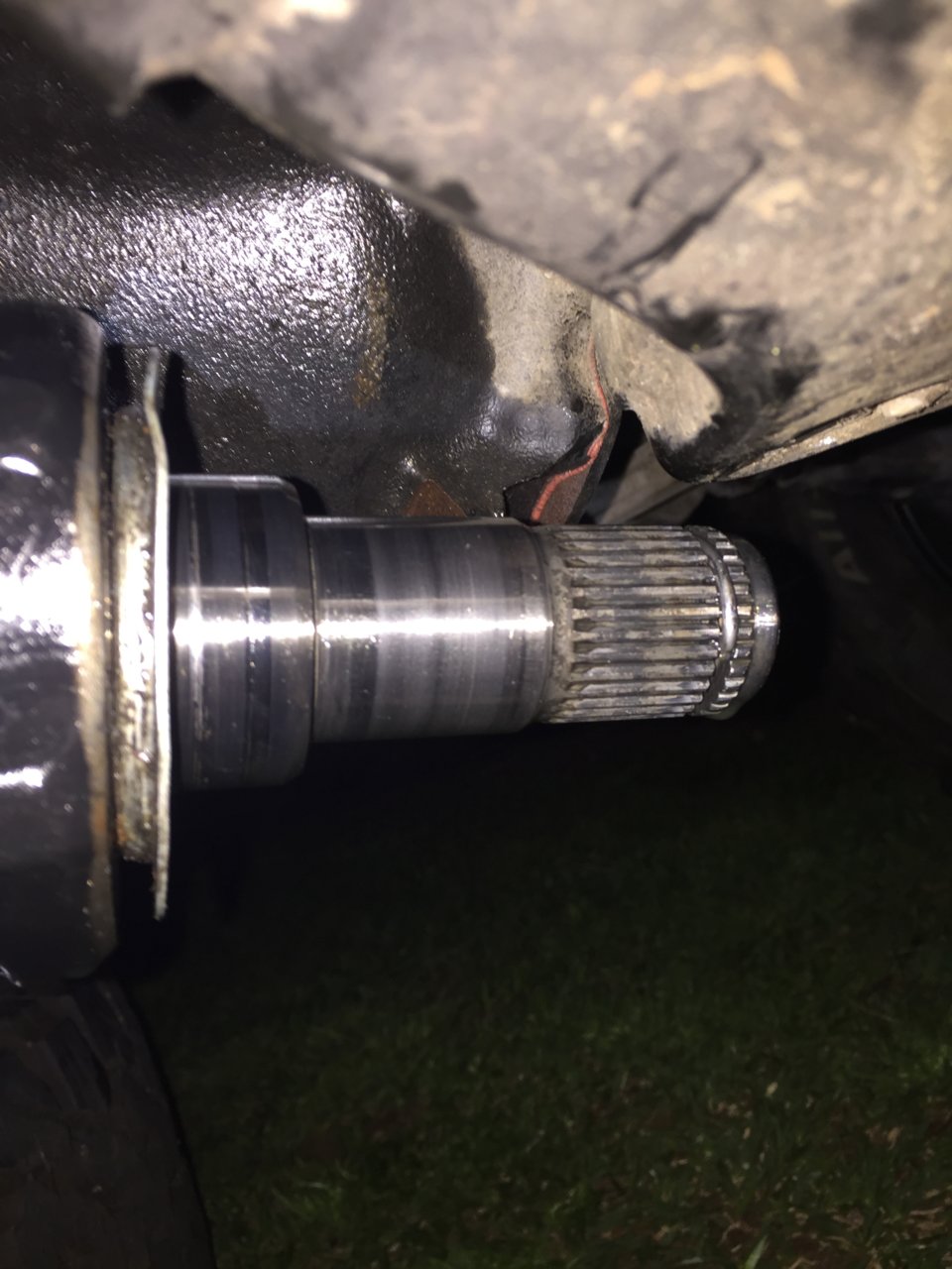

    This is how the axle looks after probably 10k of miles with the vibration:
    Definitely doesn’t look great but we’re just gonna send it, and I’ll let yall know how it works out.

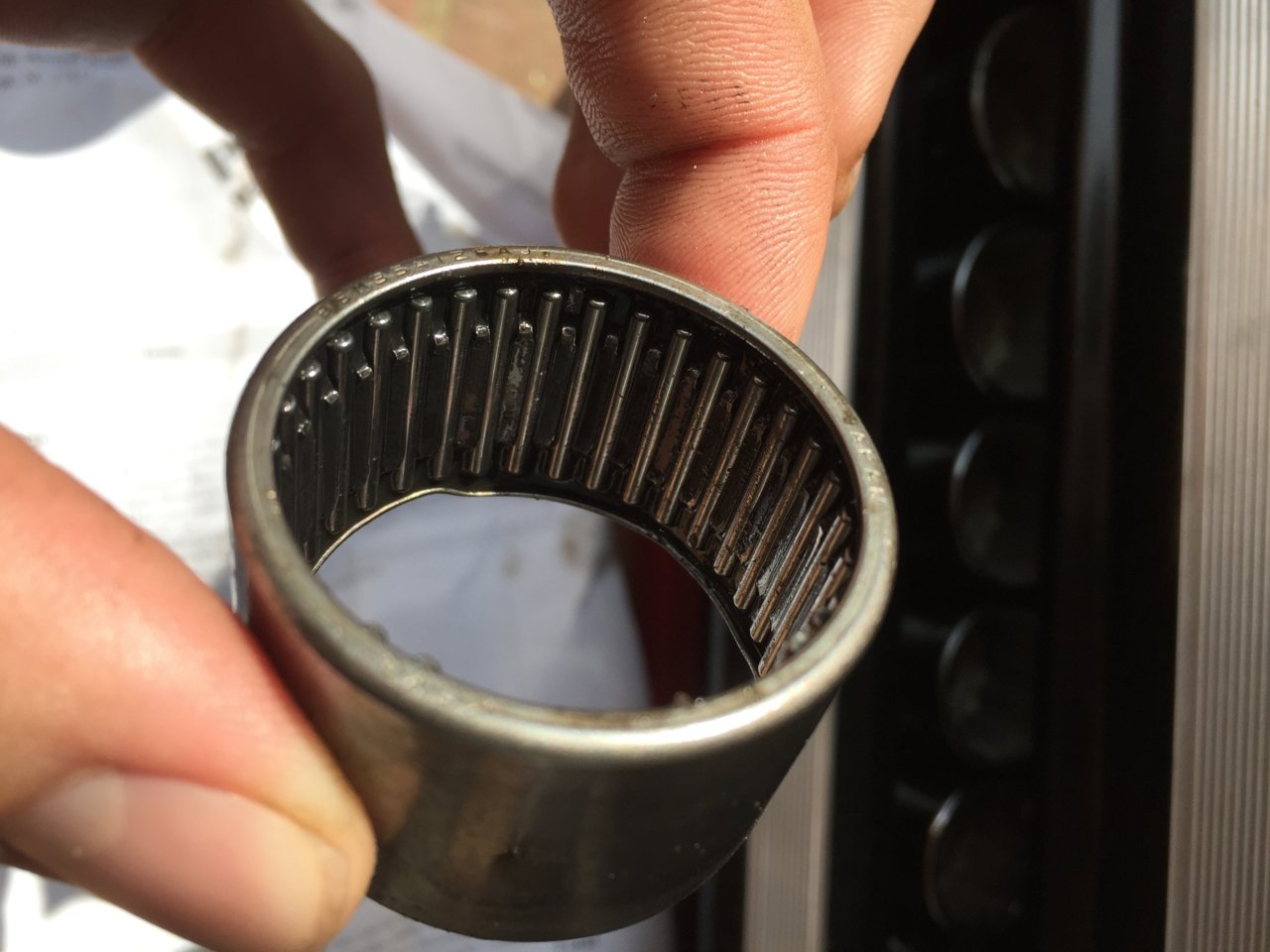

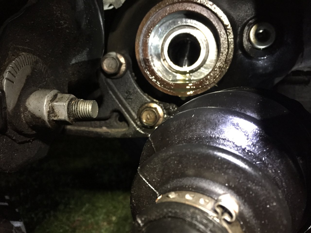

    Pulling out the bearing was relatively straightforward, just make sure you put a bag or something inside the diff so you don’t lose anything in there… Also make sure you are pulling the bearing as straight out as possible.
    Now … putting the new ECGS bushing in was the part I struggled with the most. Although there was plenty of room to get the cv axle out of the diff and remove the needle bearing, I felt like I could’ve benefited from more room when installing the new bushing. It was very tight going in there and required some pretty significant force to driver her in, which was very hard considering the tight space to swing anything around in. I made sure to drive it in straight at the beginning, but still struggled to get much progress after getting it started. About halfway through I was worried I was going to mar the edges of the bushing, but I said screw it and kept pounding (with less and less caution haha…). I finally got it in, or at least as far as I thought I could get it. It is near flush but definitely sticks out a bit.
    Anyway… Slam the CV axle back in (was a little harder than expected I guess just because the clearance is so tight now and I also don’t think I had the c clip facing down… But once you get it going you will feel it bottom out or click into place. Then used another jack to push up the lower control arm and bolted the lower knuckle back together (wanna say like 118 ft-lb but double check the manual). I also used blue locktight. Then filled her up with diff fluid. About a 6-7 beer job.
    Well I took her for a drive (no vibrations anymore so woohoo!) but turns out I must’ve really messed up the diff oil seal because she was dripping diff fluid pretty good when I pulled back into the driveway…
    So a trip to the Toyota dealership and I got the new oil seal (47012 part #). Annnnd pretty much the same steps as the day before removing the lower knuckle bolts then the cv axle and then finally pried out the crappy seal with a flathead. Gently tapped the new seal in and we are leak free baby! I will keep yall posted on if I have any problems with this in the future.

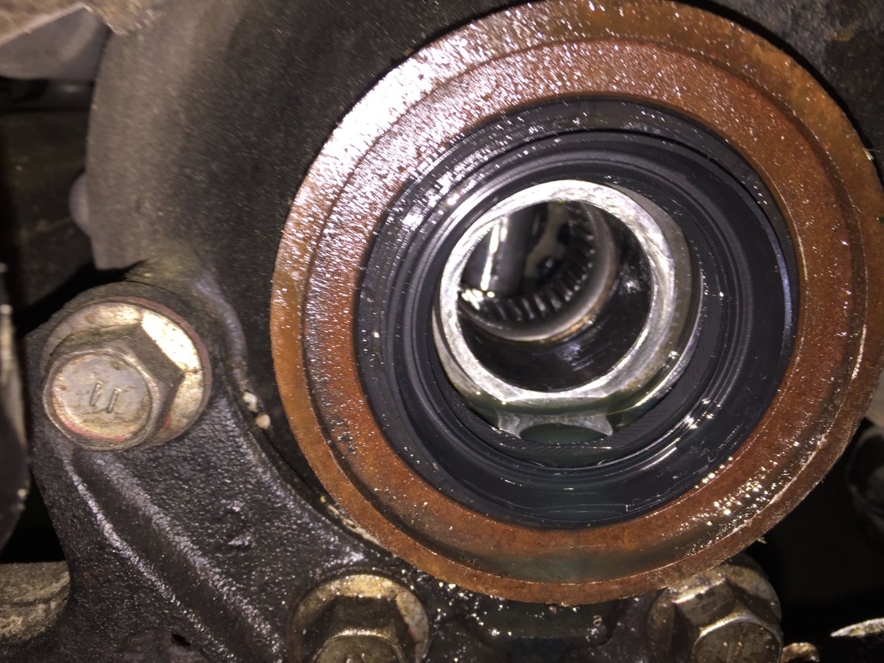

    Old seal out:
    New Seal In:

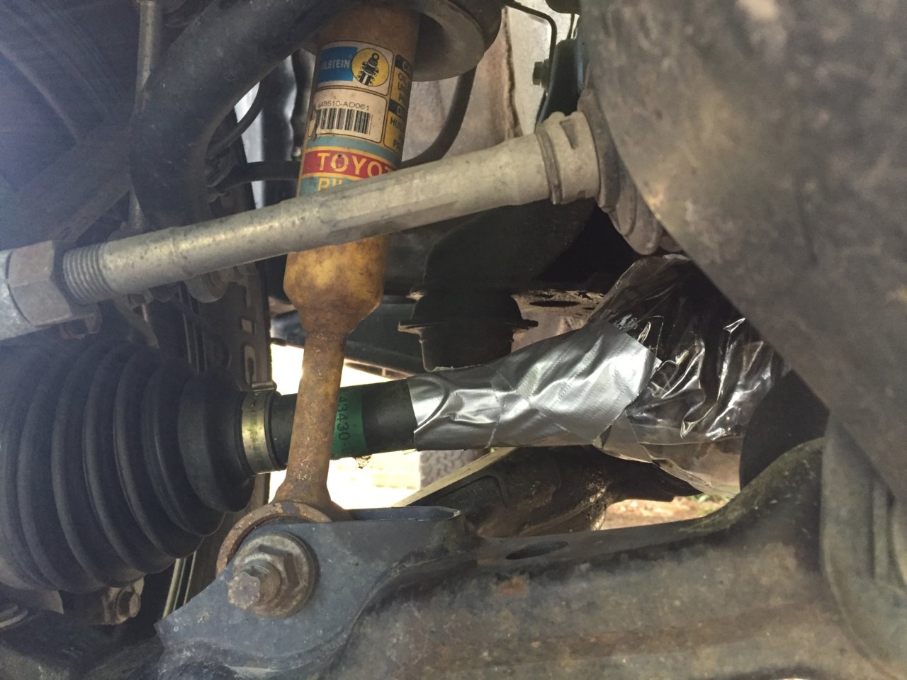

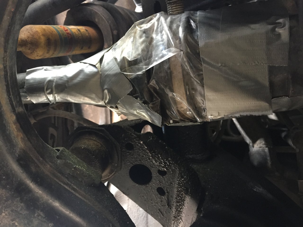

    When I was under the truck working on the driver side bearing, I noticed that the passenger side CV boot had a tear in it and had ejected quite a bit of grease. Was definitely pretty mad to see this since I just did all that work on the driver side.... So I did some research on some redneck fixes for this and came up with this:
    Just got some heavy duty Ziploc plastic bags and wrapped them around the boot/axle and taped it up with duct tape hahaha…. Been holding up so far so good for a week or so of driving. Yall laugh if you want, but we’ll see how long she lasts!
