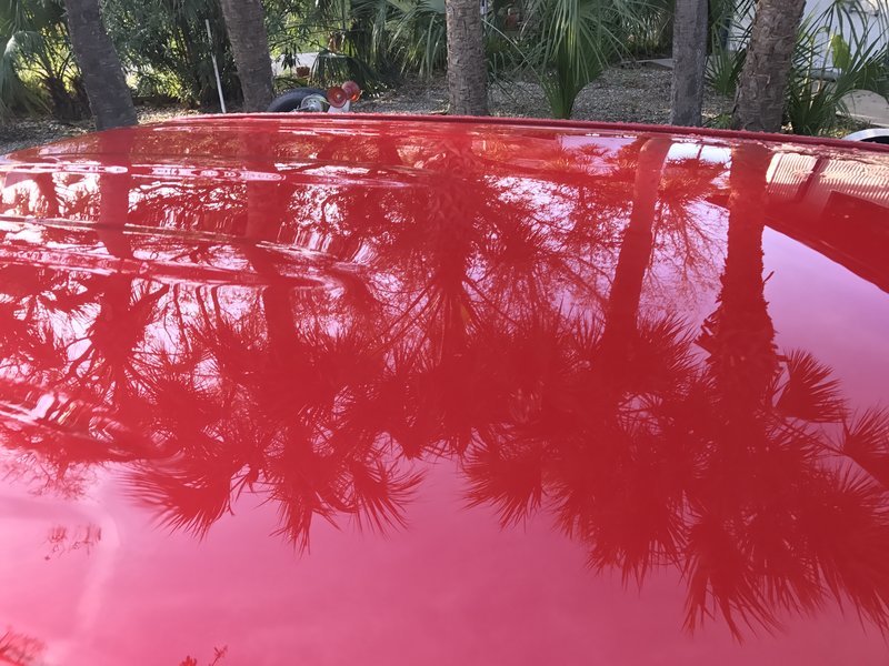

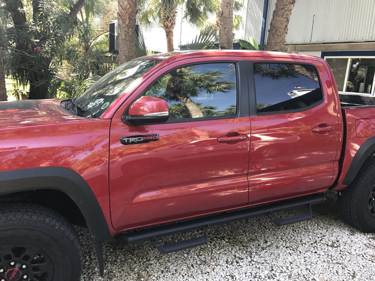

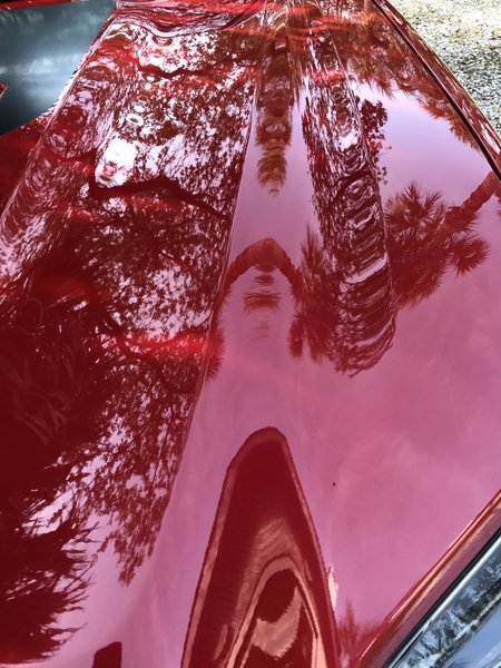

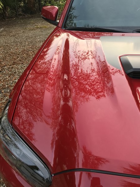

    I traded a black Tundra for my Tacoma Pro about a month ago. Black as pretty as it is the factory finish always ended up with swirls that drove me nuts. Not to mention the water spots from the salt, chemical filled rain we get around New Orleans
    I started researching and had almost decided on Ceramic Pro. Once I got the quotes 600-1700 I decided to look for something I could easily accomplish. After countless hours on autogeek and the sister site autopia I decided on using the Polish Angel products. I ordered the Cosmic V2 kit and high gloss spray
    All the reviews I'd read spoke of the absolute ease of application. I found this to be completely true. Since it was almost perfect weather yesterday, mid 70's low humidity, slight breeze (rarity for me as I live on the water) I decided to treat the truck. I had already experimented on the fenders of my motorcycle so I'd have a feel for application
    In all. It was one of the simplest things I'd done (scale of expertise varies from wet sanding my badly oxidized boat to normal wax application). The wait times between applications is the hardest. I was doing single panels at a time to keep clock to really. I still have bumpers and roof to complete. Bumpers have more orange peel and require a bit of correction with the DA. I will update periodically to how it's holding up. Advertised as an 18mth to 2 yr product. I'm also using the Wolfgang exterior trim sealant on the black moldings

    Looks awesome. Take it easy on the orange peel. Don't aim for 100% correction. It could save you some life on the far end. That's my two cents when it comes to daily drivers.

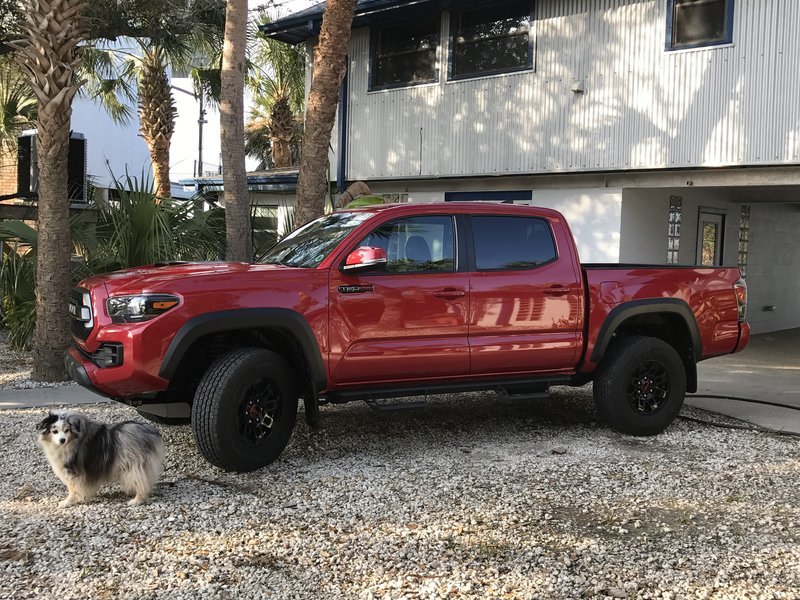

    To put reflective distance in perspective
    The palm tree (drivers door) is about 25' away. Same one that is in the hood picture (35' tall and 20' away in the pic)
    The windows (rear door) are close to 35'

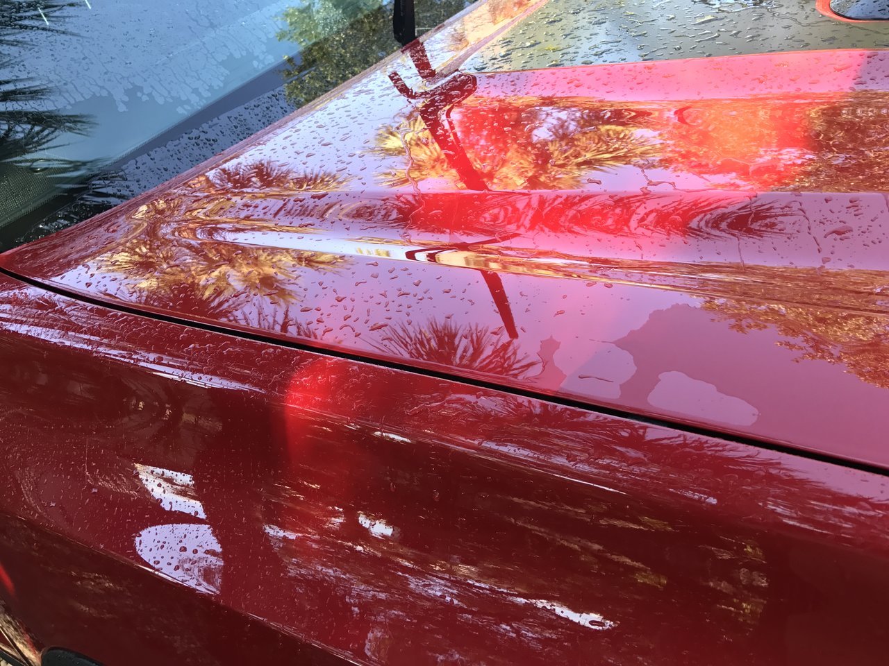

    1mth update

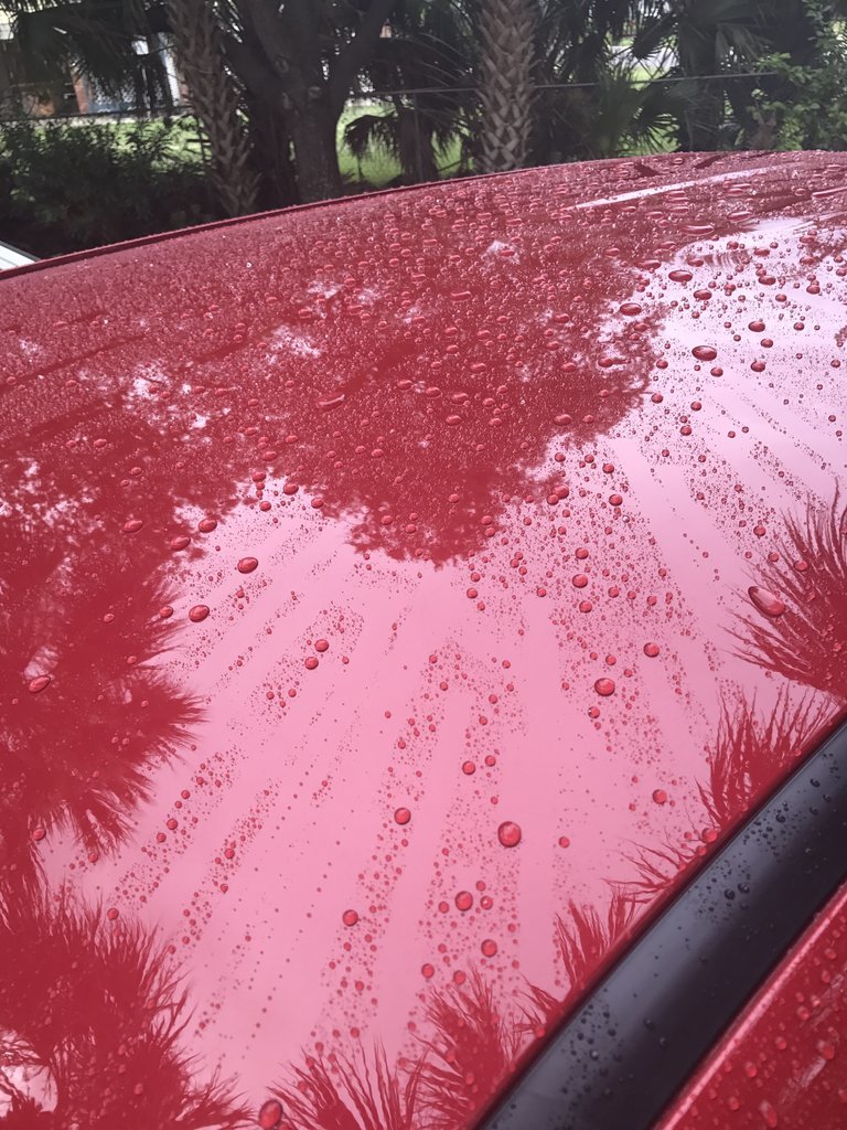

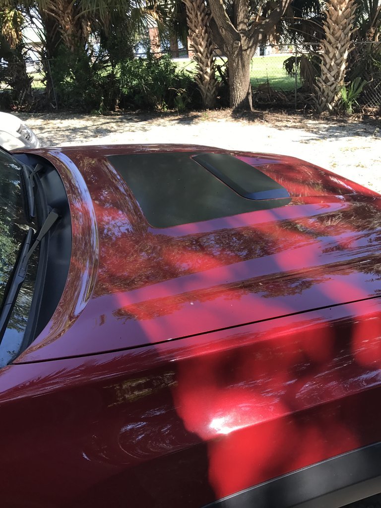

    I purposefully did not wash the truck for the first month. Just let the rain rinse the truck (except once). We have had a heavy pollen laden early spring. I have 3 live oaks on my property so often in the morning the truck was yellow, I rinsed it with the hose one morning it was so bad.
    I have yet to finish the roof and bumpers due to not having optimal conditions over a few days

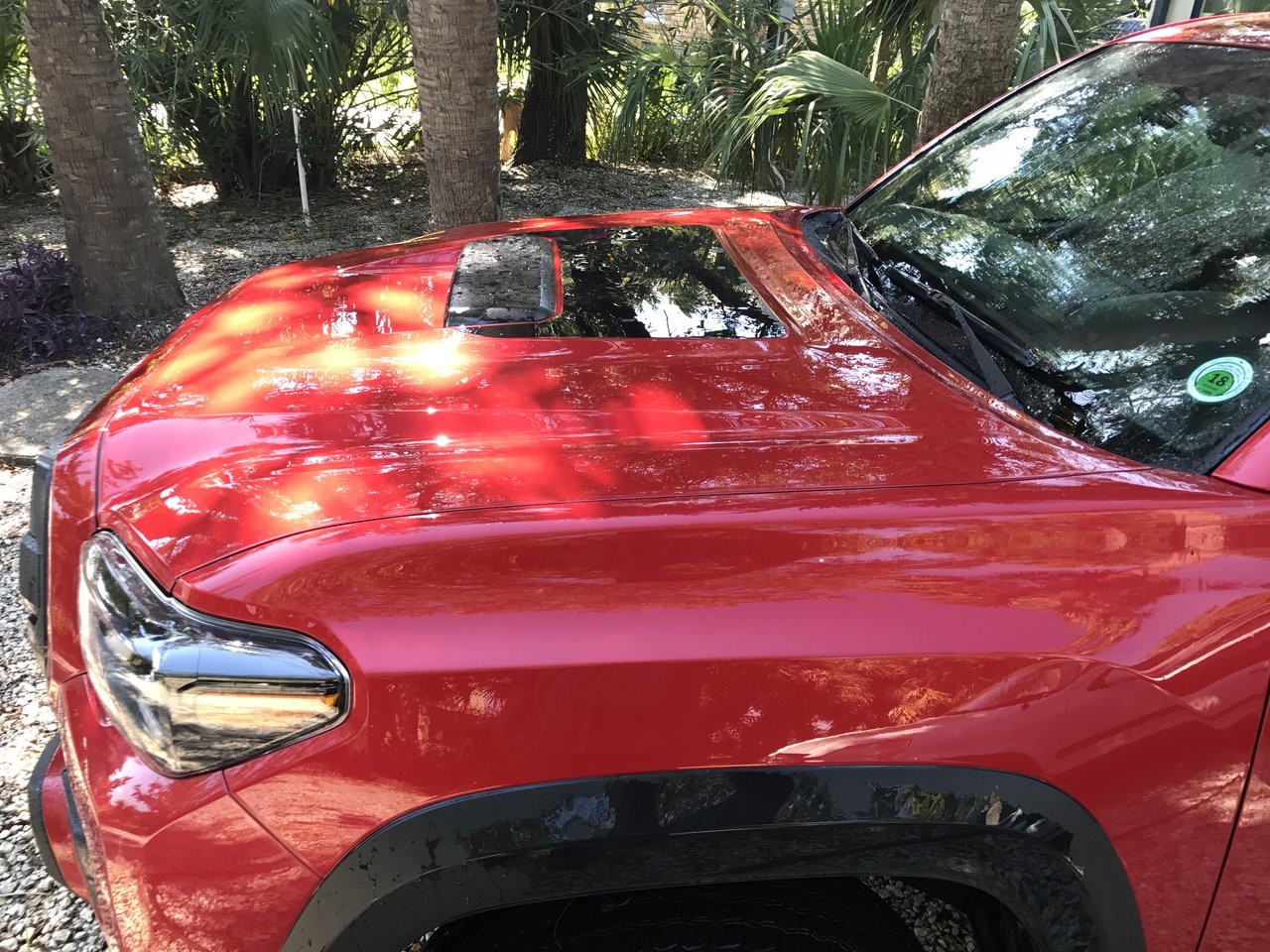

    Attached are beading pictures before wash and after, light was flat in early evening when I finished. I am using a 3 bucket system, Griots wash, microfiber mitt
    initial rinse prior to wash. Some beading , water was sheeting off on the horizontal surfaces, while the vertical showing good results. The vinyl and plastic treated with Wolfgang exterior trim sealant
    Roof- has been cleaned once with Mequires rinseless wash, next to no beading, water sheets off when sprayed
    After wash and rinsed, beading has returned to normal as when first treated. when rained on the beads are much smaller and tighter.
    Dried with microfiber towel, gloss is back to a brilliant reflective property. Bug guts come off with very little effort

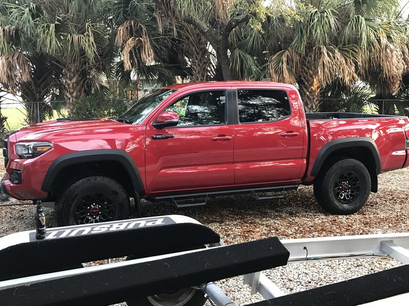

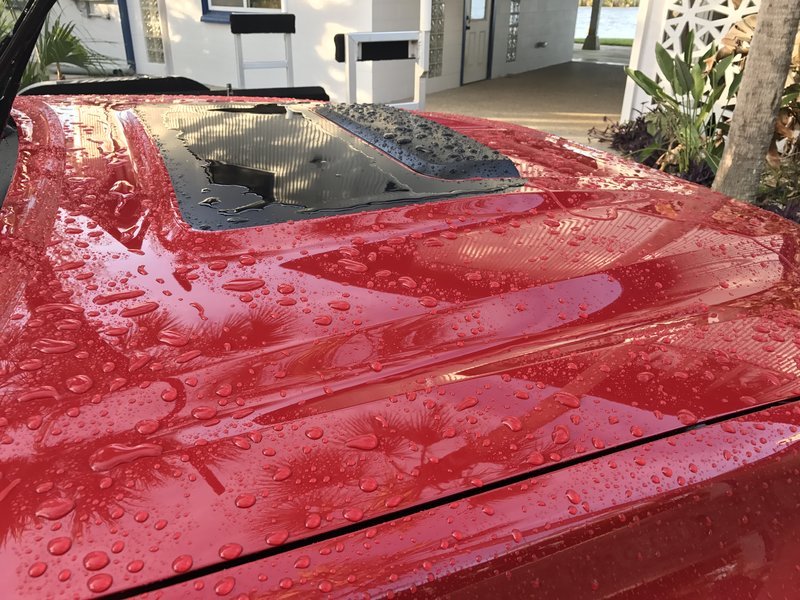

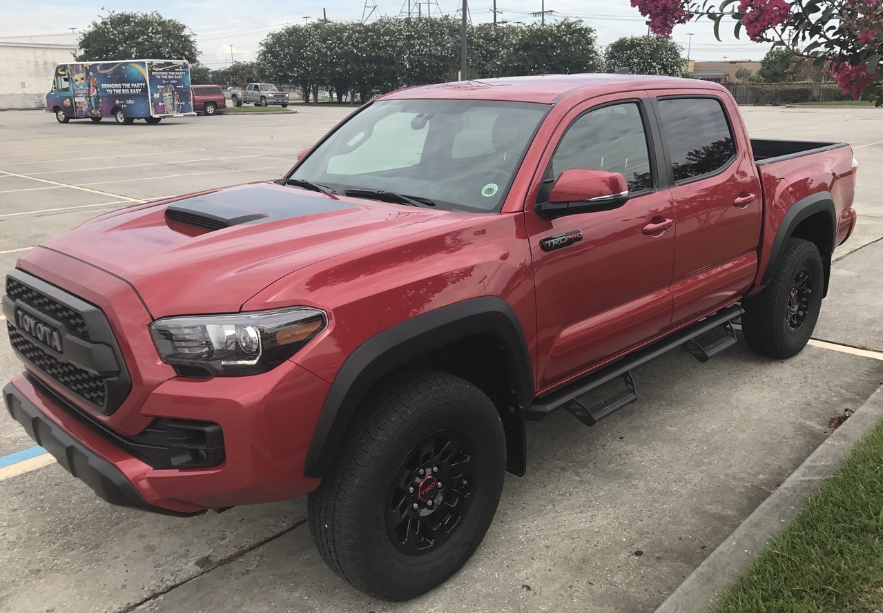

    4 month update finally :)
    During the last 3 months I have hand washed (3 bucket system) once and yes committed the ultimate washing sin 4 times through automated car washes
    Washed as my normal yesterday after salt spray from TS Cindy came through last week. Combined with everyday dirt buildup
    Good shine still just dusty and basic dirt
    I did a basic rinse to knock off the dust and grime and to see how if any the water beading was. You can see the paint essentially had no beading. I am very impressed with how the Wolfgang Ext Trum sealant has been holding up
    Using a cheap Walmart foamer and griots soap I covered the vehicle and rinsed. Proceeded to 3 bucket wash the truck. Some of the water sheeting and beading on the finished returned. I definitely could tell that there is a coating on the paint. In multiple areas I had to harshly rub the finish to remove some water spotting. The finish did not scratch. I was using a waffle weave microfiber drying towels
    Last step after a good dry i reapplied the "high gloss" spray and wiped off. I let this dry overnight before spraying with water before I went off to work. This brought the beading back. I think this step of the system is designed to be "sacrificial" in order to keep the actual coating's integrity
    Of course the full body glamour shot :) showing the glossiness and almost wet look
