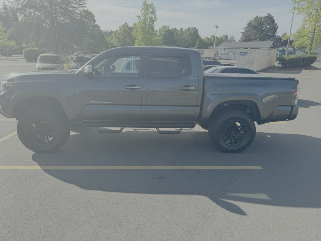

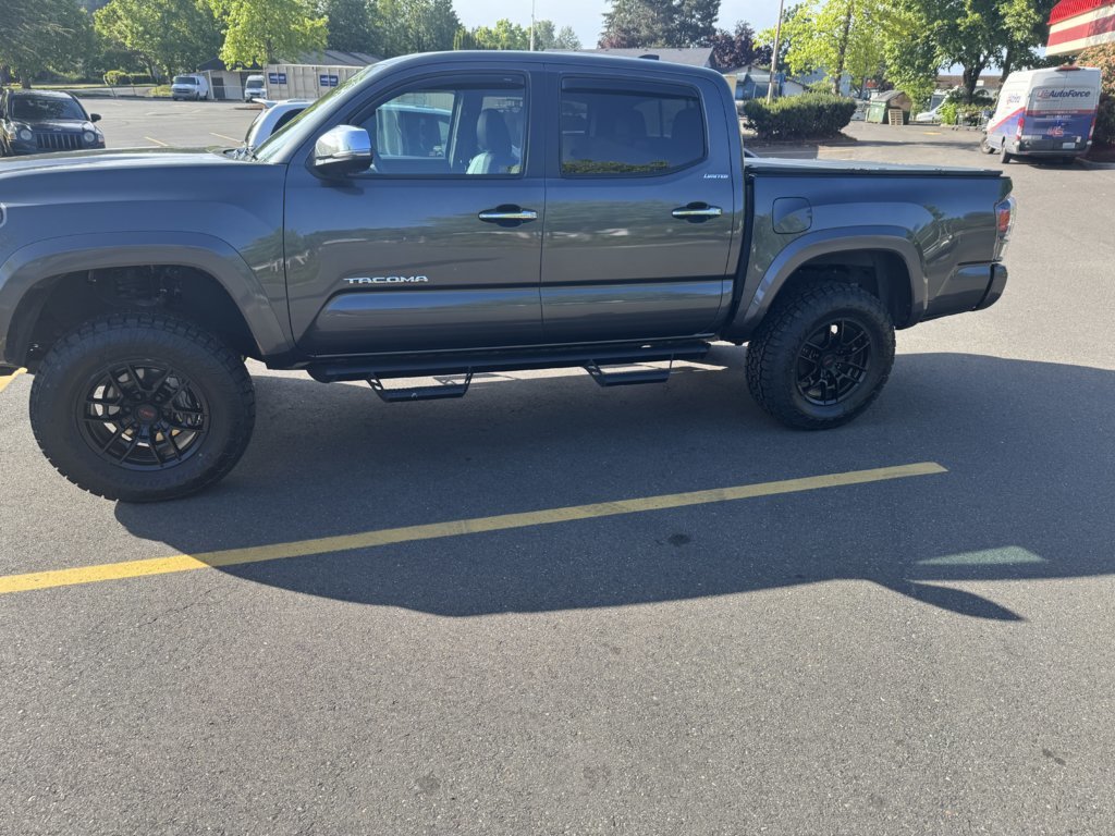

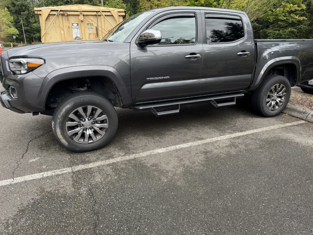

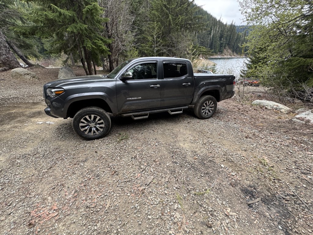

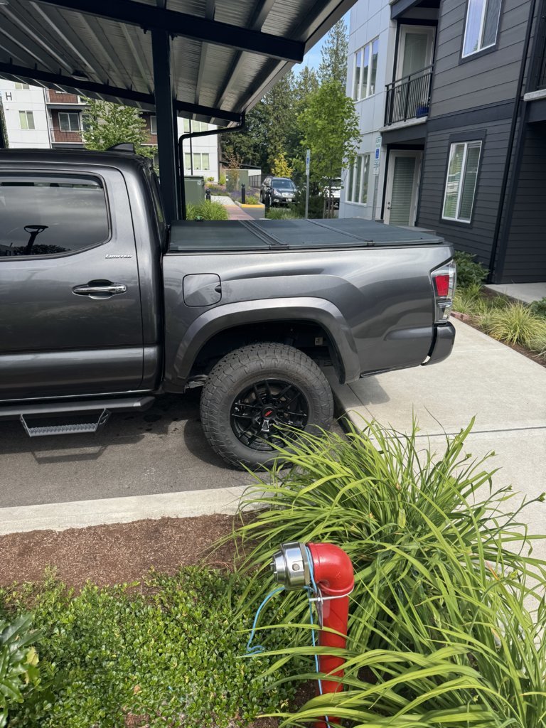

    When I purchased a 2020 Tacoma limited last year in April I noticed the previous owner had left a 3/2 leveling kit on the truck. While personally I mind the rake, I would like to keep the truck level.
    This is all to say that my Tires feel a little small for the lift and looks a bit awkward sometimes, I just got new wheels and tires due the stock being at the end of their lives. (Michelin Defenders 265/60/R18s to Toyo Open Country ATIII 265/70/R17s).
    I am looking for a lift to restore a bit of rake but bring the body down a little bit. I was thinking either Bilsteins 6112 and 8100s or Falcon Sport Tow/Haul Shocks with adjustments to the front with the clips and a Icon AAL in the rear to basically getting a real lift instead of the spacer lift in the photos.
    I was curious if anyone had this shock set up/ tire set up or had any advice going forward. possibly on a set of tires that will look better on the lift.
    Also sorry for photo heavy, Photos at top are old tires/wheels and bottom is new ones.

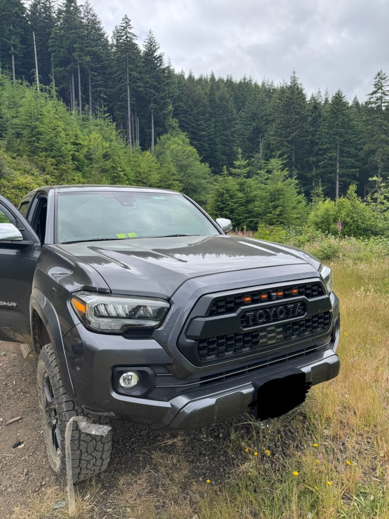

    This is a great post. Thank you for sharing. By the way you have a piece of tape hanging off your tire.
    Looks like you can use some wheel spacers. That and 285 tires. Replace the rear leafs with like a 110 Dobinson leaf pack. Replace your shocks with something worthwhile, like the Dobinson MRA, Dirt King (Elka), Falcon, Fox, Icon, any 2.5" aluminum adjustable coilover will do. And, remove the front spacers!

    Appreciate the reply, and thank you! the tape was from some DNR lands where there was a bunch of trash, went up there to camp and clean.
    275/285s are in the future don't worry. Does the Dobinson leaf pack add any height? I was thinking about replacing the 2inch blocks in the rear with a Icon add a leaf for 1.75" in the rear lift. definitely going to remove the spacers.

    Skip the 275s as they are heavy and not much of a selection. Go 285s!

    I like the look of 265/70-17s on these trucks…

    I like the look of tires. Far more aggressive, I just think they look a little small on the lift. Honestly 265/70-17s look fantastic on stock suspension but the previous owner blessed me /s with a leveling kit.

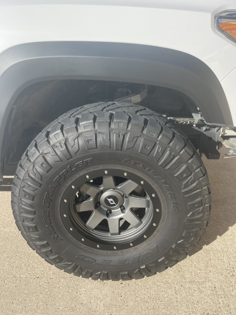

    I have the SCS 16x8” -12mm rims with Nitto 315x75r16 tires on my taco and I absolutely love it. It did require shaving off a portion of the front bumper to allow for full range of motion for off-roading though.
