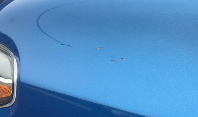

    Stop by the dealer or a used car lot and ask them to recommend a "lot gypsy" to do the job. They all have 2 or 3 on speed dial to fix paint chips, windshields, cigarette burns, etc. Those guys are usually the best at doing stuff like that for little $$.
    Until you get it repaired, hit it with a blue crayon to protect the metal and keep you from looking at it.

    The touch-up kits are great, *BUT*.. dabbing the color into the chip is only the first step. The way to make it pretty is:
    dab (do not brush) the paint into the chip. the paint should be raised higher than the factory paint around it.
    let dry.
    if the dried paint is still below the level of the factory paint, dab again and let dry.
    Once the applied paint is dry and higher than the factory paint around it, wet sand *very lightly* with 3000, 6000, 10000 grit until the paint is flush and smooth with the factory paint.
    apply wax onto the surrounding area, dry, and buff off.

    i'd do the whole panel on that or just touchup pen it until you get more patina on her.
    blending a spot job is tough on the newer paints.

    Thanks everyone for all the advice. I ended up deciding to have this one fixed professionally. The Toyota body shop is going to do it and I am finally going to use my insurance and have them cover it (minus a small deductible). Scheduled to go into the shop in 2 weeks to have it done. Feeling better about the whole thing now. ;-)

    Factor touchup paint in a tube, some patients, a bottle of Langka, a old T shirt and a credit card. Follow the instructions and you will be amazed how good it can look! My passenger side mirror got a chip the 2nd day I had my truck. I got the touchup paint, shook it up and took a couple days to dab it on, cut it down and repeat until I was happy with the results. The only person that knows it was chipped is me.
