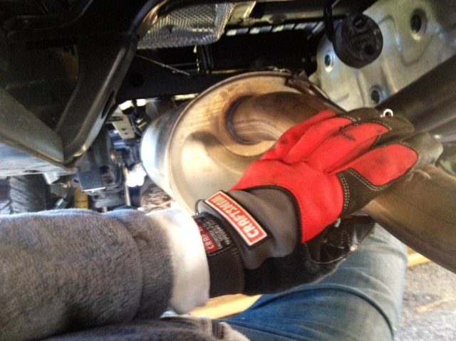

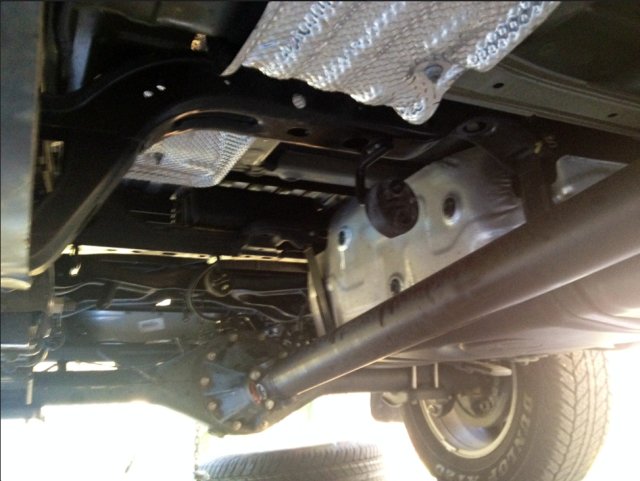

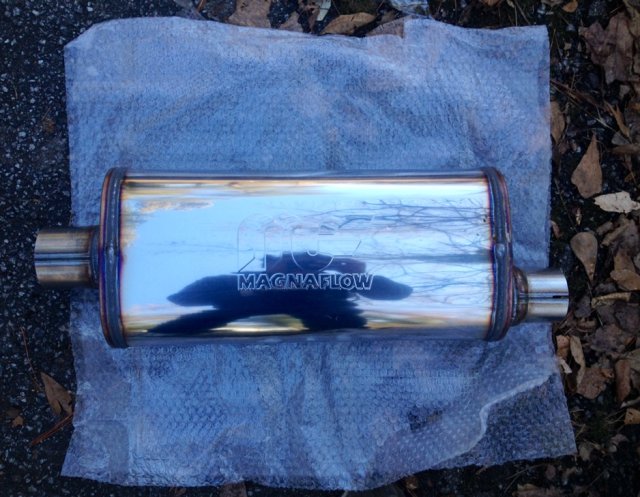

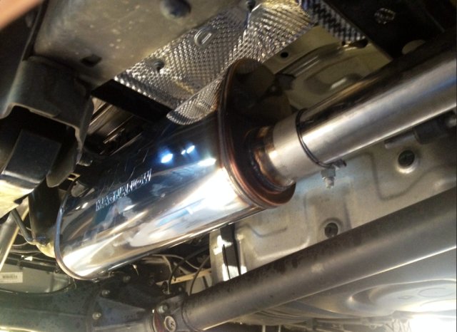

    Magnaflow installed. It was actually more easy than the Volant install. Here's how I did it:
    Removal:
    1) Spray all the rubber hangers with PB Blaster. Let 'em drip a bit & soak.
    2) Moved the truck to warm, sunny spot. Lay down tarp & some cardboard so as not to ding up anything during removal. (flat, dry surface, parking brake ON)
    3) Remove spare tire (you'll need the room when snaking the pipe)
    4) Grab 15mm socket, loosen spring bolts.
    5) slide under truck, parallel to stock exhaust, place legs on rear hangers, grab pipe and basically hump it until the hangers slip out of the rubber bits.
    6) Snake it all out towards the front of the truck.
    Installation:
    1) Connect new straight pipe.
    2) Hit all those rubber suckers with more PB Blaster.
    3) attach muffler, don't clamp down.
    4) attach rear piece (be sure to leave protective wrapping on tip until finished).
    5) Hit all the hangers with some lube and slip them into the rubber bits.
    6) Tighten everything up. Double check all the hangers. Put spare back on.
    7) Fire up truck, crawl under and feel for leaks. Turn off and make adjustments.
