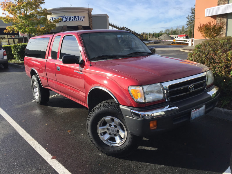

    After a long, long hunt, I finally found a decent Taco. They're hard to come by in the PNW in decent shape ... everyone seems to want one and I don't blame them, but it means that high-mileage Tacos are still super pricey. Still, I managed to find EXACTLY what I was looking for:
    It's a '98 base-trim V6 manual with a really nice Leer cap. 179k miles, well taken care of by the previous owner who was a firefighter. It has the split bench seat up front, so we'll see if that proves comfortable enough to keep. Needs a little deferred maintenance; it's due for a timing belt, has what looks like a small rear main seal leak, and needs front brakes. So a couple of weekends turning wrenches on it, which should be fun and not too pricey.
    This is primarily going to be a camping/exploration rig, not a daily driver, so in the future I'm hoping to do a mild build on it. The previous owner put brand new OEM style shocks and Falken High Country A/Ts (which seem like ok, but not great, tires) on it, so I'll probably leave 'em on for a couple seasons since they ain't broke. I'd like to add a rear locker, either an e-locker retrofit or an ARB air locker. Perhaps a stouter skid plate and some sliders. Eventually I'd love a bumper/winch combo, some KO2s on steelies in a slightly taller size, and maybe OME suspension for a very mild lift.
    Until then I'll just be base-lining the rig, getting it current on maintenance and seeing what it's capable of stock.
