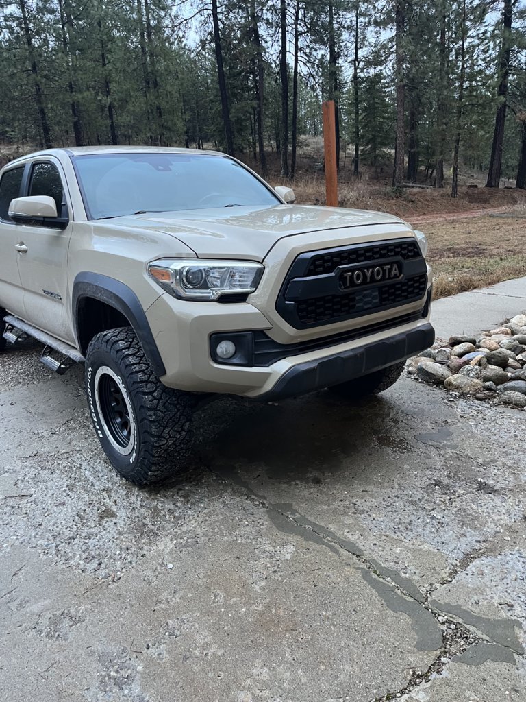

    I mostly just want good quality parts that are going to last and be comfortable, all while adding great aesthetics to the truck. Would old man emu leaf's be a better option? Or maybe just an AAL? Essentially I want 1" lift in the rear but I want to be able to throw an elk in the bed and know there's nothing to worry about.
    This is the current 305 wheel and tire set up. (I have the SR5 Trail Grille just Not Installed Yet)

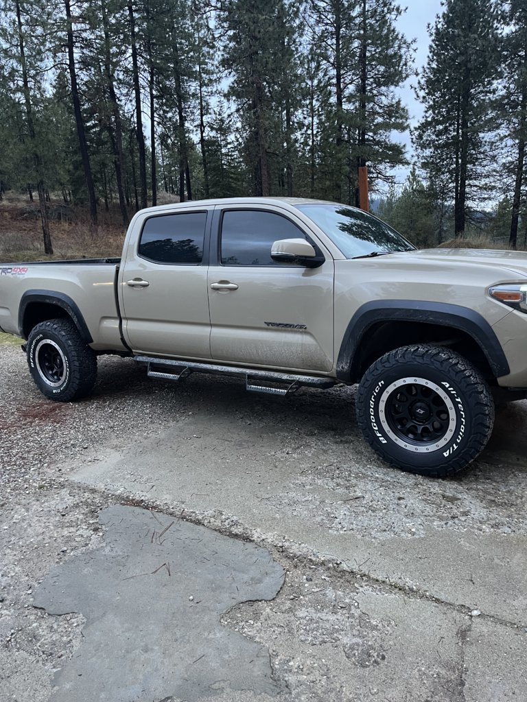

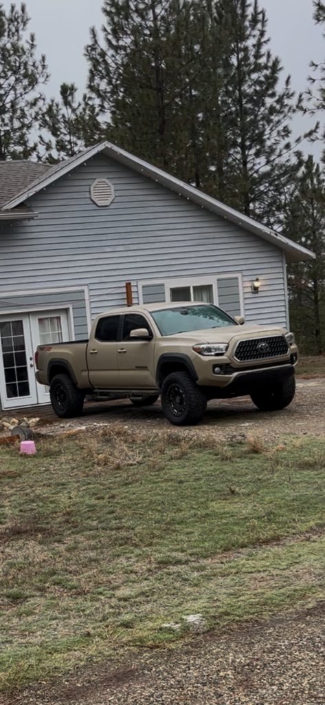

    New wheel and tire set up. Still waiting on the suspension to come in. I think I will just pull the blocks and go back to stock height in the rear and just level the front with the 5100's. maybe do an AAL or old man emu leaf pack in the future idk yet.
