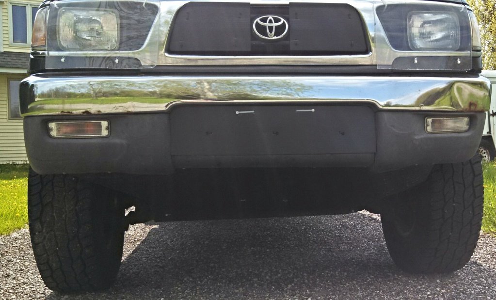

    Grill Block, Front Belly Pan, 3 inch lift shims in front, AAL rear suspension lift, Ultragauge Instrumentation, Flush Topper, Full Synthetic Fluids
    Project MPG Work Tacoma
    Truck: 1997 Toyota Tacoma 3.4L V6 4x4 DLX with 3.53 gears
    Goals: 32+mpg (100% over EPA) year round and maintain towing/hauling capability.
    Current Mods:
    - UltraGauge (0-10mpg in the way it aids my driving technique)
    - 245/75/16 Tires at 55PSI (1mpg over 40PSI)
    - Front Grill Block (1mpg)
    - Air Dam (2-3mpg)
    - Removed Wipers (have them in the cab for rain) (.5mpg)
    - Folded Side Mirrors (.5mpg)
    - Flush Fiberglass Cap (2mpg)
    - Synthetic Motor Oil (0w30 Mobil1 High Mileage) (.3mpg)
    - Differential Fluid: Amsoil Severe Gear Synthetic Extreme Pressure Gear Lube 75W-90 (1-2mpg)
    - Removed Spare Tire (70lbs) (.2mpg)
    - Full Coroplast Under Panels (2-3mpg)
    - Mudflap Delete (.3mpg)
    - Radiator Clutch Fan Delete (1-2mpg)
    - Power Steering Belt Removal (1mpg)
    - 3 Inch Spacers + Add A Leaf (minus 1-2mpg)
    - Side Skirts (.5mpg)
    - Rear Wheel Skirts (.5mpg)
    Total Completed= 12.8-26.8 mpg over EPA 16mpg

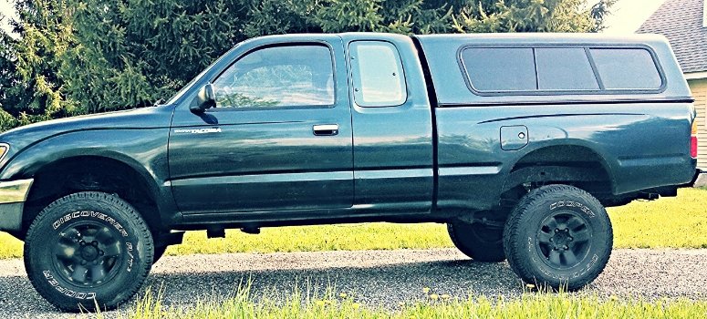

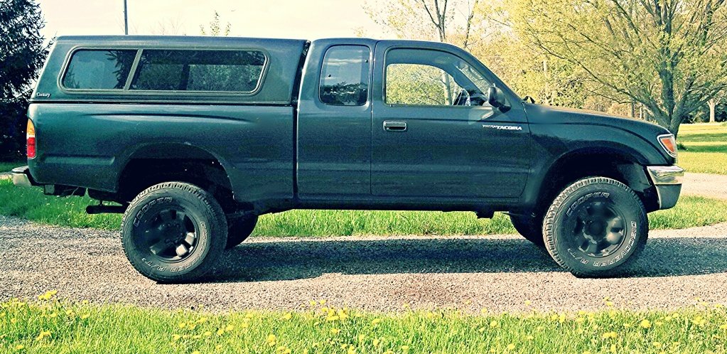

    I need a new pic as I already put a new Add a leaf helper spring in :) I might put longer headers on it and I'm also considering several mpg mods.
