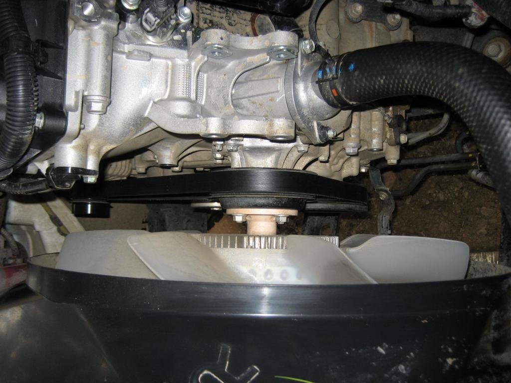

    I am only running 1 belt myself as well. Good work on the 25.5 mpg

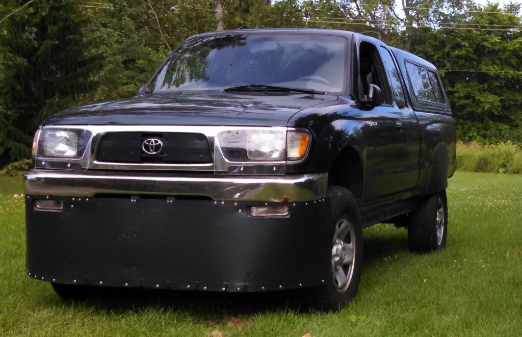

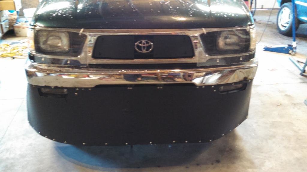

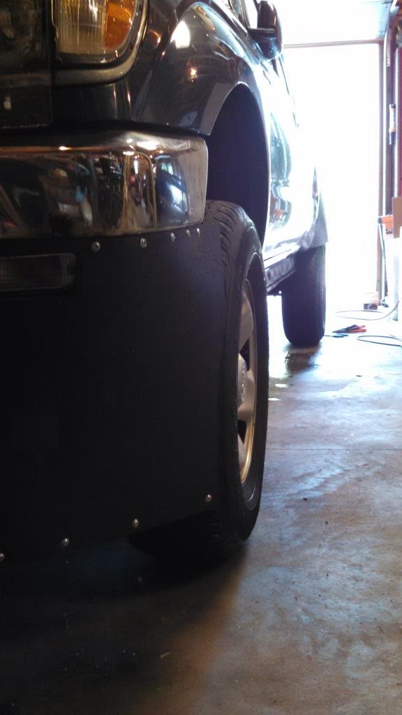

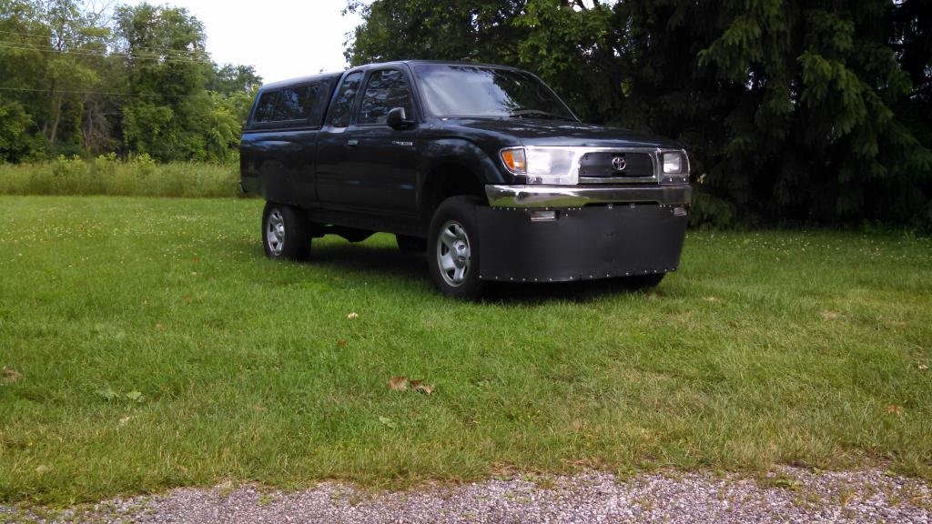

    Had to use my heater once during city traffic to nullify thermal runaway of the cooling system. Opened up more of the grill to compensate afterwards. Just finished Air Dam and changed rear differential fluid to Amsoil Severe Gear Synthetic Extreme Pressure Gear Lube 75W-90

    The air dam increases MPG? I would have figured it reduced it. Also must nullify the effect of the belly panel, right?

    The Air Dam keeps air from going under the car keeping more of our low pressure area on the sides and top where we want it. The Belly Panel effect may be decreased slightly but this is only because less air is moving under the truck, which is what we want.

    Okay, I see. But doesn't the dam create more drag and make a larger object to push through the air? Yes that's what I was talking about but I should have clarified that while I think it makes the underbelly less effective, it would still be for a better overall effect.

    The air dam will raise the frontal area while lowering the drag coefficient. The effect will be a larger object moving through the air more smoothly.
