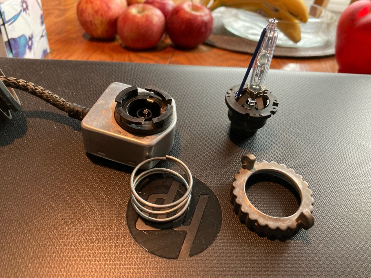

    BULB.jpg We have a 06 Tacoma with aftermarket projector-type headlights. We had a bulb go out. We were able to remove the bulb but we dont know how it comes apart or how to find a replacement. Can anybody help us out?

    Is that knurled piece a nut? Try twisting it to unlock? The link he posted above looks like it might work.

    No. Its what locks the bulb into the housing. We dont know how to remove the bulb from the silver thing, if it comes out at all. I assume thats some kind of transformer. The name on the light housing is Febergtco5.0

    I looked up that style bulb. *If* it's the same, it has two small pins that catch the housing. Looks like a 1/8 or 1/4 turn to pop it free. Might be kinda tight. At least that's been my experience...mayhaps to maintain a good tight connection.
    EDIT: If it were me, I would try a pair of Channellocks on the metal ring around it. A firm counter clockwise nudge may free it up.

    Also, do you have a pin wrench for an angle grinder? You could adjust the pins to fit the indents on the bulb base. Then turn to release it

    Ok. So the black base twists out? I thought that. Its my sons truck and hes afraid to break it.

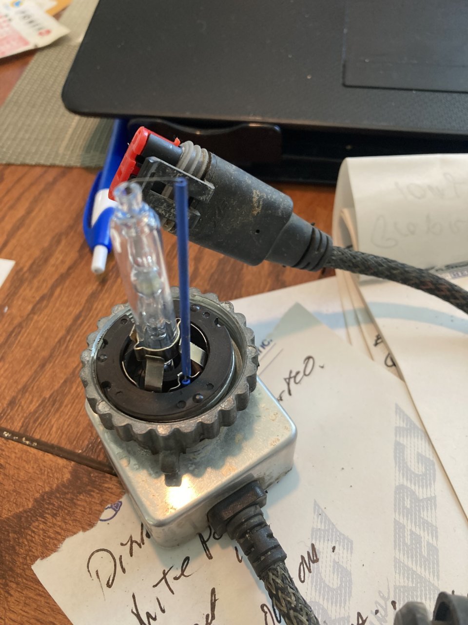

    Ok guys. Got it. Has anybody seen anything like this before? I used a small pair of channel locks on the base of the bulb and a slight twist. I didnt expect it to be spring-loaded. Thanks, everyone for your interest and ideas. I'm an old Chevy and a Jeep guy by the way. The headlights on my 04 WJ are in no way this engineered. Impressive.Bulb Parts.jpg .
